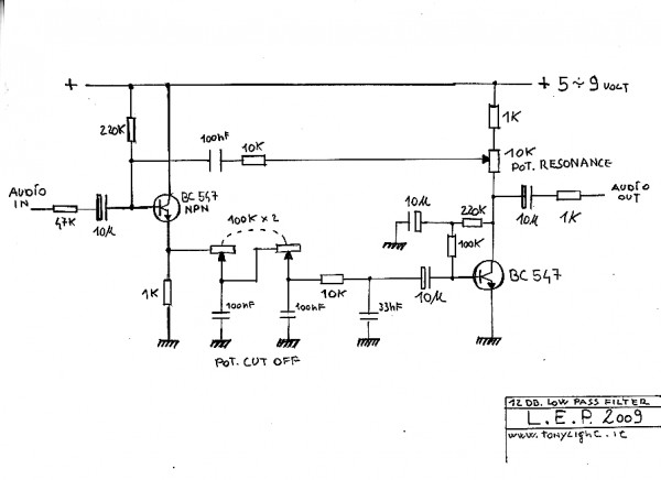

SUPER SIMPLE 12db RESONANT LOWPASS FILTER shared by tokyomatik on this thread http://electro-music.com/forum/topic-51780.html ,along with pcb layout ,from the notes on the thread by tokyomatik :
recently im abusing of this incredible filter designed by a friend of mine
is really interesting for his interaction between resonance and frequency
and the sound has his own character
can run on different voltages from 9v to 12v,
at 12v can really scream!!!
no cv controll but in combination with the sn voice module could fit without problems behind the same panel for example
