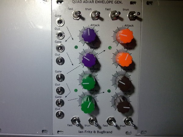

| I'm building a quad of these using the dual Bugbrand layout. Stuffed the boards but haven't tested them yet. I was wondering about these caps as well, used 3u3 filmcaps. If it works with electrolytics it'll work with flmcaps. I think the envelope generators are unipolar so electrolytics should be ok, i put in film just to be shure. |

| furio wrote: | My pots are 100KA and 500KA.
I have some difficulty to choose the cap values
With the first attempt I used C1 4u7 and C1x 470nF and now C1 1uF and C1x 1nF. But I think there is no end, the envelope is still running non-stop! Should I have used polarized caps for both? |
First, C1 is for the shorter times and C1+C1x is for the longer times. So you would want C1x to be larger than C1.
What exactly do you mean by running nonstop?
Ian |

Hi to all!
I have solved the problem, it was the MFB MIDI_2_CV or the Doepfer A-140 ADSR connected on the same Gate BUS. For some strange reason it crashed the gate on this interface
With the A-190-3 USB_2_CV 5V Gate or the MIDIMPLAT 15V Gate by Roman Sowa using C1 470n and C1x 4u7 timing caps works fine for me.
The only problem is a too high CV ground sound with my VCA's using the fastest Attack/Decay. Which is the better way to reduce this glitch/click produced by the envelope output to control a VCA_CV? |
furio
Joined: Dec 25, 2009 Posts: 124 Location: Austria
Posted: Thu Dec 15, 2011 10:59 am Post subject:
I would like to apologize to Mr. Fritz be it that I have made a modification that is without any style! I have only followed my own intuition.. and this is the result thereof... seeing that my knowledge of the electronic world is rather limited! This is what I did.
I cut the trace between the potentiometers and C1 and then jumped with a 8K2 resistor. If I should need to modify another envelope, I'll try some lower values.
Now I have one of the four envelopes which I assembled and found it to be compatible to control all my VCA's.
If someone could help, I attached the drawings for the euro modification to the PCB and my euro panel. I have used Musikding's 5x10cm PCB's, 16 HE/TE (8cm) Euro Panel and Lazertran.

| furio wrote: | | I cut the trace between the potentiometers and C1 and then jumped with a 8K2 resistor. |
That's a good idea. The Bridechamber version has 1k resistors in series with each pot. The Elby version has 270R in series with the A pot and 1k in series with the D pot. Using a larger value makes sense for your version with the switched cap.
