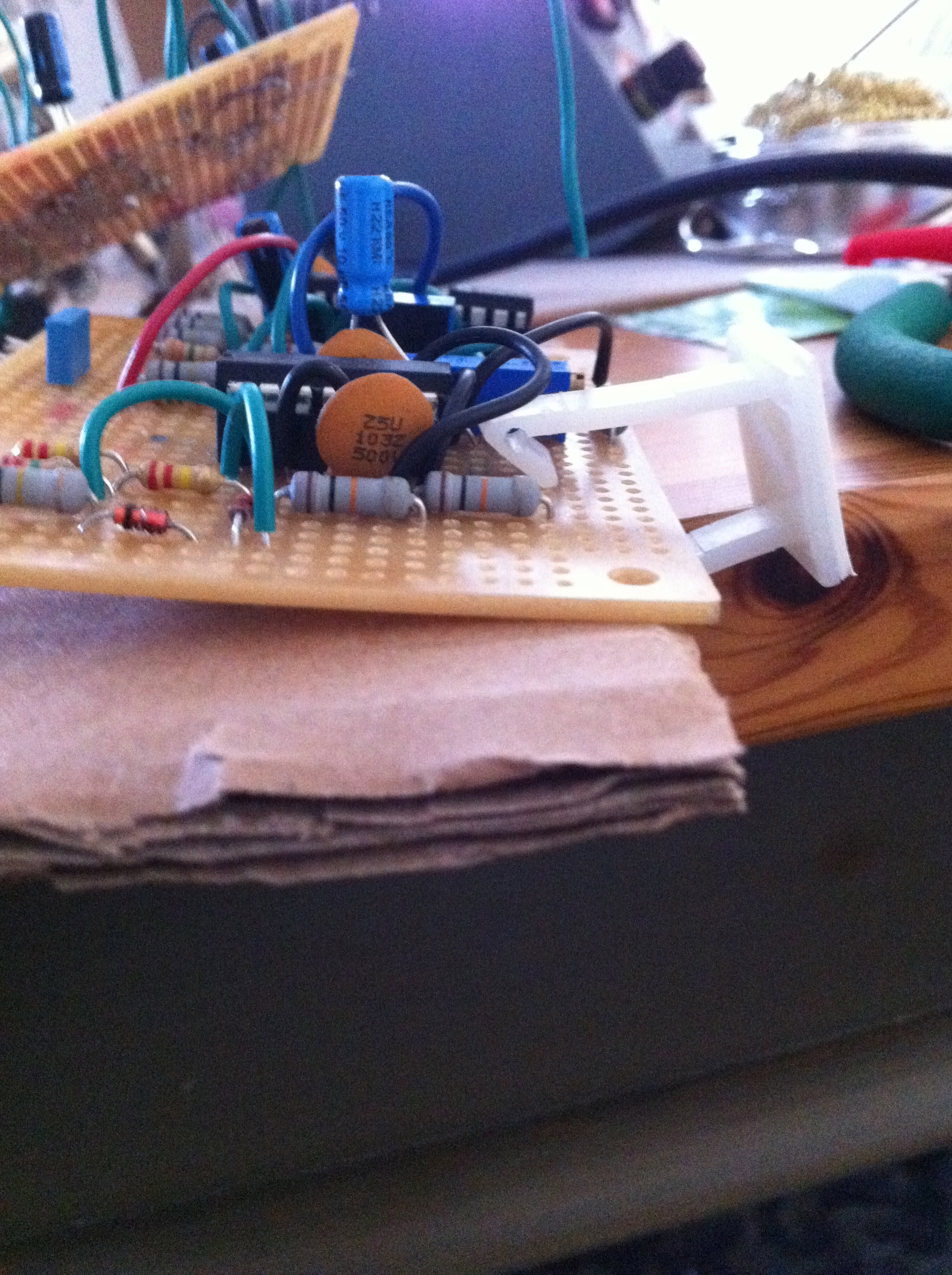

you can break it off pretty clean with a pair of needle nose pliers

chieffrancis wrote:

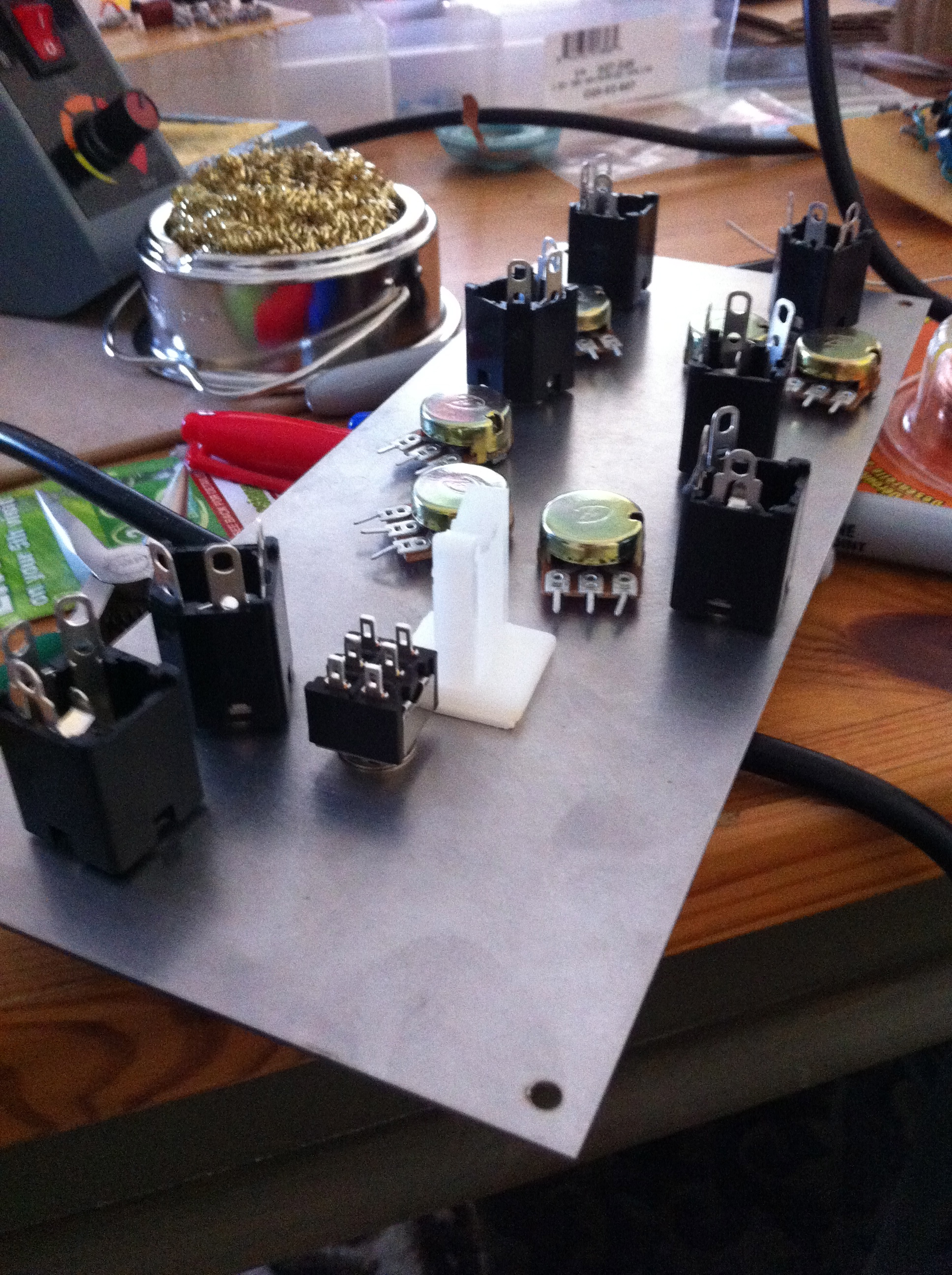

There's this little protrusion at the edge of my potentiometers that is preventing me from mounting it flat onto the panel..
Does anyone know what this protrusion's purpose is or how to prevent it from affecting the positioning?
That little protrusion is meant to go in a smaller hole in the front panel, and is meant to help keep the pot from rotating and lossening up the mount nuts. They are very rarely used from what I've seen, and generally can be broken off as suggested above.
Tim (I hate it when my nuts get loose) Servo

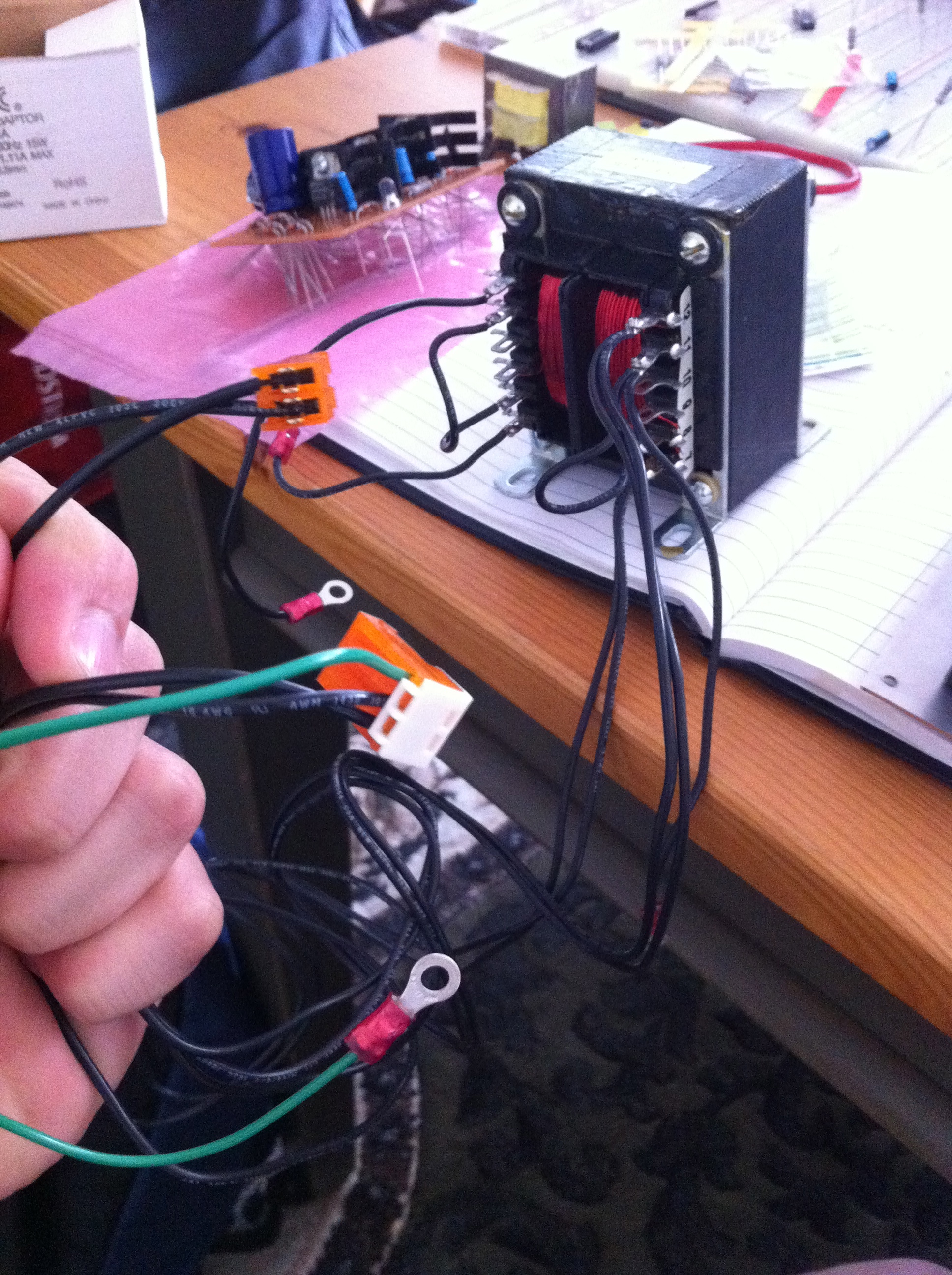

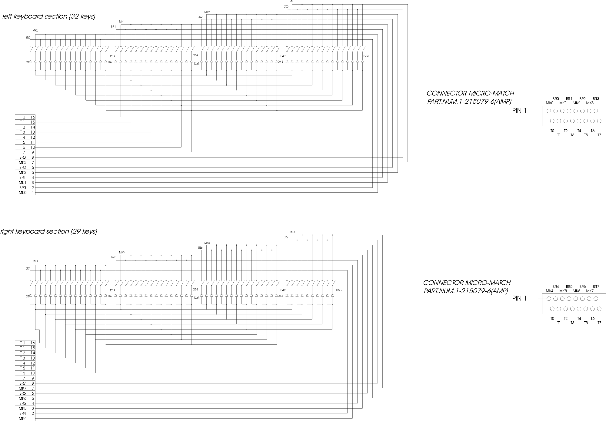

Also, I just want to know what exactly is going on with the molex connectors on my 36vct.
I understand that the left side is in series and correlates find with Thomas' schematic and the center tap that goes to ground is pin 11 (and Cool.
Pins 12 and 7 are being connected in parallel to the molex (not even sure if it is molex honestly, I just throw that word around now haha) with one having a ground.
Would it be safe to assume I could just clip these and use pins 7 and 12 exclusively to connect to the rectifier diodes?
Also, does it matter which end of the transformer I use for the 9V transformer? I'm assuming no but I could be wrong!
*On a side note, does anyone know how I would connect the 14 row pins to the 8 row input pins of the IKC? The Ray's schematic only has 5 row pins..
Thank you!

PostPosted: Thu May 09, 2013 5:46 pm    Post subject: Reply with quote  Mark this post and the followings unread
Break it off with a pair of stout pliers. The metal is soft.
I believe it's meant to be slotted in a hole to stop the pot from rotating, however, I've never seen a synth panel made to accomodate that kind of use. The general advice is break it off.
Edit: That's what I get for not paying attention to the fact that there's another page with responses already :/

Transformers I try not to talk too much about because AC can be deadly and I don't know much.

Francis:

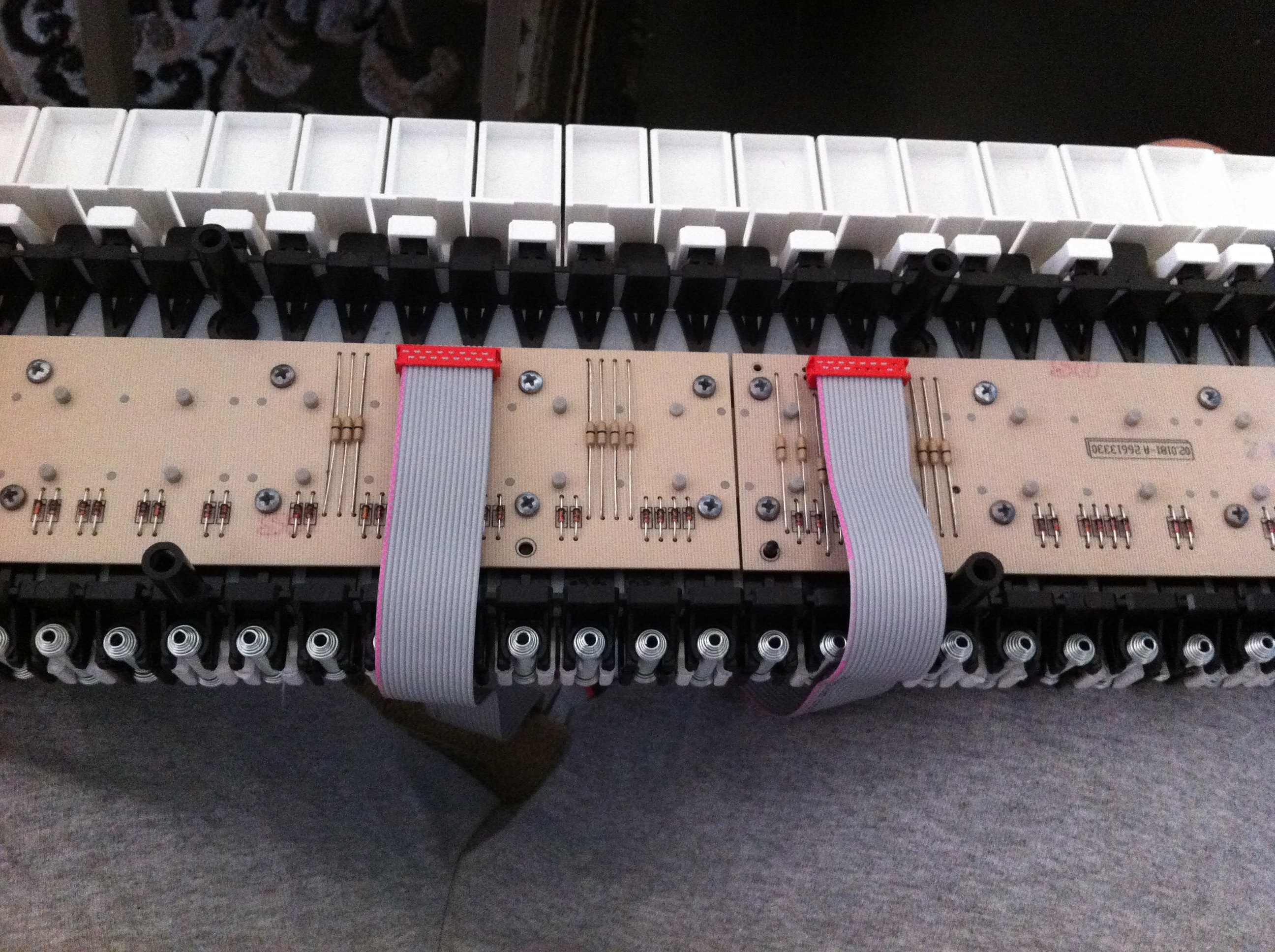

The schematic that you posted, is that the keyboard that you are going to use in this application? If so, I can let you know exactly how to hook it up to the IKC. Worst case is you may have to reverse all the diodes on the keyboard, then will be perfectly usable with having to spring for the Fatar keyboard. It looks like little work for big savings.
Bill

State Machine wrote:
Francis:
Bill

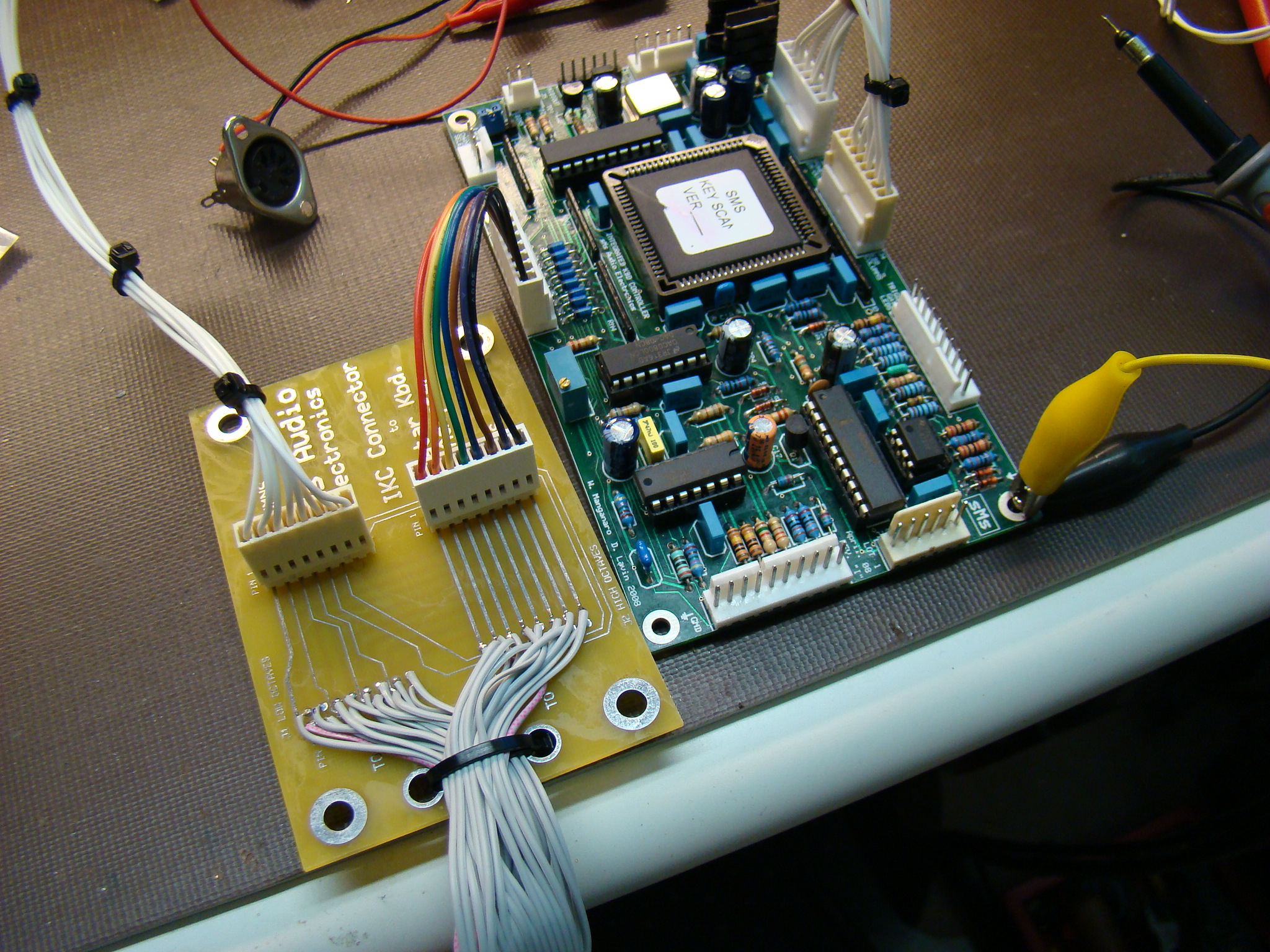

That isn't the keyboard I'm using, only a schematic someone used to reference me. The keyboard I'm using is the one I posted pictures of on the previous page.
It seems to have 8 column pins that are connected to the anodes of the diodes in the keyboard but the row pins seem to be connected to 14 pins.
I believe I can connect the 8 column pins directly to the molex column inputs on the IKC but the rows pins are where I'm stumped as it has 14 rather than the 8 pins available on the IKC.
The schematic I was referred to only has 5 row pins, although it is only for a 37 key whereas mine is a 49 key.
Posts: 2810
PostPosted: Thu May 09, 2013 8:59 pm    Post subject: Reply with quote  Mark this post and the followings unread
Ok I took a close look and if this is indeed the schematic of your keyboard, all you need to do to get it to interface to the IKC is to swap rows with columns. The signals labels C0 to C7 on you schematic are the lines that get driven which are the Rows outputs On the IKC.
IKC. R0 R1 R2 R3 R4 R5 R6 R7
MFOS C0 C1 C2 C3 C4 C5 C6 C7
IKC. C0 C1 C2 C3 C4
MFOS. R0 R1 R2 R3 R4
Posts: 2810
PostPosted: Thu May 09, 2013 9:01 pm    Post subject: Reply with quote  Mark this post and the followings unread
Ok , then try the swap I explained in my previous post of it does not work. In fact of the COL pins are connected to diode anodes, then you definitely need to swap rows with columns. As stated, my ROW pins drive the matrix, not the columns
The last part of the mustery -- I will have to find out why there are 14 row pins.
Bill
Are you saying that the diode anodes should be connected to the row inputs on the IKC?
Posts: 2810
PostPosted: Fri May 10, 2013 5:50 am    Post subject: Reply with quote  Mark this post and the followings unread
I am saying that my ROW signals are actually OUTPUTS. Thus, they will drive the matrix. My IKC COL signals then do the reading. This, in turn, allows the IKC to generate its key code for analog conversion and MIDI NOTE number.
If you say the your keyboard COL signals are connected to diode anodes, connecting the COL inputs on the IKC will never work.
Clear as mud.

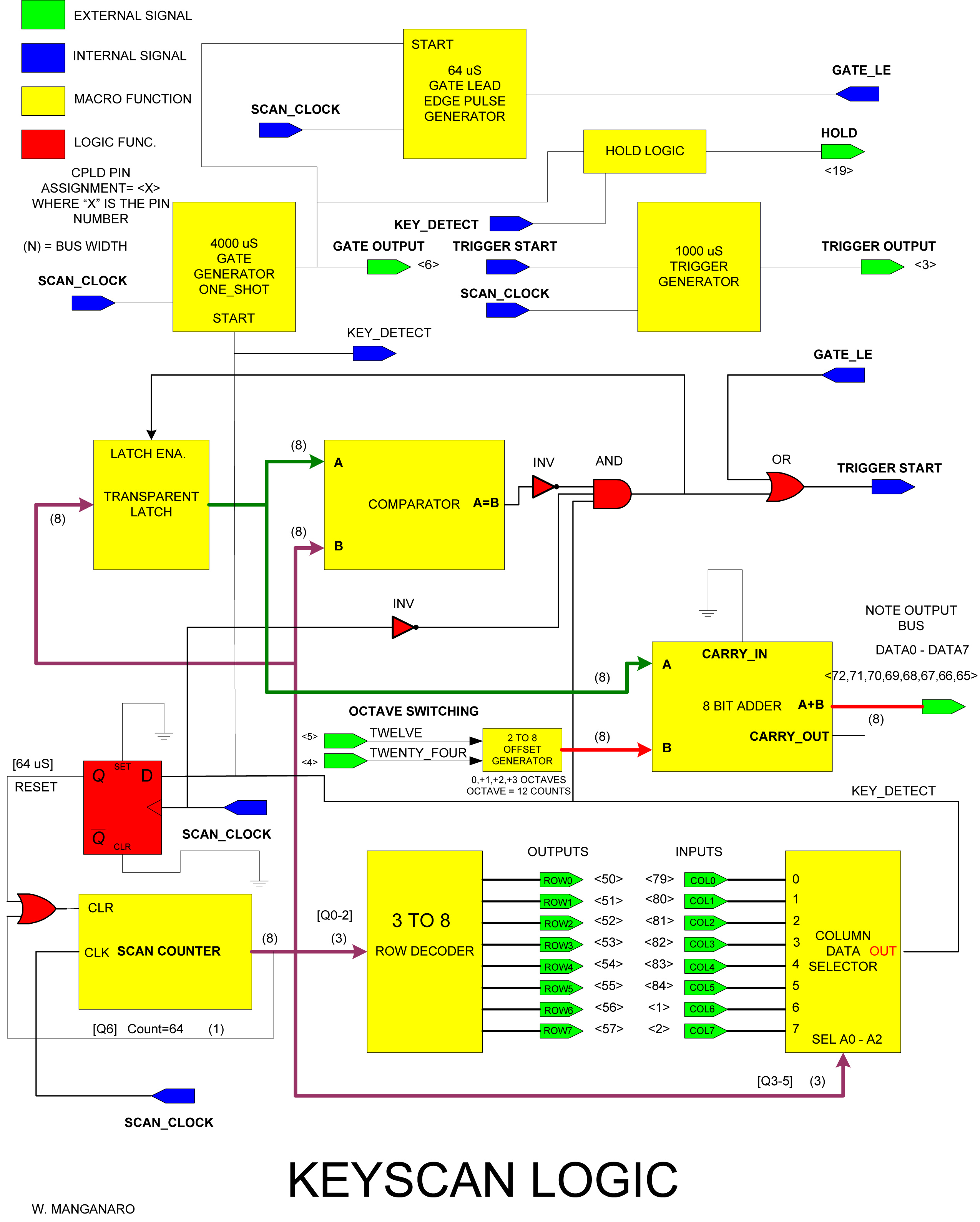

PostPosted: Fri May 10, 2013 7:21 am    Post subject: Reply with quote  Mark this post and the followings unread
Here is the functional block diagram of my IKC CPLD logic. This will clarify how the scanning logic derives a key code but more importantly, it shows my ROWS as outputs. The lower 3 bits of the scan counter are the row address, the next most significant 3 bits are the COL read address, together, all 6 bits form the key code. If the new key code sensed is different from the last one latched, the new key code is then latched on the DATA output lines. If the new key pressed is the same as the last key press, the DATA remains the same and no new key codes are latched.
This is very close to how Thomas Henry did his key scan logic years ago using discrete components, which of course was the best way to do it at the time. I just put it all in one XC95108 CPLD device. In retrospect, it would have been better to put it in a FPGA or an MCU for expandability and more MIDI functionality. It would have been lower power to.

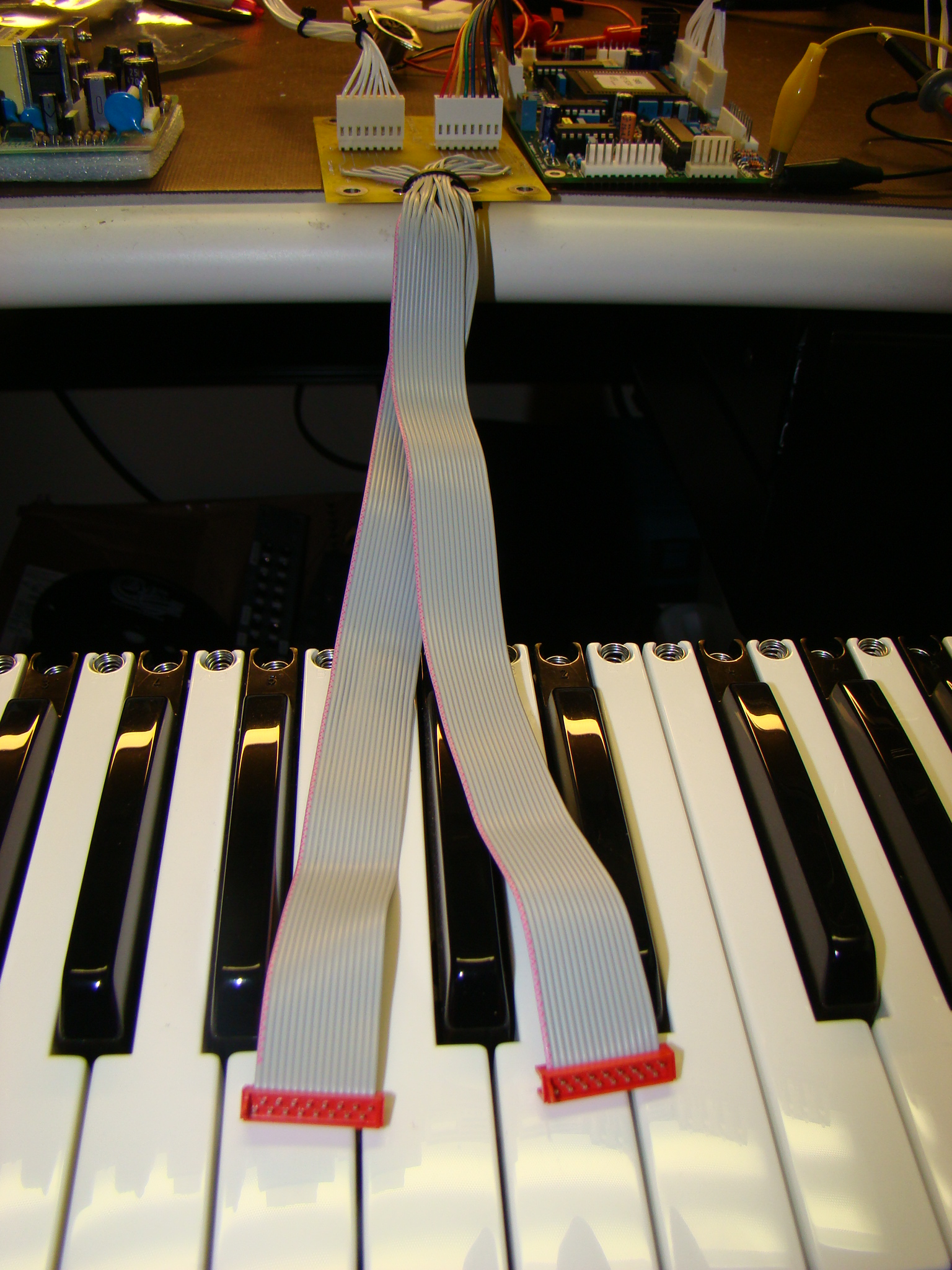

Posts: 2810
PostPosted: Sat May 11, 2013 8:30 am    Post subject: Reply with quote  Mark this post and the followings unread
Page 51 and 52 of the build manual enplanes exactly how to connect a 5 octave Fatar keyboard to the IKC. I have a breakout board that will make this really easy and between this and the instructions you should be good to go !!! PM your address and I will ship one out to you man ASAP. I have attached some pictures of what it looks like.
As you can see from the pictures, the ROW and COL connectors connect to the IKC, following my directions, one end of each of the two Fatar connectors are removed and soldered to the adapter board and then strain relieved with a wire tie.
Use the matrix schematic to understand the hookup and connector pin assignments and it will become very clear. The IKC ROWS drives the T0 thru T7 lines and the the IKC COL read the MK lines (make contact of the Fatar) .... do not use the BK lines (fatar break contact). The schematic in the manual shows these connections.
I think you should be set on this.
Bill

PostPosted: Sat May 11, 2013 6:08 pm    Post subject: Reply with quote  Mark this post and the followings unread
hey bill i had a question about the jumpers.
"Place a shorting jumper, Digikey PN S9001-ND, on J12 to allow the MIDI data to pass to the output. Place another jumper across COM and PD on J6 if using the MCC display board or driving the MIDI address inputs into J3 from a logic device or microcontroller. If using switches, then place a jumper across the COM and PU pin on J6 to provide a pull up voltage and ground reference for the switches. In some instances though, the pull down connection may be required depending on the type of switches you use such as thumbwheel types."
not sure what you mean by using switches. just need a little clarification on that.
also, the longer leads of the jumpers go to the board? i'm just confused by this because if i put the longer leads in first, the jumpers don't fit on the smaller leads on the component side of the pcb..

i had a question guys (i start way too many posts with this).
is it okay if i use cardboard underneath my perfboards (have cardboard in contact with the leads/solder/etc.) in order to physically stabilize them when i insert them into wire clips as so in the pictures?
also, when connecting multiple perfboards, should i have the wires coming up and over (since they will be vertically stacked) or should i just have them come up straight? i think straight would look much neater but i'm not sure if the leads coming out the top end of the perfboard is a safe thing to do..
thanks!

PostPosted: Sun May 12, 2013 4:51 am    Post subject: Reply with quote  Mark this post and the followings unread
Cardboard is non-conducting, so I don't see why it should be a problem on the bottom of the board. The only hazard I can think of is if it was in contact with things that would heat up. You should probably test your boards before you put them in contact with cardboard Smile.
Also not sure I understand what you mean by "up and over" versus "up straight".
Posts: 2810
PostPosted: Sun May 12, 2013 8:22 am    Post subject: Reply with quote  Mark this post and the followings unread
If you plan on using the MIDI function, the channel number that you communicate on needs to be entered via a 4 bit input code to the IKC. If you did not have a midi channel changer board, of which you do have one, then you would need to wire up 4 switches to enter the MIDI data. This can be DIP or discrete switches on a front panel. I personally think the midi changer board I sent you is much more elegant and has a very nice digital display showing the MIDI channel number.
I am not sure what you mean when you mention leads for jumpers. I am talking about header jumpers that are inserted on the PCB.
Hope this clears things a bit for you.
Bill

here's how i have it:
do i have the pink wire at pin 1 or pin 16 on the fatar?
