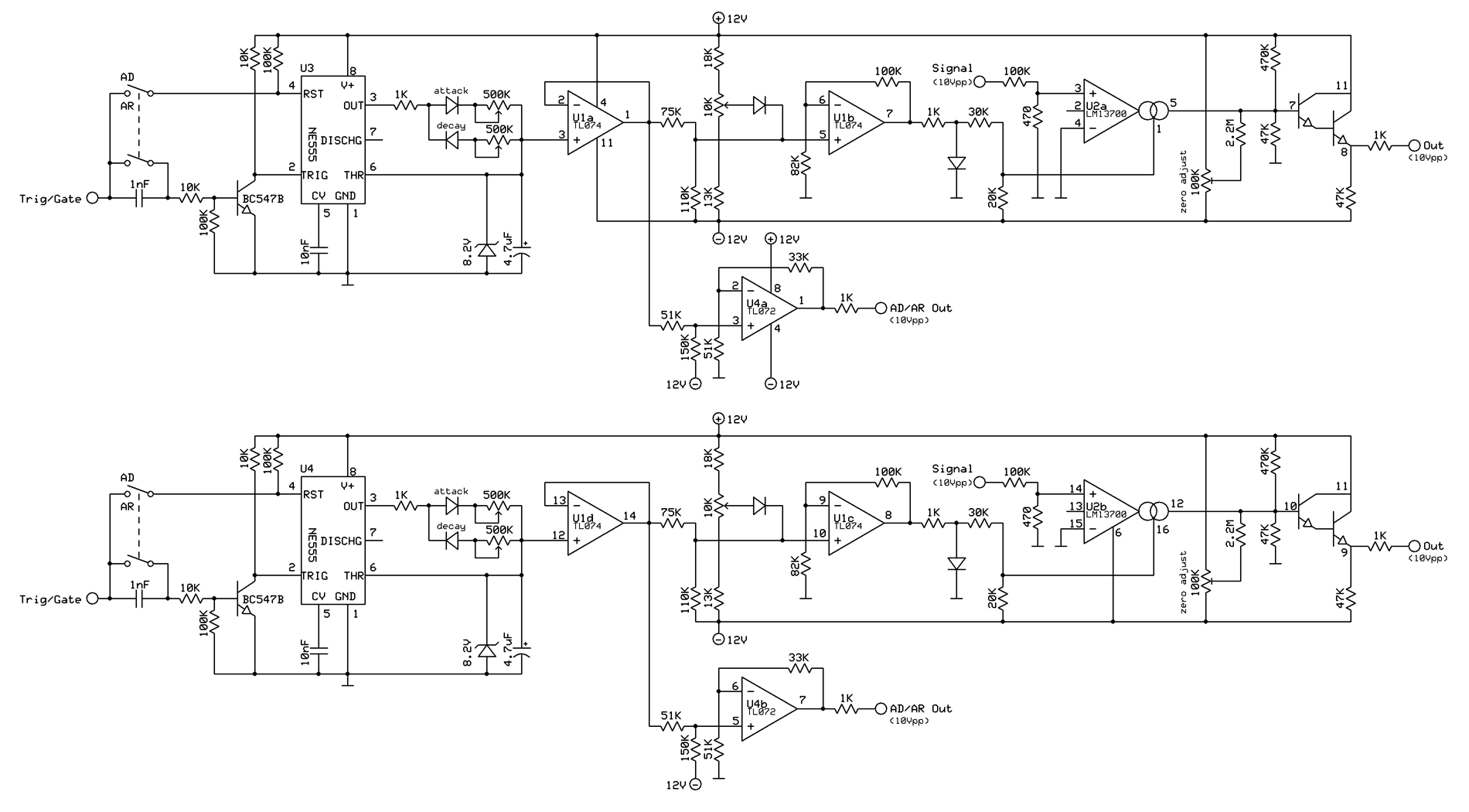

The next thing I added was 2 envelope generators and VCA's. I used the AD/AR design from the Lun-A-Key but with a transistor inverter and a capacitor
on the input to create trigger pulses from a gate signal. I also added a zenerdiode to limit the maximum charge voltage. In triggermode the voltage
will rise to 2/3 of the supply Voltage (8V using a 12V supply), and then discharge. In gate mode it would keep charging to almost 12V without the
zenerdiode, which limits the voltage to just above the treshold level. I didn't convert the voltage to -5V/+5V but only buffered it with a voltage
follower since it is connected directly to the VCA. However I might change this so I can use the AD/AR and VCA's seperately. Rolling Eyes
I also made 2 VCF's based on the EFM Wildcat VCF which I found in the schematics vault (thanks vladosh!).
I used larger filter capacitors, changed some other values and added the 4.7M resistors to the base of the darlington's to keep the level around 0V.
This also tempers the resonance a bit so it doesn't go too wild.
I did not add an external CV input for the VCA section but I did add an extra opamp to convert the output of the AD/AR to -5V..+5V. So here's
an updated schematic. (btw I'm using this calculator to get the right resistor values Wink)

AD/AR VCA combo with added CV output
 Filesize:  100.81 KB
 Viewed:  1075 Time(s)

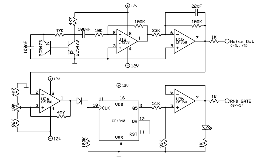

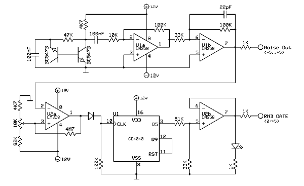

another thing I added is a noise source. The actually noise generator with the 2 transistors is something I found online (I think it's posted
somewhere on this forum aswell) and I added 2 opamps to boost the signal to -5V..+5V.
I've also started on the frontpanel design to get an idea about how much space I have and what I can put in. I had a free space for one jack
and a knob which I probably won't use for anything else, so I decided to transform the noise into a RND gate signal. A comparator with
adjustable treshold level turns the noise into a RND squarewave. This is divided with a CD4040 to get a useful range which is followed by
a voltage divider and buffer to turn it into a 0/5V gate signal.
Since I added the RND gate part later I used two dual opamps, but you could use a single quad opamp of course,. (LM324)*
* I did a quick test with an TL072 but the output level was higher, so some resistors would have to be adjusted when using that one.
Noise & RND gate
 Filesize:  35.95 KB
 Viewed:  1073 Time(s)

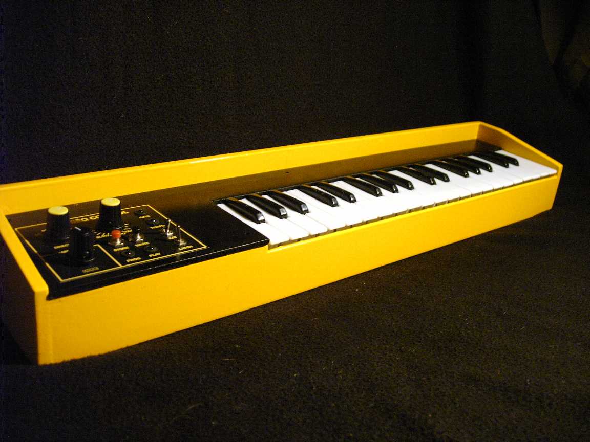

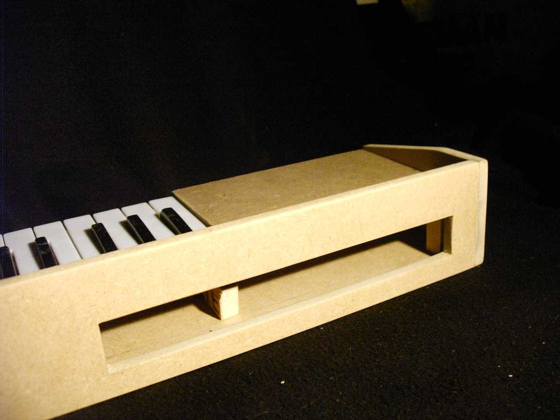

First sounds are posted here. Still need to make a mixer (but can't get pots untill a month from now), and the whole midi-PIC-keyboard control.
Will place the pic in a seperate housing with the keyboard which will slide out from underneath the synth. I will also put a midi out on it which I
could use to control the other keyboard (not gonna build them both in one case afterall)

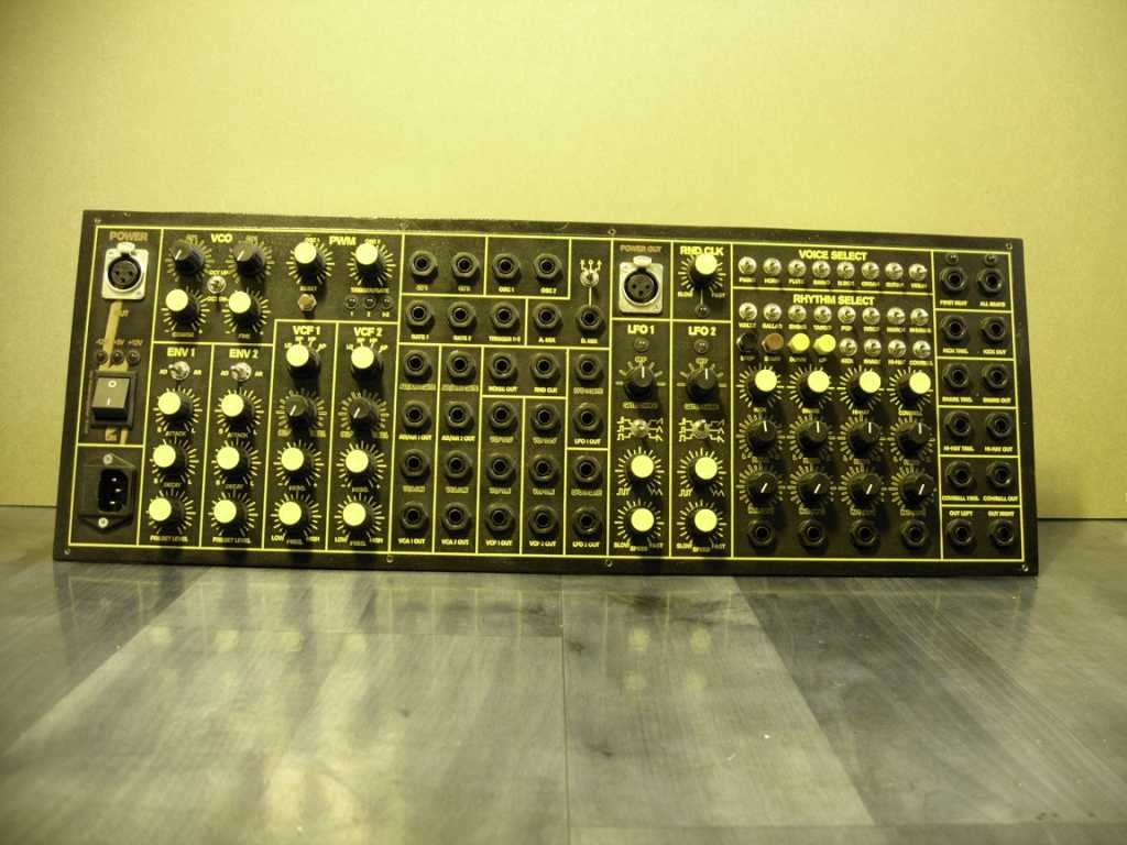

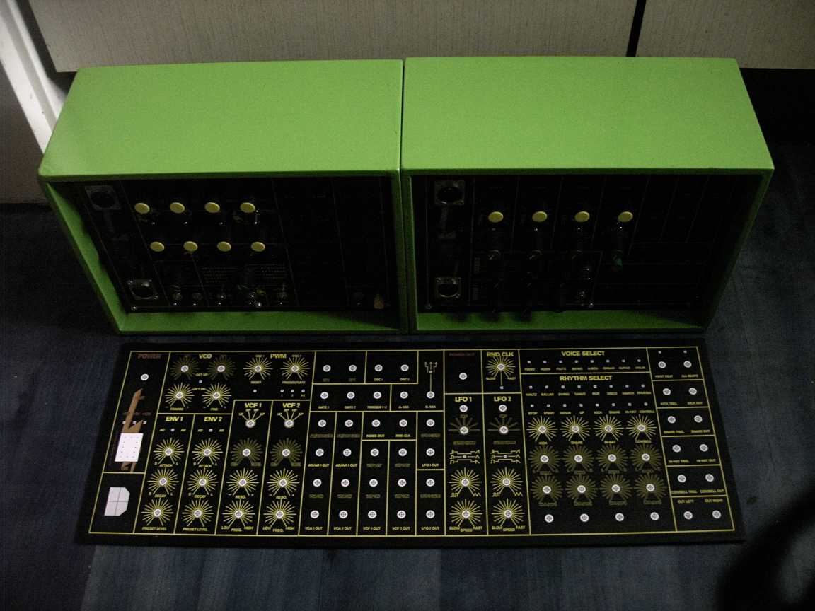

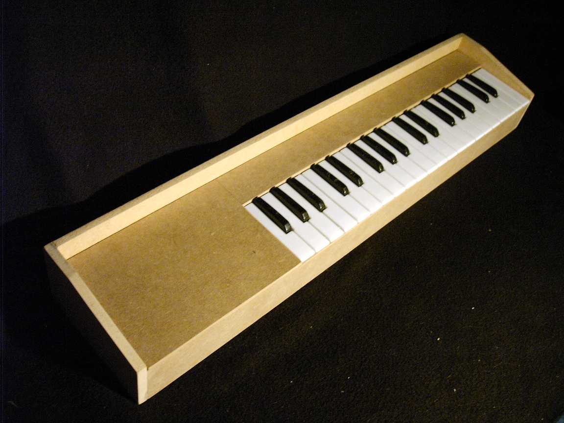

here's the frontpanel,.. (printed on 3 seperated pieces). As you can see in the photo is as wide as two of my other synths next to
eachother. The idea is to use this as a base with a build in PSU, since I still don't have a dedicated one for those synths.
EK210 synth frontpanel
 Filesize:  81.99 KB
 Viewed:  1044 Time(s)
Posts: 5971
PostPosted: Tue Jul 02, 2013 6:46 am    Post subject: progress Reply with quote  Mark this post and the followings unread
I finally got the pots so was able to wire the whole panel up. And it all worked instantly Laughing Well almost, I had the finetune pot hooked up
backwards Embarassed and it looks like you can't combine the rhythms afterall.
But I only did a very quick test, maybe it has to do with switching at the right time. Anyway I think it looks nice this way and I won't change it to pushbuttons.

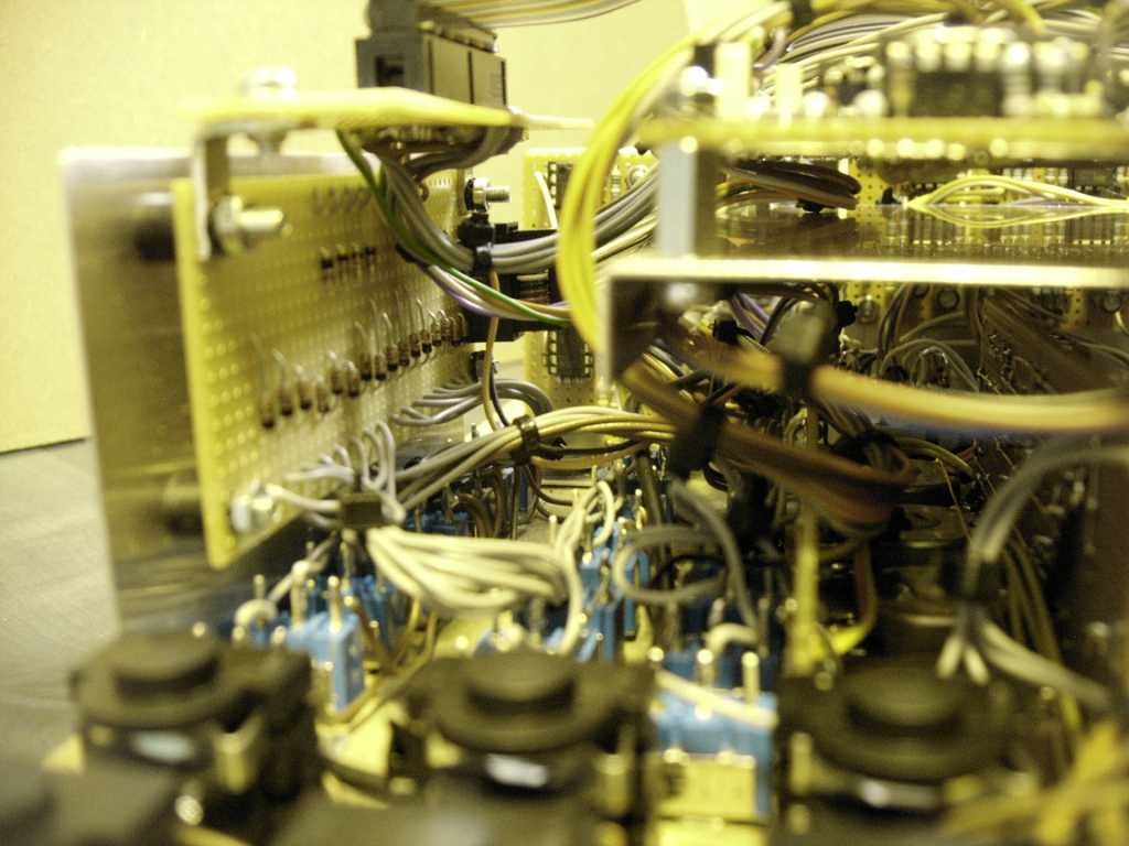

I added connectors to the keyboard PCB which is connected with 2 ribbon cables to the frontpanel. The chips are shiftregisters which are going to be
used to have a PIC control the keyboard. Which is the next part I have to do. I know it's going to have midi in and midi out, but I could do all kinds
of neat things (like arpeggios/seguences which can be generated random in any key). I'm thinking of making it in a seperate case connected with
one of those curly cords (I think I have an old computer keyboard with one somewhere). I'll make it so it can slide in underneath the case for storage.

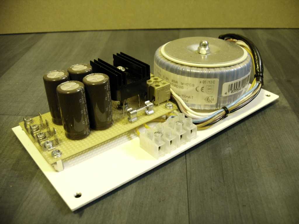

The PSU is also used to power my other synths, so I went with a 80VA toroid.
* there's something wrong with my camera (or I used the wrong setting) so the colors are a bit off.

PSU (raw DC)
 Filesize:  53.64 KB

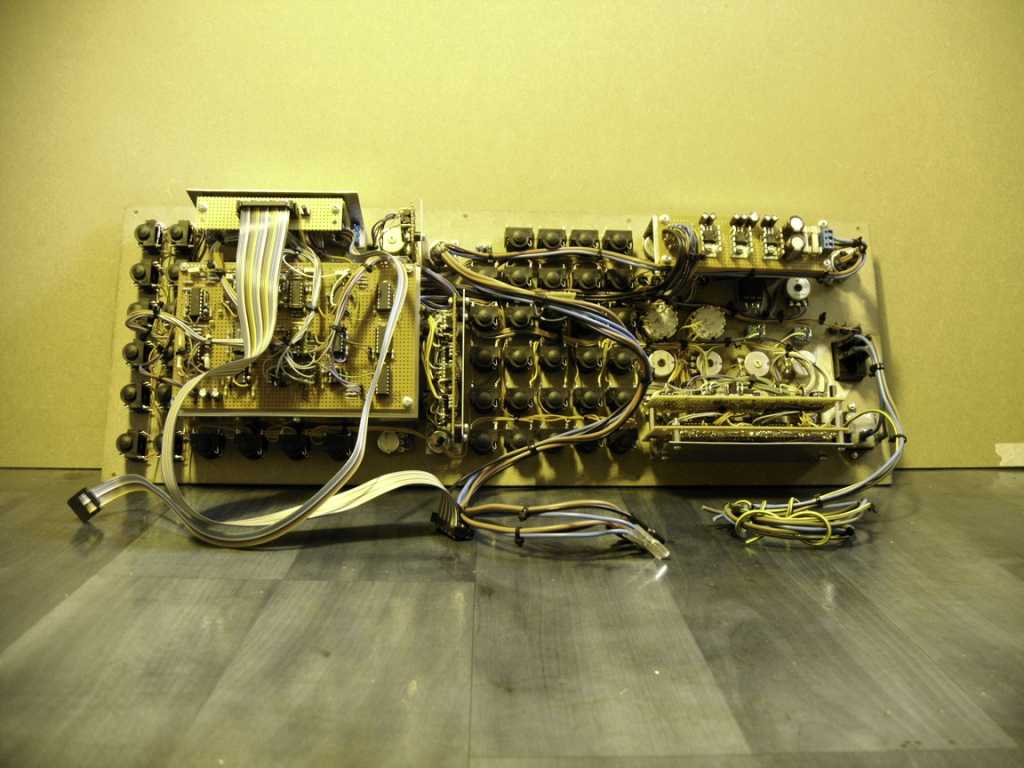

close up of voice and rhythm section.
 Filesize:  67.69 KB
 Viewed:  902 Time(s)

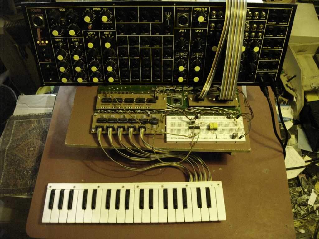

..The chips are shiftregisters which are going to be
So that's what i'm doing now. I first had to make a PCB with a couple of shiftregisters (parallel to serial converter) to connect the keyboard to
the PIC. I'm using 8 bit shiftregisters (74HCT165) and with 37 keys I needed at least 5. That would give me 40 inputs, but I choose 6, so I
have 3 + 8 extra inputs free to attach some extra switches for different modes.
Before adding midi and other things I first want to be able to just use the keys to control it. So I wrote a simple program that just sends the info
from the keys straight through. The good news is the keyboard almost works perfectly, except for two keys that seem to be linked together.
But I just opened it up and it's just one small trace I didn't cut Embarassed, so that's an easy fix. However there is something a bit weird going on;
when I play the keyboard it's delayed by one keypress,.. so If I press A, B, C, D I get _, A, B, C. My initial idea was that this might be caused by
the interface with the PIC somehow, but when I trigger the keys directly by shorting the (key)pads with a screwdriver I get the same result.
So far I had been taking the audio from after the envelope generators I added. So I tried the signal coming directly from the oscillators and then
it seems to work as it should. So I guess that somewhere I might have swapped something around, which I should be able to figure out. I also
noticed that I probably swapped some wires on the voice select switches, maybe the rhythms too depending on where I swapped them.
so I'll have to look into that aswell.

PostPosted: Sun Jul 07, 2013 11:27 am    Post subject: cool it man Reply with quote  Mark this post and the followings unread
I added some better cooling to the +12V and +5V regulators, works like a charm. The 5V regulator barely get's warm, and the 12V one get's a bit
warm, but it's a nice and mellow warmth Wink. So here are some pics of that, and a photo of the current test setup. Cool
bigger, better heatsink
 Filesize:  71.02 KB
 Viewed:  795 Time(s)
cool regulators
 Filesize:  76.83 KB
 Viewed:  795 Time(s)
current test setup, with keyboard and PIC.
 Filesize:  85.06 KB
 Viewed:  800 Time(s)

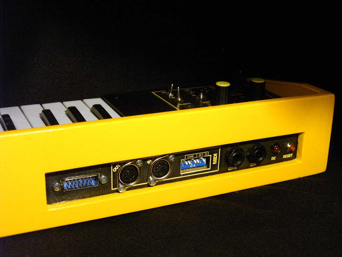

Posts: 5971
PostPosted: Sun Dec 28, 2014 12:39 pm    Post subject: Reply with quote  Mark this post and the followings unread
I think it has been collecting dust long enough now so I started finishing it up. The PIC is fully programmed although
I haven't tested the midi control yet (midi out works), but it is already present in the code. I played with it a bit,
having some fun with the arpeggiator, and I will post some recordings of that session later.
I'm now working on the keyboard case and then I have to make a case for the synth itself.
keyboard case
 Filesize:  73.06 KB
 Viewed:  759 Time(s)
keyboard case
 Filesize:  60.06 KB
 Viewed:  723 Time(s)

I put some paint on the keyboard Cool
EK2100 keyboard
 Filesize:  80.7 KB
 Viewed:  769 Time(s)
EK2100 keyboard
 Filesize:  91.31 KB
 Viewed:  734 Time(s)
EK2100 keyboard (backside connectors)
 Filesize:  63.08 KB
 Viewed:  733 Time(s)

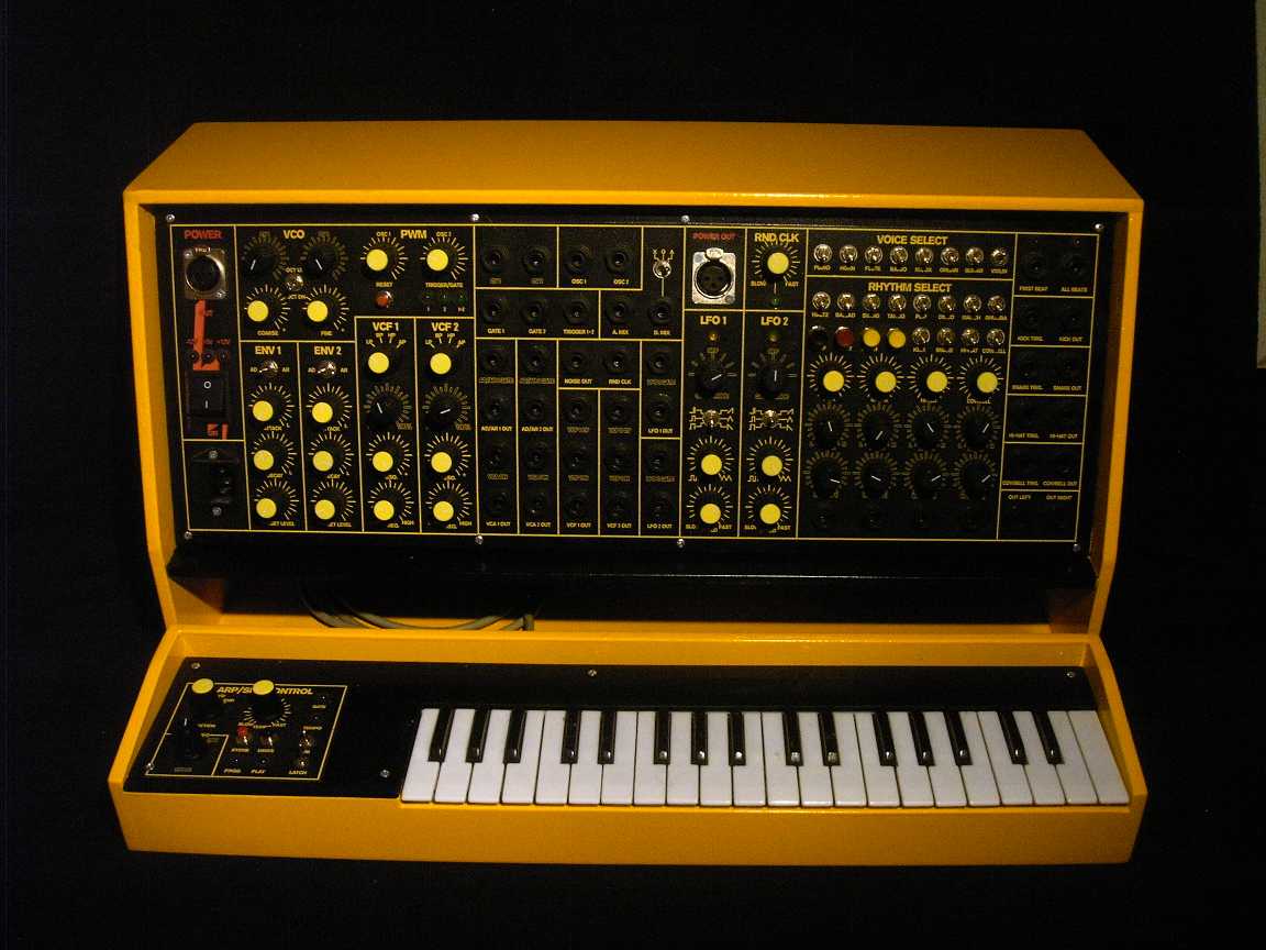

Posts: 5971
PostPosted: Thu Feb 05, 2015 1:55 pm    Post subject: Reply with quote  Mark this post and the followings unread
I finished it last night and did a quick test, which I recorded. Very Happy
The first recording has some arp. action the second one is a self playing noodle.
(more photos here )
 Filesize:  87.72 KB
 Viewed:  786 Time(s)
