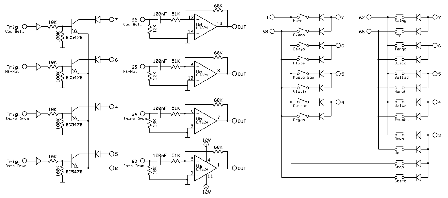

yes I did test it, I actually had it allready tested on breadboard when I posted the schematic, but now it's soldered up aswell. And I did a test
playing the demo and triggering the cowbell (which doesn't seem to be present in any rhythm) with it. Allthough the tempo is correct it doesn't
really seem to be in sync with the rhythm. Still usefull though and I could always make it sync up by adding a pulse delay
I used the space I had left on my perfboard to add trigger inputs and output buffers for the drumsounds. The triggers are made with a transistor
functioning as a switch. The output buffers are made with an inverting opamp to set the levels roughly to +5V/-5V. I added the capacitors so the
output is 0V when the drums aren't triggered. I also drew in the original switches and pushbuttons I'll have to add to get the sounds and rhythms.
I will use toggle switches for the sounds so it's possible to select more sounds at once (I actually haven't tried this with the rhythms yet, hmm).

The next thing I added was 2 envelope generators and VCA's. I used the AD/AR design from the Lun-A-Key but with a transistor inverter and a capacitor
on the input to create trigger pulses from a gate signal. I also added a zenerdiode to limit the maximum charge voltage. In triggermode the voltage
will rise to 2/3 of the supply Voltage (8V using a 12V supply), and then discharge. In gate mode it would keep charging to almost 12V without the
zenerdiode, which limits the voltage to just above the treshold level. I didn't convert the voltage to -5V/+5V but only buffered it with a voltage
follower since it is connected directly to the VCA. However I might change this so I can use the AD/AR and VCA's seperately. Rolling Eyes
I also made 2 VCF's based on the EFM Wildcat VCF which I found in the schematics vault (thanks vladosh!).
I used larger filter capacitors, changed some other values and added the 4.7M resistors to the base of the darlington's to keep the level around 0V.
This also tempers the resonance a bit so it doesn't go too wild.
I still have to make some LFO's, a mixer add midi and add the keyboard. I'm probably going to attach the keyboard to the PIC instead of hooking
both PIC and keyboard up to the CPU.
And then I have to solder most of it again for the other one I got Shocked

PostPosted: Sat Jul 06, 2013 5:30 pm    Post subject: moving in the right direction again Reply with quote  Mark this post and the followings unread
..,except for two keys that seem to be linked together.
But I just opened it up and it's just one small trace I didn't cut Embarassed, so that's an easy fix...
fixed Smile
..,So I guess that somewhere I might have swapped something around, which I should be able to figure out,..
I had the outputs swapped between the main PCB and the jacks, so I was using ENV1 with OUT2 and vica versa. Works a lot better now Very Happy
I also noticed that I probably swapped some wires on the voice select switches,..
yep, the wires going to pin1 and pin68 where swapped (I should stop doing that Laughing), so that works as it should too now.

PostPosted: Sun Jul 07, 2013 12:57 pm    Post subject: beat outputs working Reply with quote  Mark this post and the followings unread
And one more thing I forgot to mention in my last post is something about the beat outputs (tempo LED). They work but the first beat output triggers
on all beats at higher tempo's. I think I might be able to fix that by adjusting a cap though.
fixed that too by changing a resistor Laughing
(I'll add a note to the post in which I posted the schematic, might upload a new version).
and with that I think all the hardware works, so now to program the PIC.
That might take some time, but I've done the midi part before so can copy
that and I've also experimented with a (random) chord player which I can
use too. I don't have to finish all the programming anyway, I just have to
get an idea of what I want to add in hardware (switches/pushbuttons) so I
can finish the case.
