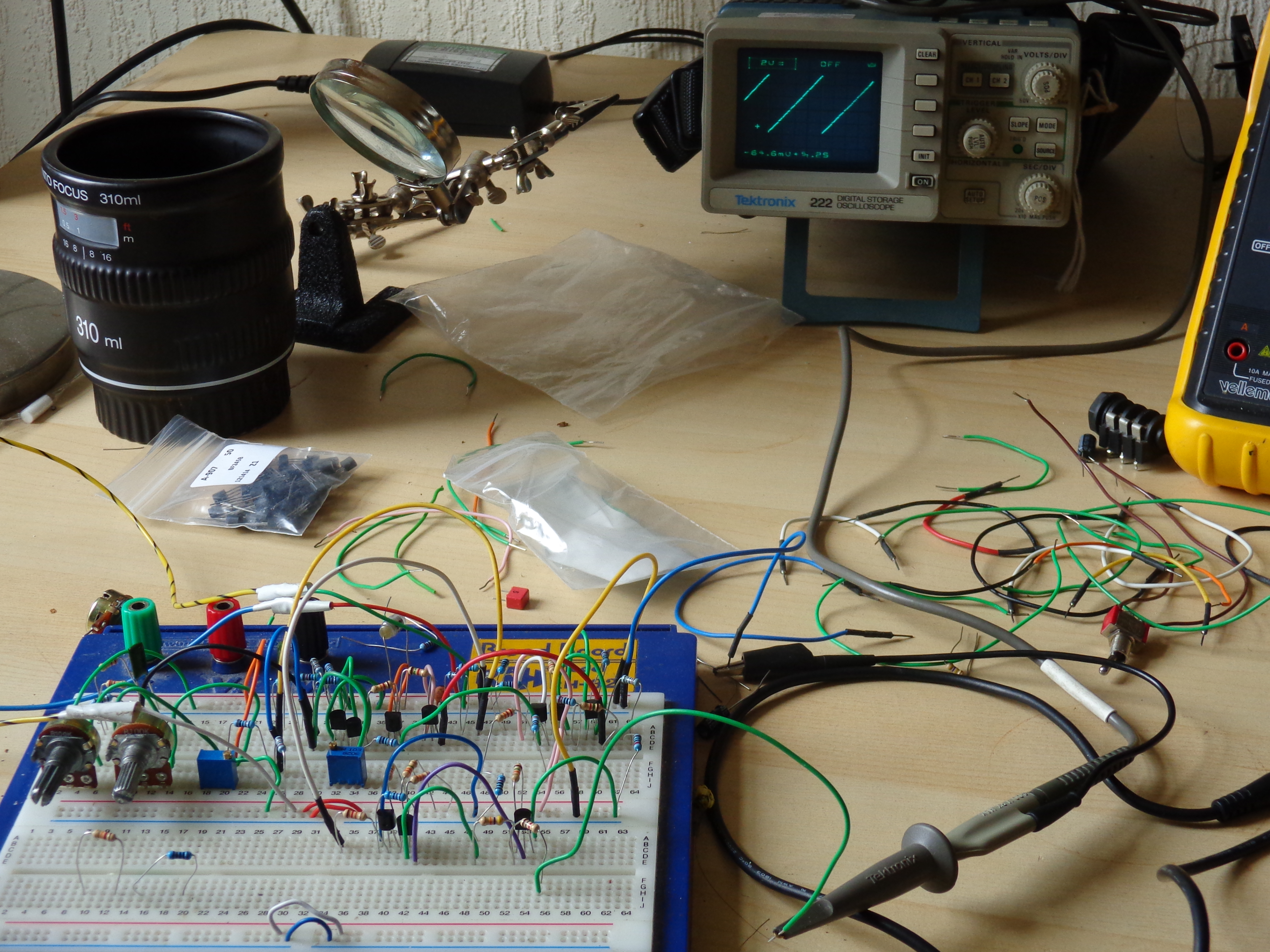

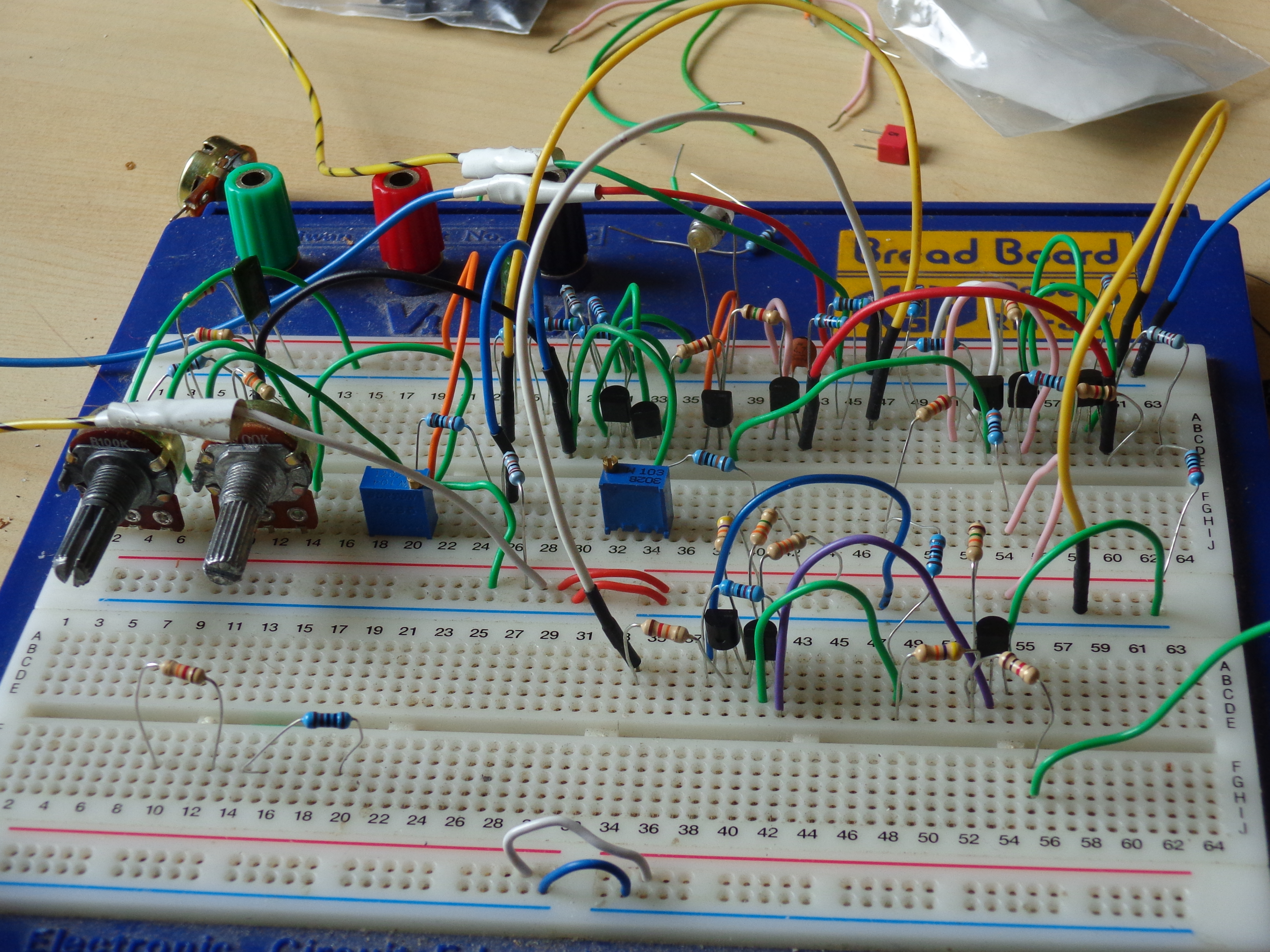

I've just finished Breadboarding the Arp 4027-1 Saw-Core and this thing is pretty cool so I thought I would post my findings. I must say that I’m no expert I’ve just been following the resources on the internet and hoping for the best.
When I come to building this VCO I didn't want to use any hard to get parts so after consulting Andy1960 ARP VCO thread I replaced the ca3046 with unmatched 2n3904 transistors.
Check out the pictures of the VCO core on the breadboard and the resulting Ramp wave form using 2n3904/2n3906 and 2n5457 transistors.
Sure you can still get the ca3046 but a 100 2n3904 is about the the same price as a couple of chips and a lot easier to get hold of, this fact sells it to me every time.
The only hard to get part will be the JFET's seeing that someone thought it was a good idea to cease production. The good news is that I tried every JFET I had to hand and the circuit kept purring away.
Here is a list of JFET's I used with no noticeable differences
2n5457
2n5485
2n3819
J201
I couldn’t test the BF245 because the batch of 50 I bought are duds which I must say is pretty disappointing. I do believe this JFET should work because I’ve seen people stating these fellas as a working substitute.

I breadboarded the original schematic first of all. The wave-shape was nice looking and sounded good. They was a little offset when testing. I then implemented Bergfotron resistor value changes to the vco core. They are about 5 value changes. These changes seem to correct the DC offset on the Ramp output.
I decided to implemented Bergfotron triangle wave-shaper. This wave-shaper uses commonly available parts which is a bonus. I decided to leave out the CV controlled switch circuity on the Bergfotron basic VCO. but the addition of a square, sine saw and ramp output + - 5V would be very useful. For the square and sine shapers I decided to use Thomas Henry circuits from his VCO-1 design. The triangle output is the correct amplitude for the wave-shaper inputs.
The sine wave-shape might need a bit of tweaking. If so you will want to read details on TH VCO-1 page, I've just left the value stated on the vco-1 schematic.

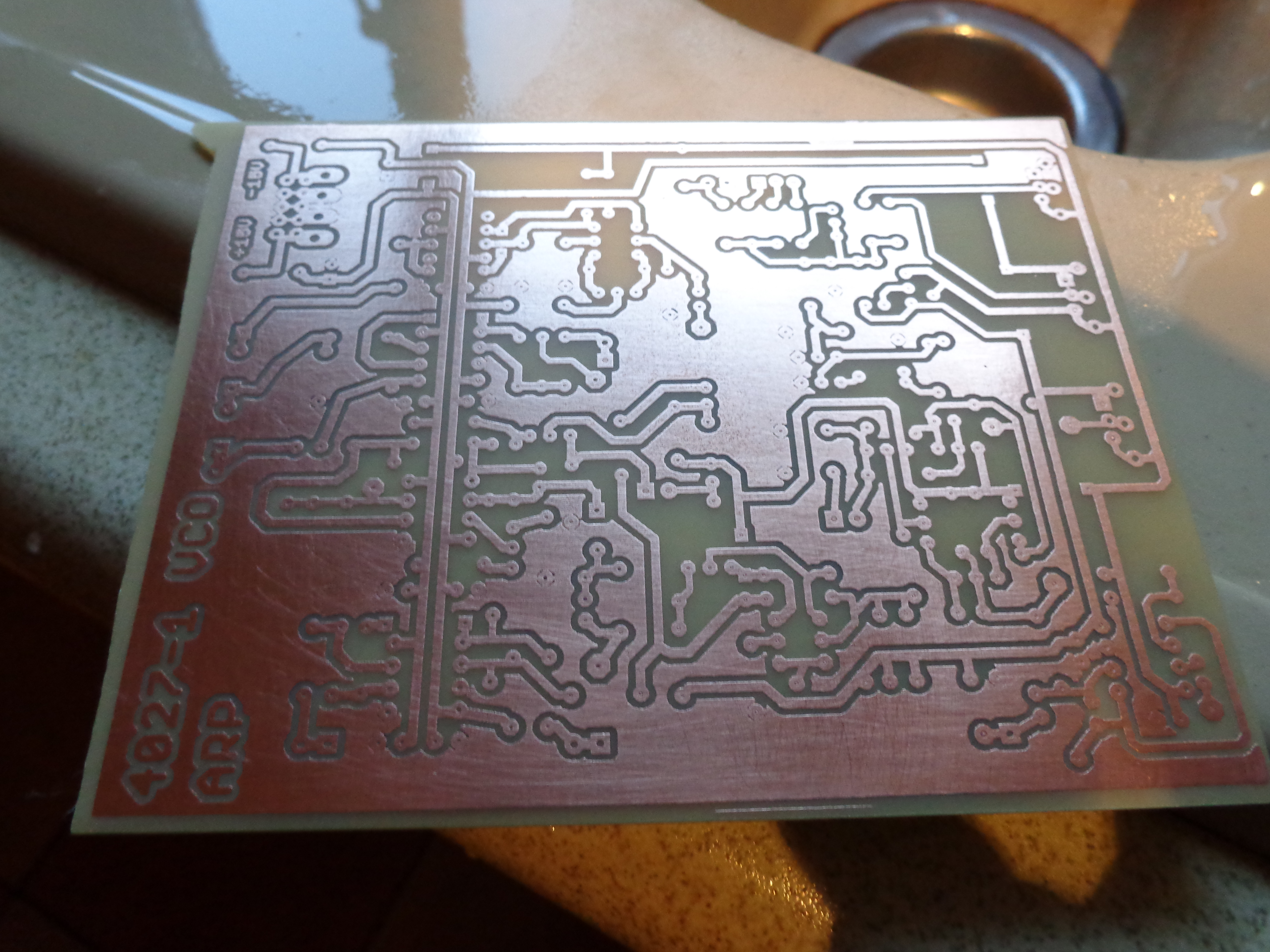

Below is the finished Single sided PCB I’ve been working on.
I've added the sync circuity from Bergfotron Basic VCO, The PCB has Sine, Saw, Ramp, Square, and Triangle outputs.
The square wave has one PWM CV input
One Header accommodates 1-V/Oct, and 2 FM Inputs.
The Low Frequency Switch will require a 3PDT switch. (When all Switch are closed the VCO will operate in Low Frequency mode. The LF switch Headers are labelled SW-A, SW-B and SW-C, Header SW-B will require shielded cable that is grounded at one end)
I've deleted picture in the earlier post in favour of this one to save space.
Once this is built and tested I’ll upload the PCB layout. if anyone is brave enough and can't wait until this is done I can send you the eagle files.
Thanks all

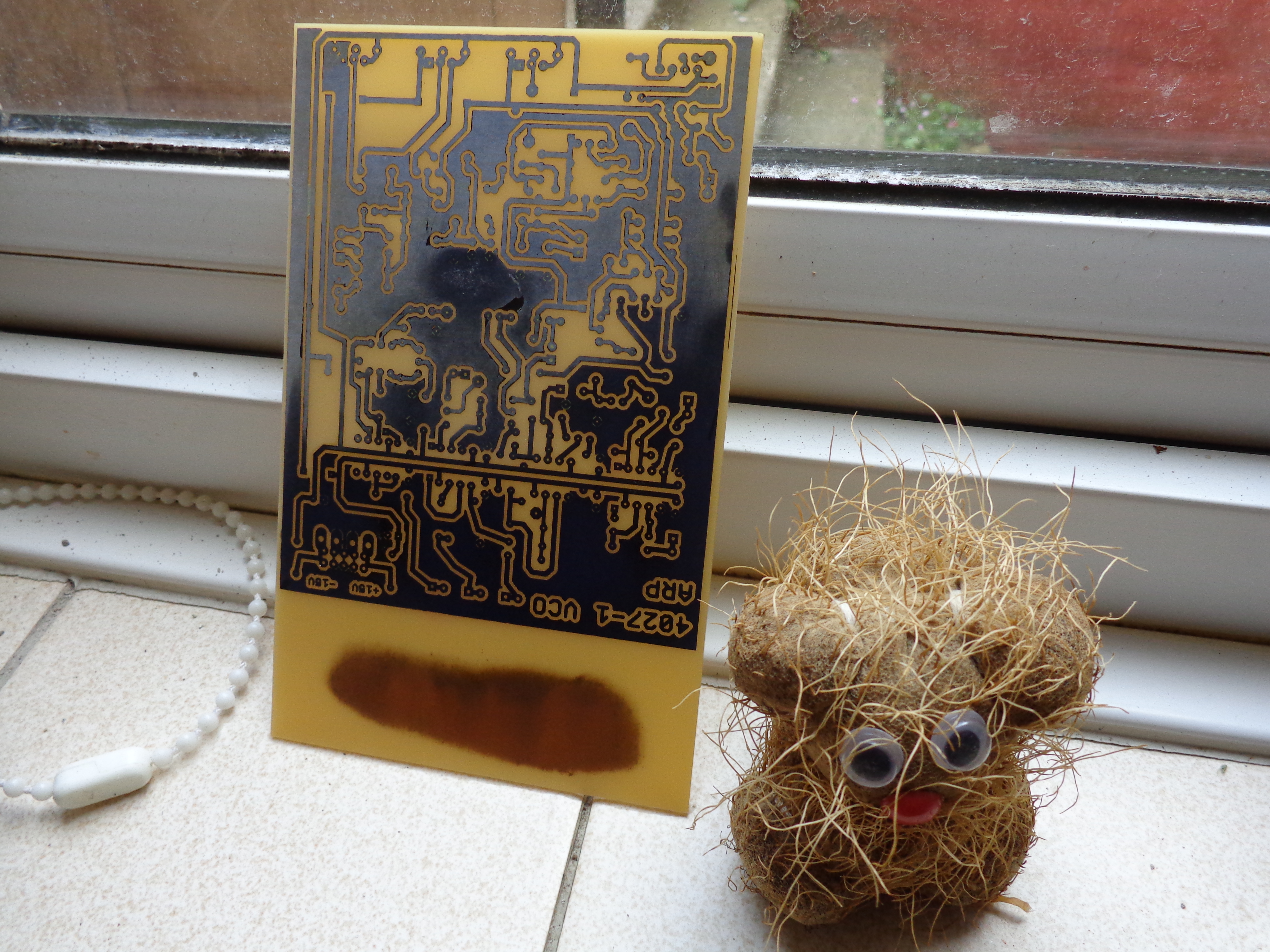

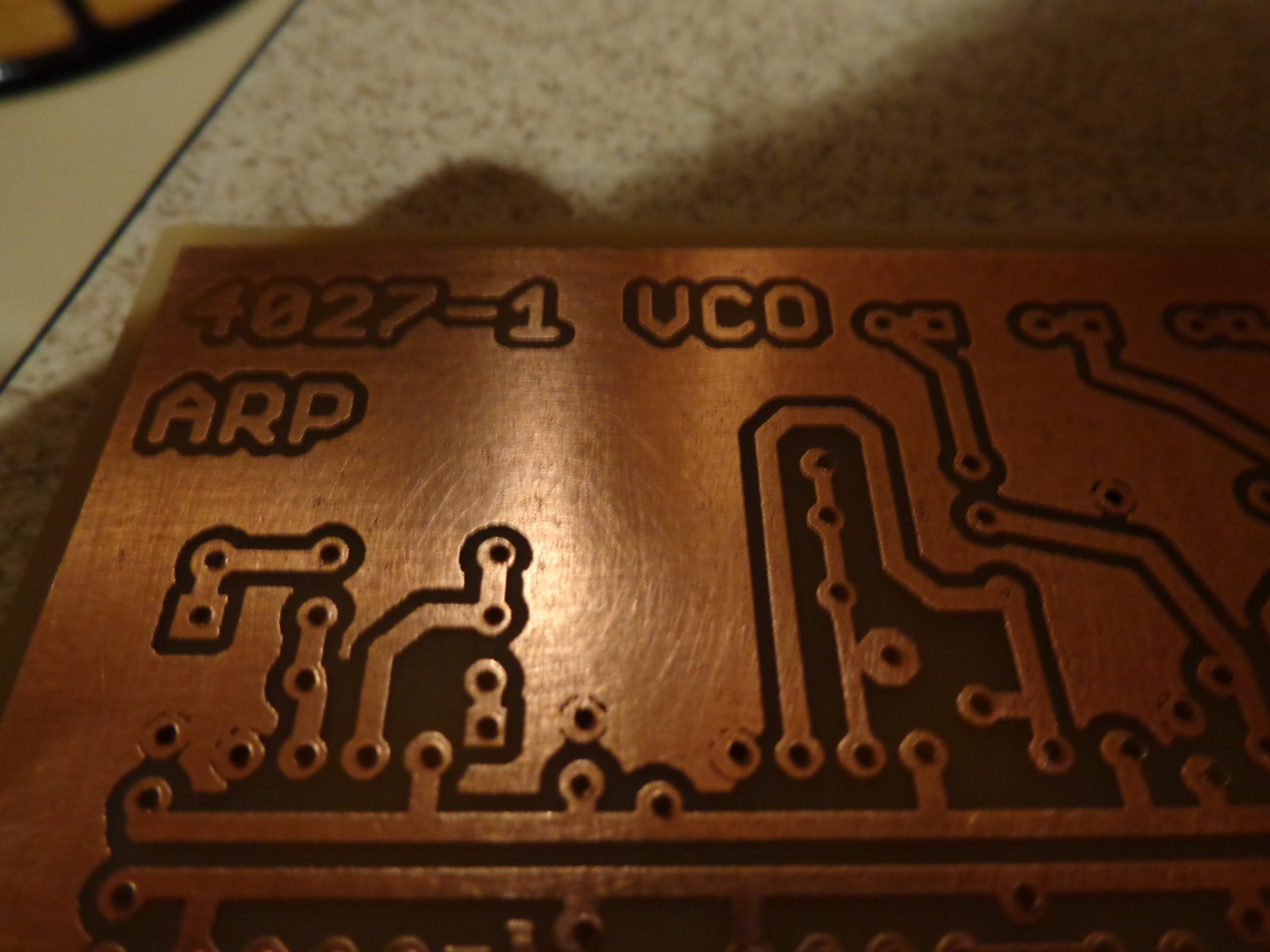

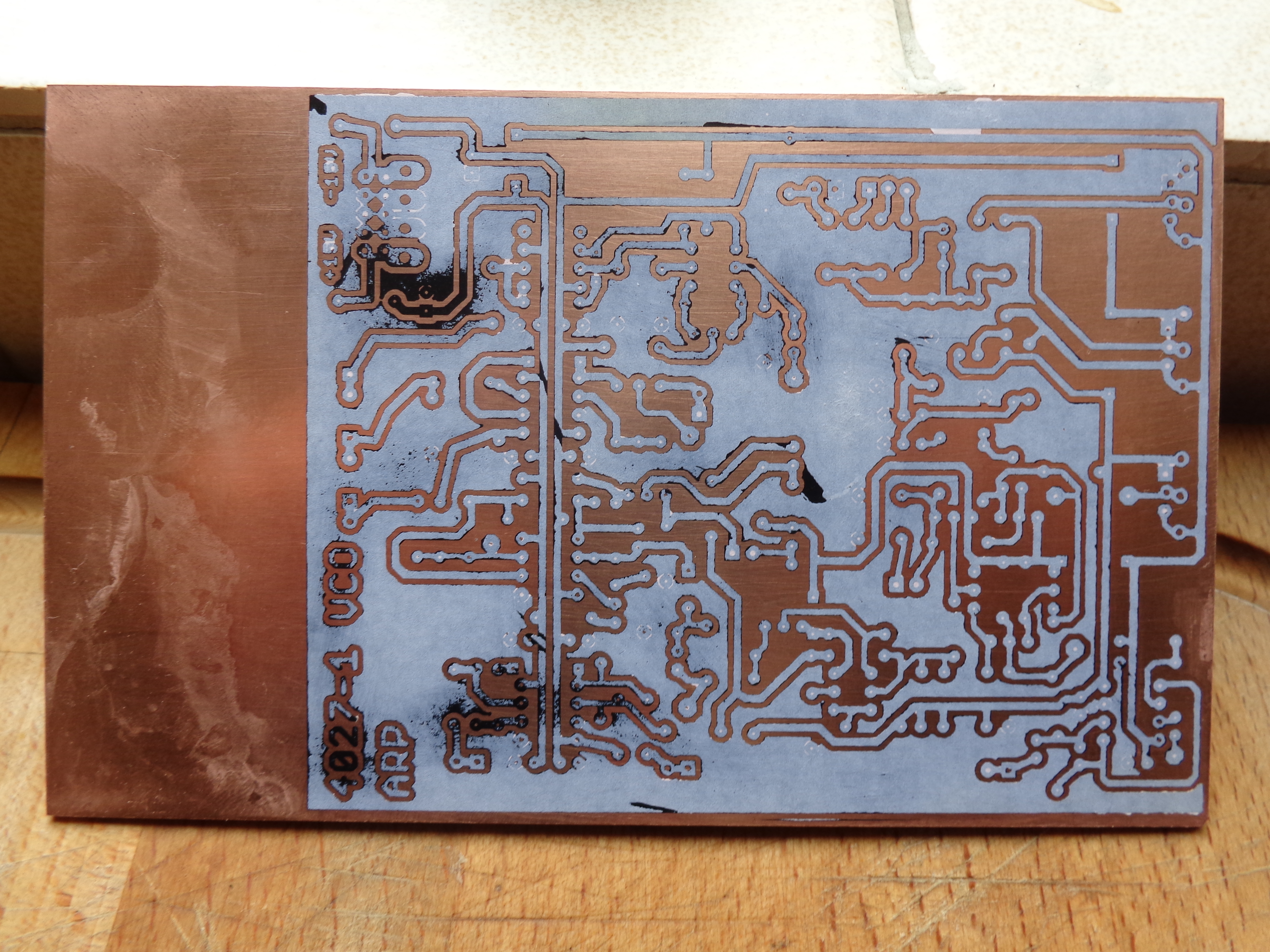

A quick update on this VCO
I've got the board etched and drilled. Hopefully get it built tomorrow.
If all goes well i'll have the build documentation up soon.
here are some picture in the mean time
