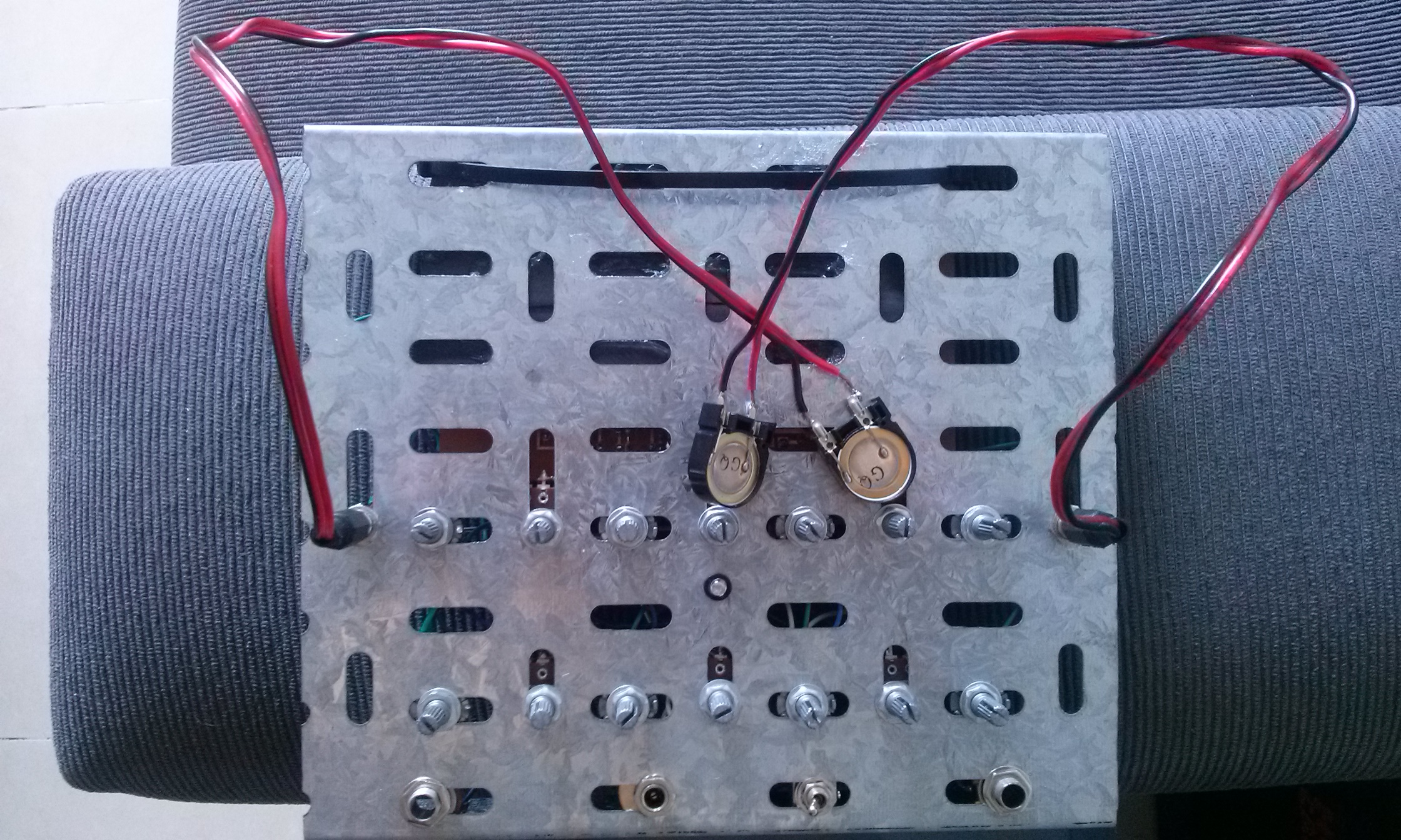

PostPosted: Wed Mar 05, 2014 2:11 pm    Post subject: trouble
Subject description: it doesn´t sound good
hi,
I finised a double coron but it doesn´t sound good, it sound very loud, when a move any pot it sound both chanels and the trigger do not work.
i think it is a trouble with the wiring, because i was extremely careful with the pcb.
All the ground to a single point, the jacks too
I use a guitar amplifier
I use external 9v, negative ground
can someone help my?
thanks
there are two pictures of the divice
thank
Martin

burtondelfuturo
Joined: Jun 10, 2013
Posts: 4
Location: Buenos aires
PostPosted: Wed Mar 05, 2014 2:17 pm    Post subject: Reply with quote  Mark this post and the followings unread
the front of the machine...
 Filesize:  1.13 MB
 Viewed:  1041 Time(s)
jumunius
Joined: Apr 19, 2010
Posts: 346
Location: San Francisco, CA
PostPosted: Wed Mar 05, 2014 3:21 pm    Post subject: Re: trouble
burtondelfuturo wrote:
hi,
Are you actually wiring your grounds? It looks to me like some of your ground wires aren't even connected (for example, I see unconnected ground lugs of some pots and jacks). You need to solder every ground wire to ensure that everything is properly grounded.
-Jim
burtondelfuturo
Posts: 4
PostPosted: Mon Mar 10, 2014 5:15 pm    Post subject: Reply with quote  Mark this post and the followings unread
jumunius:
Thanks for your reply, the grounds are wiring with the metalic case, I will check it with the tester anyway.

Hello, and thanks for supplying the schematics Smile
For someone not super savvy thats great work and some good thinking.
And youre right, none of the mentioned deviations had any effect on my problems, which needed reflowing, cleaning etc
So all schematics have been confirmed correct so far.
Ive done all the mods except the feedback/trigger circuit because I ran out of room, but can still try it with patching/clippers instead.
The best part is having CV inputs really, the basic vco and lfo and filter is well, basic, but add a 3rd source of modulation and youre in business Smile
Ive got both sides working as far as pitch and filter and so on goes now, only thing left is the volume envelopes.
Its always on regardless so I thought as the only thing changed there from the original was going from 22K to 1K by the trigger input, it would probably be there that the problem is?
The decay envelope (wired as in original schematic 1 and 2 to ground, 3 to that 1K) also hangs (trigger light stays on) when turned fully clockwise.
Why did you change it?
I think Ill just try a few different values there and see what happens ...
Heres a preliminary pic, also adding some very simple snare/hat circuits and a mixer.
Starspawn
Joined: Jun 14, 2013
Posts: 85
Location: Oslo
PostPosted: Sun Jul 20, 2014 7:23 am    Post subject: Reply with quote  Mark this post and the followings unread
And FIXED! Ill shame myself by describing how so its a lesson to other sloppy people.
Sometimes when the build has interconnected a bit beyond control and easy manipulation, and when its a stripboard design especially, the temptation to not take it apart, but just solder to the nearest resistor leg is big.
Thats what I did with the decay (and a bunch of others that were fine) ... on R1 cause it was on the same line as R3 and had easier legs to solder to ... offcourse I didnt see the cut between them from above, missed it looking at the stripboard and schematic because I didnt remember having done it, and didnt get it until the 5th pass (at least).
So dont do that.
Now:
PIIIOOOOU!
Thanks for making it all available people!
All contributions in thread confirmed working Smile
