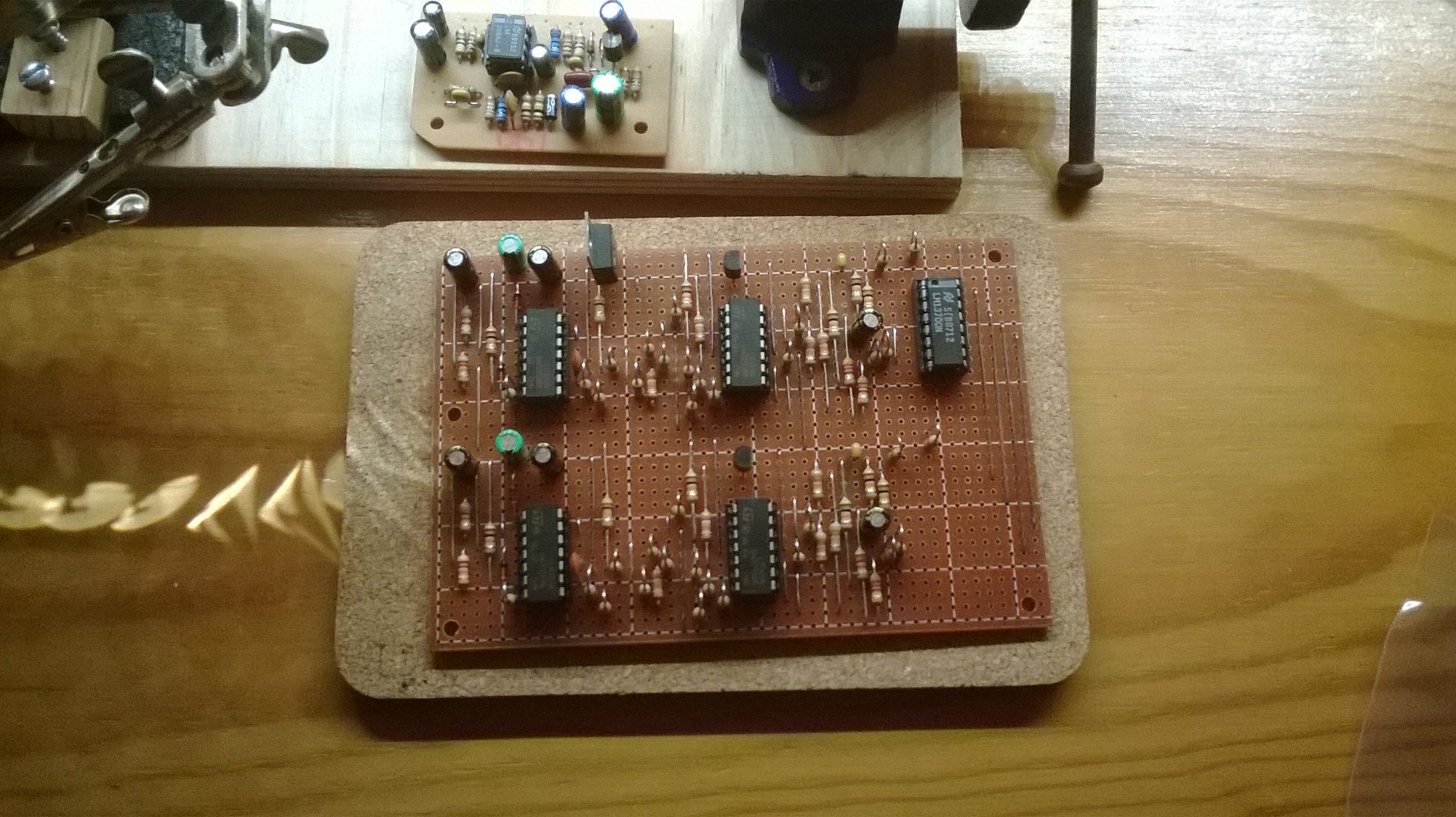

PostPosted: Wed Feb 18, 2015 9:24 am    Post subject: Reply with quote  Mark this post and the followings unread
I need help Sad
I build the dual ds7 from Uncle's stripboard layout, but I don't get any sound.
Apparently everything is fine, the only response I get is with the decay all the way up I start hearing the trigger pulse. LFO seems fine as I checked driving one led through a transistor.
Any one got the same problem? Any suggestions? Idea
On the pic there are somecomponents missing but not anymore)
 Filesize:  1.55 MB
 Viewed:  425 Time(s)

PostPosted: Wed Feb 18, 2015 9:47 am    Post subject: Reply with quote  Mark this post and the followings unread
Looks right, but what have you done with the potentiometers when testing?
Id double check the cuts under again, and check the soldering.

PostPosted: Fri Mar 06, 2015 5:26 pm    Post subject: Reply with quote  Mark this post and the followings unread
I double check everything changed the transistors (by the way I am using bc547) Is there something more I can do before changing the IC's?
 Filesize:  1.9 MB
 Viewed:  429 Time(s)
Starspawn
Joined: Jun 14, 2013
Posts: 85
Location: Oslo
PostPosted: Fri Mar 06, 2015 11:18 pm    Post subject: Reply with quote  Mark this post and the followings unread
Yes, youve grounded the output pin in the jack sockets instead of the ring/ground pin (ground should be the lonely pin near panel), and your signal to the switched pin (so when somethings inserted its not connected).
Also not sure of the pot wiring, if you have a pot sitting on your table, with legs pointing to you, shaft up, then 1 is your leftmost pin.
Check against this: http://m.bareille.free.fr/ds7clone/ds7wiring.gif

PostPosted: Sat Mar 07, 2015 1:44 am    Post subject: Reply with quote  Mark this post and the followings unread
Thank you Starspawn for the tips! Very Happy
This jacks have the ground ring pin on the side. I tested for continuity and the tip is not grounded.
Also double, triple checked the pots. I did the pin 1 the most left over with the shaft up (but if I wire it backwards wouldn't hurt, just the response would be on backwards Razz )
