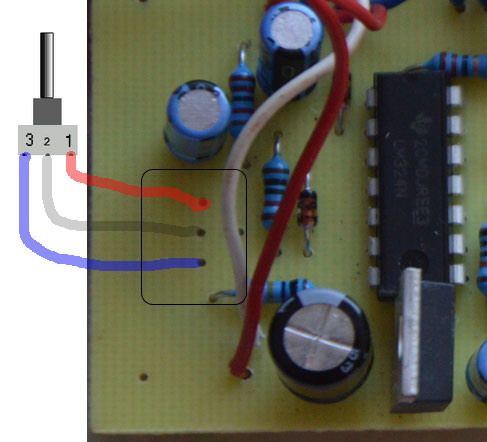

PostPosted: Wed Aug 21, 2013 12:38 am    Post subject: Reply with quote  Mark this post and the followings unread
Thanks Jumunius for your reply. But since I'm a beginner, what pins should I test on each IC ?
Another user asked for pictures, so find my hi-res pics if it's helpful :
http://dl.free.fr/b4A77O77q
xpmtl
Joined: Aug 10, 2007
Posts: 162
Location: Brussels, Belgium
PostPosted: Wed Aug 21, 2013 3:35 am    Post subject: Reply with quote  Mark this post and the followings unread
For U1 : +5V at pin 7, GND at pin 4
For U2 : +5V at pin 4, GND at pin 11
For U3 : +5V at pin 4, GND at pin 11
For U4 : +5V at pin 7, GND at pin 4
Check that U100 (7805) is outputting +5V.
Which components are heating up?
Hum could be a bad ground connection.
http://sdiy.xpmtl.net
feggster
Joined: Sep 12, 2011
Posts: 52
Location: uk
PostPosted: Wed Aug 21, 2013 3:42 am    Post subject: Reply with quote  Mark this post and the followings unread
you missed the connection for trigger input, try a 47k-50k pot.

nuclearsound
Joined: Jul 16, 2013
Posts: 24
Location: Nantes, France
PostPosted: Fri Aug 23, 2013 12:14 am    Post subject: Reply with quote  Mark this post and the followings unread
Indeed, with that pot, it works... Confused The only thing now is that the output volume is reaaaaaaly low, even with the volume pot @ 100%. I plan to change R30 to a 330k or even 470k. But it seems so low that i can't imagine it could be enough. Just a quick question : are the pots current conductive ? Because I screwed them all on an iron plate on the back side.

Hello, and thanks for supplying the schematics Smile
For someone not super savvy thats great work and some good thinking.
And youre right, none of the mentioned deviations had any effect on my problems, which needed reflowing, cleaning etc
So all schematics have been confirmed correct so far.
Ive done all the mods except the feedback/trigger circuit because I ran out of room, but can still try it with patching/clippers instead.
The best part is having CV inputs really, the basic vco and lfo and filter is well, basic, but add a 3rd source of modulation and youre in business Smile
Ive got both sides working as far as pitch and filter and so on goes now, only thing left is the volume envelopes.
Its always on regardless so I thought as the only thing changed there from the original was going from 22K to 1K by the trigger input, it would probably be there that the problem is?
The decay envelope (wired as in original schematic 1 and 2 to ground, 3 to that 1K) also hangs (trigger light stays on) when turned fully clockwise.
Why did you change it?
I think Ill just try a few different values there and see what happens ...
Heres a preliminary pic, also adding some very simple snare/hat circuits and a mixer.
Starspawn
Joined: Jun 14, 2013
Posts: 85
Location: Oslo
PostPosted: Sun Jul 20, 2014 7:23 am    Post subject: Reply with quote  Mark this post and the followings unread
And FIXED! Ill shame myself by describing how so its a lesson to other sloppy people.
Sometimes when the build has interconnected a bit beyond control and easy manipulation, and when its a stripboard design especially, the temptation to not take it apart, but just solder to the nearest resistor leg is big.
Thats what I did with the decay (and a bunch of others that were fine) ... on R1 cause it was on the same line as R3 and had easier legs to solder to ... offcourse I didnt see the cut between them from above, missed it looking at the stripboard and schematic because I didnt remember having done it, and didnt get it until the 5th pass (at least).
So dont do that.
Now:
PIIIOOOOU!
Thanks for making it all available people!
All contributions in thread confirmed working Smile
