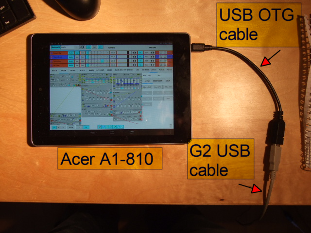

Ok, I managed to get the USB connection between Android and the G2 going Smile
It wasn't as difficult as a I feared, but there are a couple of requirements for the tablet:
- The Android device must support "Host USB" mode
- You need a USB OTG (On the go) cable
I'm happy with this because these Android tablets don't cost a lot of money, I have an Acer A1-810 which supports USB host mode, and costs about 175 euro.
I ran the editor, but the full application is much too slow to be of any practical use and also the screen is too small for the application.
So I'm going to downscale my ambitions for the moment, and first make a simple G2 controller app for Android. I'm thinking loading patches, setting variations and some parameters.

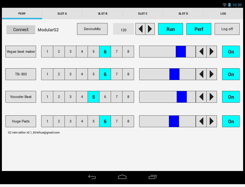

Couldn't resist making a little application Smile
It isn't much yet, just loading patches/performances and changing variations, but it responds well and is just fun to play with.
For anyone interested in the programming part of making the Usb interface working on Android with Delphi, you can find some demo code over here http://www.bverhue.nl/g2dev/?p=65
 Filesize:  614.86 KB
 Viewed:  846 Time(s)

If you have an Adnroid tablet supporting USB Host mode, you can give the application a try. You can download an experimental version over here http://www.bverhue.nl/g2dev/?p=108 and read some instructions how to install and use it.
It's not much more than a controller at the moment, and it may crash now and then, but has some potential.
The problem of the usb interface is mostly tackled, at least, on my acer a1-810. The crashing happens mostly when sending a lot of parameter messages to the g2, for example by moving a slider up and down with high speed, so I had to put a limit of 20ms on that, which in turn causes latency. So that's something that remains to be solved.
Another problem is how to implement a complex patching interface on a small screen and a slow processor.
