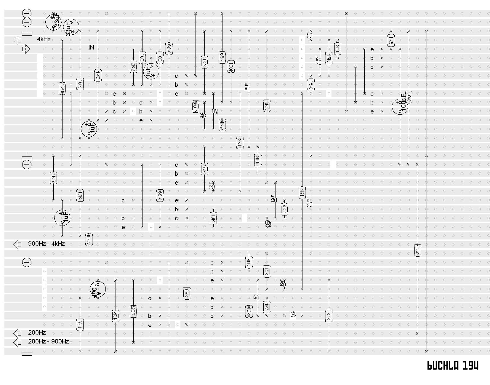

Here's a layout for Buchla 194 Filter
happy building

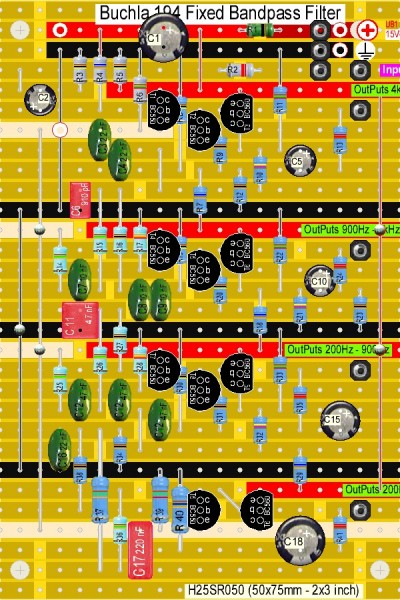

PostPosted: Sat Jan 26, 2013 1:08 pm    Post subject: Reply with quote  Mark this post and the followings unread

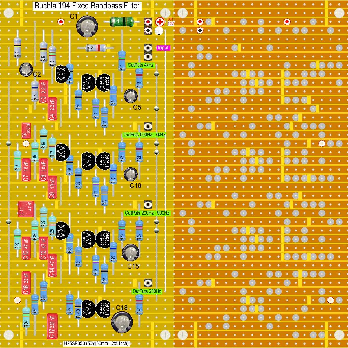

- Here's another layout for Buchla 194 Filter, using a standard H25SR050 50x100mm - 2x4 inch stripboard

Always nice to see more stripboard layouts! Smile I've been meaning to go through the entire DIY section and weed out all the threads with stripboard layouts and post a page of links to them all for easy reference. The same could be done for perf too. Idea Might take a while though.
Just a couple of things.
Vladosh: You might want to check the distance you have some of those resistors stretching. It may be too much without extending the legs with extra wire or adding a jumper along the way.
Nardu: Your diagram has cuts between the holes. How are you breaking the tracks this way? Are you using a knife? My first build I cut and scraped away the copper with a knife. It took ages! I now use a 3MM drill bit in a pin vice to drill the copper tracks where I need to break them. I drill just enough to cut the track, not all the way through which would affect the structural integrity of the board.

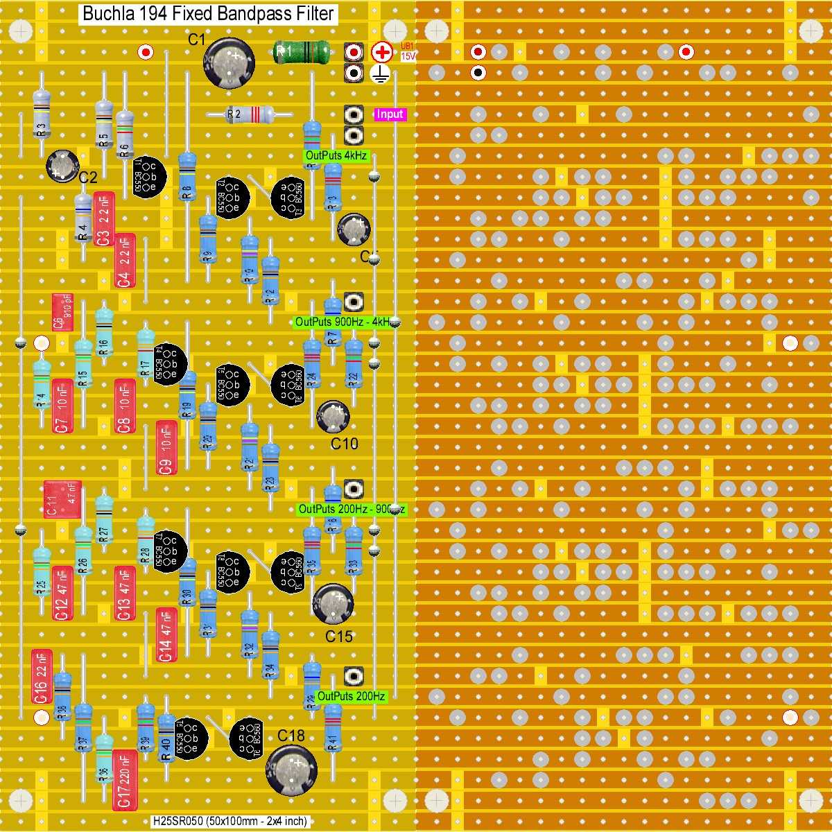

PostPosted: Sat Jan 26, 2013 5:02 pm    Post subject: Reply with quote  Mark this post and the followings unread
@-minus-
Just I like a compact design !
Personally, I scratch with a simple screwdriver - a little harder.
Below, a classic version :

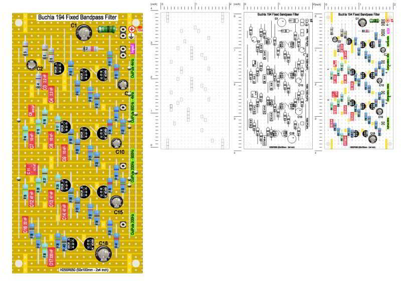

Some stripboard helper prints. See pdf file.

Another way to transfer circuits is to breadboard the circuit and make sure it works, then buy a proto board which matches your breadboard. It's simply a case of transferring your breadboard layout to the solder board. I'm not sure who makes it but I have seen strip board/vero/proto board which is printed with columns of strips with breaks already in it. It might be cheating though! Laughing
PostPosted: Mon Jan 28, 2013 6:55 pm    Post subject: Reply with quote  Mark this post and the followings unread
I've used the breadboard matching protoboards, and honestly it's not that simple, usually Smile
Biggest drawback is that my breadboard has two channels on each side for power connections, but these usually only have one. And they don't have power lugs, so you lose 4 to 6 rows on one side to connector + caps. And usually it's *shorter* than my breadboard....
Can you tell I've used these a lot? Very Happy
It is a good idea, not trying to throw stones, but there are considerations that need to be taken into account while you're breadboarding if you want to pick up and move it.

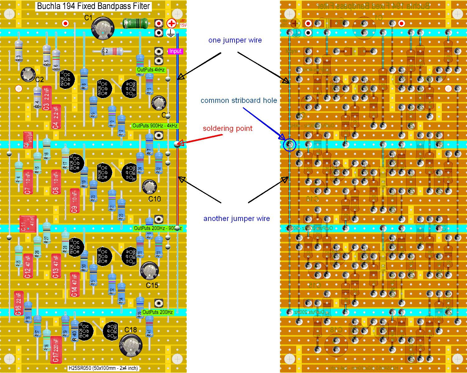

Got a question about this...I know, its old Very Happy
What are those points (indicated by red circles) : are those connections?
Also
- whats the red dot on the third line, right under the "1"
- what are the white dots around R4 and C16?
Got every parts for this, but Im a bit confused, I'm not familiar with Lochmaster...
 Filesize:  484.71 KB
 Viewed:  710 Time(s)
Nardu
Joined: Feb 28, 2011
Posts: 62
Location: Braila, Romania
PostPosted: Thu Jun 26, 2014 1:45 am    Post subject: Buchla 194 Stripboard design in Lochmaster Reply with quote  Mark this post and the followings unread
See image below :
- I used this trick to indicate that the two jumper wire use the same hole.
In this way we obtain a compact stripboard design.
Buchla 194 Stripboard design in Lochmaster trick
 Filesize:  432.77 KB
 Viewed:  689 Time(s)
http://nardusynth.blogspot.ro/
