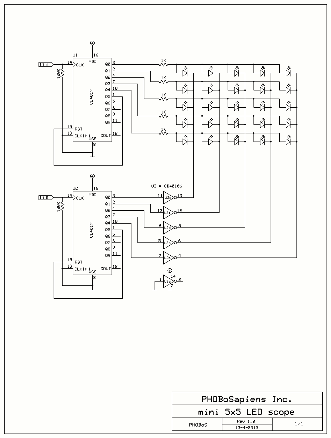

PostPosted: Mon Apr 13, 2015 8:21 am    Post subject: mini 5x5 LED scope
Subject description: simple visualizer for squarewaves
from this thread.
coppertraces wrote:
How does the 5x5 matrix work in your synth?
The display I made uses 2 decimal counters (CD4017) with the outputs of one being inverted and those are connected
to the matrix display (which in my case is made up of seperate LEDs). The signals are connected to the CLK inputs
(only squares), so it's like a really simple XY LED scope.
coppertraces wrote:
Am I right in thinking it should always give you a diagonal line when the two oscillators are tuned to the same frequency
Yes you're correct. And the angle/number of lines varies depending on the ratio between the 2 frequencies.
Also the closer the frequencies are to eachother the slower they move across the display. But because the
display has such a small resolution they don't really look like diagonal lines anymore at some point.
I choose 5x5 because I made it out of seperate LEDs and the count goes up pretty fast when you make it larger,
but a larger one would definitely be nicer. I was also thinking about using an RGB matrix that might give some very
interesting results.
I should have a schematic somewhere but I'm wondering if I just drew it on some paper because I can't
seem to find it right now. I'll post it if I do and maybe make a seperate thread about it.
I found it so here it is Cool
U3a could be made into an oscillator to CLK U1 or U2.

Thanks for posting the schematic. It's nice and simple... I like it!
I wonder how you could boost the resolution without having to use hundreds of LEDs or make the circuit a lot more complex. I guess that's part of the downside of only having the LEDs turned on or off instead of fully analog in brightness like on my Videodrone design: It's large dynamic range makes up for its low resolution.
If you're mostly trying to get it to line up diagonally you could use a diamond pattern instead of a square. Of course you'd also have to change how the LEDs are hooked up to the 4017s to make it actually work differently, but it would give you more resolution where you need it with the same number of LEDs to solder.
Although digital they do fade because of PWM. That was actually what started it, the idea to make a light chaser with fading LEDs.
(which was just one line of the matrix)

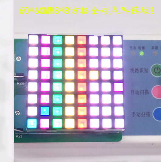

I found a supplier here in china that has RGB led arrays Shocked Shocked Shocked
Going to have to make a mad rgb video device

Wow so I finally tried this thing out and wow! Beautiful! I used an led matrix from some vetch toy. It's 6x7 so I don't think it has the feature of displaying a steady diagonal when both clocks are synced. It sort of always scrolls around. I'll try resetting one clock a step early and see how it functions differently with a square matrix.
Turns out the binary counters that I have, 4029 I believe, only have 4 bits so I just used 4017s. 4x4 sounds too small to me and I don't want to use too many chips. I have been wondering, though, how many LEDs can one output drive? Would be really cool use the same idea to drive 4 matrix panels and arrange them in an inverted fashion to make "fireworks"

Instead of resetting it one step earlier you could also reset it one step later (so 7x7).
yeah I can imagine 4 panels would look nice Very Happy. The number of LED's depends on the current so you could
keep it low if they are pretty bright. However if you would build it using individual LEDs instead of an existing
matrix you could just put 4 LED's in series. Lot's of wiring though so I guess it would be easier to either
use a low current or add some buffers. Maybe use a 4049 instead of a 40106 and add a 4050 to the other 4017.
Those are capable of driving a bit more.

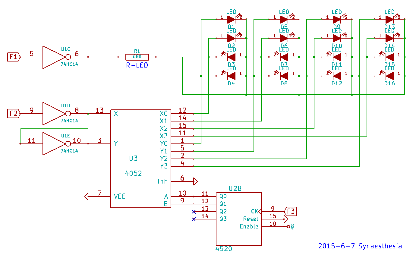

This is too small to be called a mini-scope, but just for the fun of it, I built a 4x4 LED display. The core idea is to use the 4052 as a dual multiplexer and connecting the LEDs in charlie-plexing style. The circuit uses a 74HC14 because it is a Schmitt-trigger inverter like the 40106, but can source and sink much more current.
The circuit works, but is extremely hard to adjust because of the way that I am driving it and because of the small size. So don't expect to see any lines here, but only fast changing patterns. The circuit will cycle through four columns with F3 as the clock and light up one of four LEDs per column depending on the output of F1 and F2 combined. That is one LED for either the 2 bit input pattern 00, 01, 10, or 11.
I had to put a piece of paper over the LEDs to calm the camera down. I used 16 ultra-bright red 3mm LEDs for the display. There is really only a need for one resistor that limits the LED current (R1), as only one LED is active at any time.

hmm why didn't I reply to this Embarassed
Anyway, very nice circuit! It also reminds me that I should look into charlie-plexing again.
I did years ago but didnt really understand it, maybe I will now.
