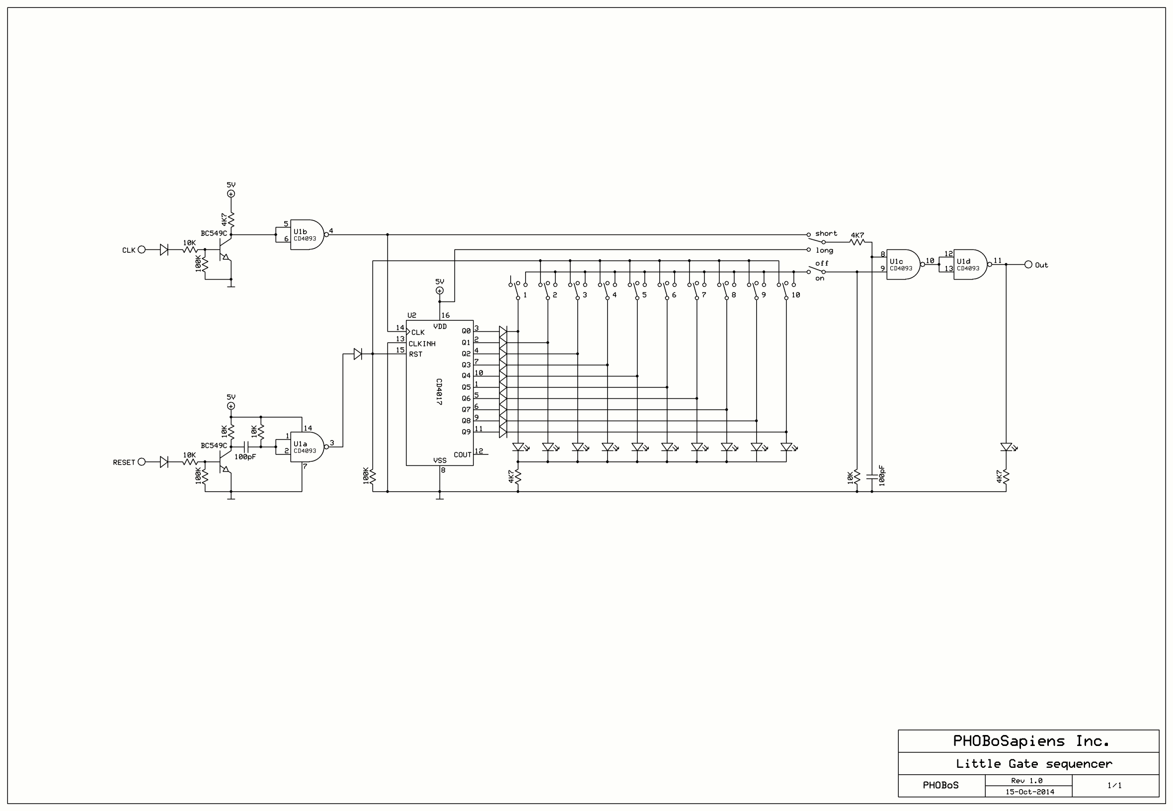

A simple gate sequencer based around a CD4017. Using toggle switches with center position to choose between on/off/reset for every step.
There's an on/off switch which makes the output low, and a short/long switch to choose between short pulses or 1 long one when several
steps in a row are turned on. It's actually a variation on the double pulse swing divider.
Diode placement in this circuit is incorrect. updated verson posted below

it is so simple with this gate / reset combi switch - i realy like it.
why are you using this Transistors at the inputs?
Posts: 5918
PostPosted: Wed Oct 15, 2014 3:13 pm    Post subject: Reply with quote  Mark this post and the followings unread
Using the switches is also much more practical than a rotary/slide switch.
The transistors give me a bit more flexibility in what I trigger it with, mostly voltage wise. Say I power it from 12V then
I could still trigger it with 5V. Another reason is that I never like to leave gates unused so I'm using those 2 NANDs
to buffer both the reset and clk inputs. But they are inverting so the transistors take care of that too.
I just noticed it says 5V in the schematic, must be a leftover from what I adjusted it from. I'm actually using 12V most of the time.

What does the 100pf on pin8 4093 do..is it a delay to null the 4017 latency?
And from that my concern, the short switch will allow clock PWM to pass?
Robert
Posts: 5918
PostPosted: Wed Oct 15, 2014 5:33 pm    Post subject: Reply with quote  Mark this post and the followings unread
I got some problems getting double pulses, which I think was caused by the 4017 latency so yes that's what the 4K7 resistor + 100pF cap is for.
I kept it very small and it works well into (and maybe beyond) the audiorange, so PWM shouldn't be a problem.
I added another switch to the circuit so it can loop or run once. Cool

Posts: 5918
PostPosted: Tue Aug 25, 2015 2:24 pm    Post subject: Reply with quote  Mark this post and the followings unread
I got some switches to put this one together but when looking at the schematic I noticed I made a mistake.
The way the diodes are connected would cause all the LED's that are connected to a step that is switched 'on'
to light up at the same time. Rolling Eyes The correct way is to connect the diodes only to the switches and not the LED's.
After I made that change I put the circuit together but I ran into 2 more problems. The first one was some odd
reset behaviour where it would sometimes skip the first step or bounce between a couple of steps before continuing.
This is a problem I have noticed before with the CD4017 and changing the pulldown resistor on the reset pin from
100K to 10K solved it. I also reduced the pulldown resistor on the CLKINH pin to 10K to see if that would get rid of the
the second probem, which it didn't.
This second problem was that Loop mode worked fine but x1 not all the time. Sometimes it would hold on
the selected step as it should but other times it would reset, which is kind of odd since in x1 mode the reset
pin isn't connected to any of the outputs. So it had probably something to do with the reset input. I tested of
this input was actually working and this is when I noticed some more odd behaviour. If I attached it to the
output from a divider (just something to test with) it would only run when the output was high. And when I
disconnected the wire from the divider it still wouldn't run untill I removed the patch cable completely.
So the reset input was too sensitive with the cable acting as an antenna. (it didn't work with the cable
attached when the output of the divider was low because I have diodes on the outputs so it was essentially
floating)
This made me think that it could also be causing the problem with the x1 mode not working correctly. So I
desoldered one end of the diode connected to the reset pin to have the reset input circuitry disconnected
and x1 mode worked fine now Very Happy I changed the capacitor in the reset circuit form 100pF to 1nF to see if
that would make any difference, it didn't. So next I reduced the pulldown resistor on the base of the transistor.
according to my calculations 2K4 would be about the minimum for it to work on a 5V output with a diode
and 1K resistor. I choose 4K7 to be sure and because it's a value that's already used in the circuit. And now
the circuit is working perfect. Razz I also replaced to pulldown resistor on the CLK for consistency, which brings
the number of different resistor values down to 2 (you could even use 2 10K resistors in parallel instead of 4K7
to bring it down to 1 value) The total resistance on the inputs is a bit lower than usual now.
In the schematic I also swapped the NAND gates around a bit, this is only done so it corresponds with
how I wired it up to make troubleshooting a bit easier.

PostPosted: Thu Aug 27, 2015 4:16 am    Post subject: Reply with quote  Mark this post and the followings unread
... Say I power it from 12V then...
just a small hint for those who operate the circuit with 12 or even 15V:
with a single common LED resistor, the dark LEDs see a reverse voltage
>9V which some types can only stand for a short time.
At least for 15V I would spend the extra 7 Rs.
I see what you mean, never thought about that. Although I wonder if there is enough current to destroy the LEDs,
but better safe than sorry I guess. I used 1 common resistor because it's easier to wire up.
I only had problems with modern high intensity white an blue LEDs ( which I use as low current LEDs with 1..2mA ). @ 15V (test only)supply voltage the reverse operated LEDs immediately shorted my fortunately current limited power supply. LEDs were not destroyed but damaged and showed a perament resistance in both directions and much less light output.
With old stock red and green LEDs this did not happen; they had about 10..20 uA reverse current which does not kill them.
But running Lunetta circuits with >9V isn't a good idea anyways...

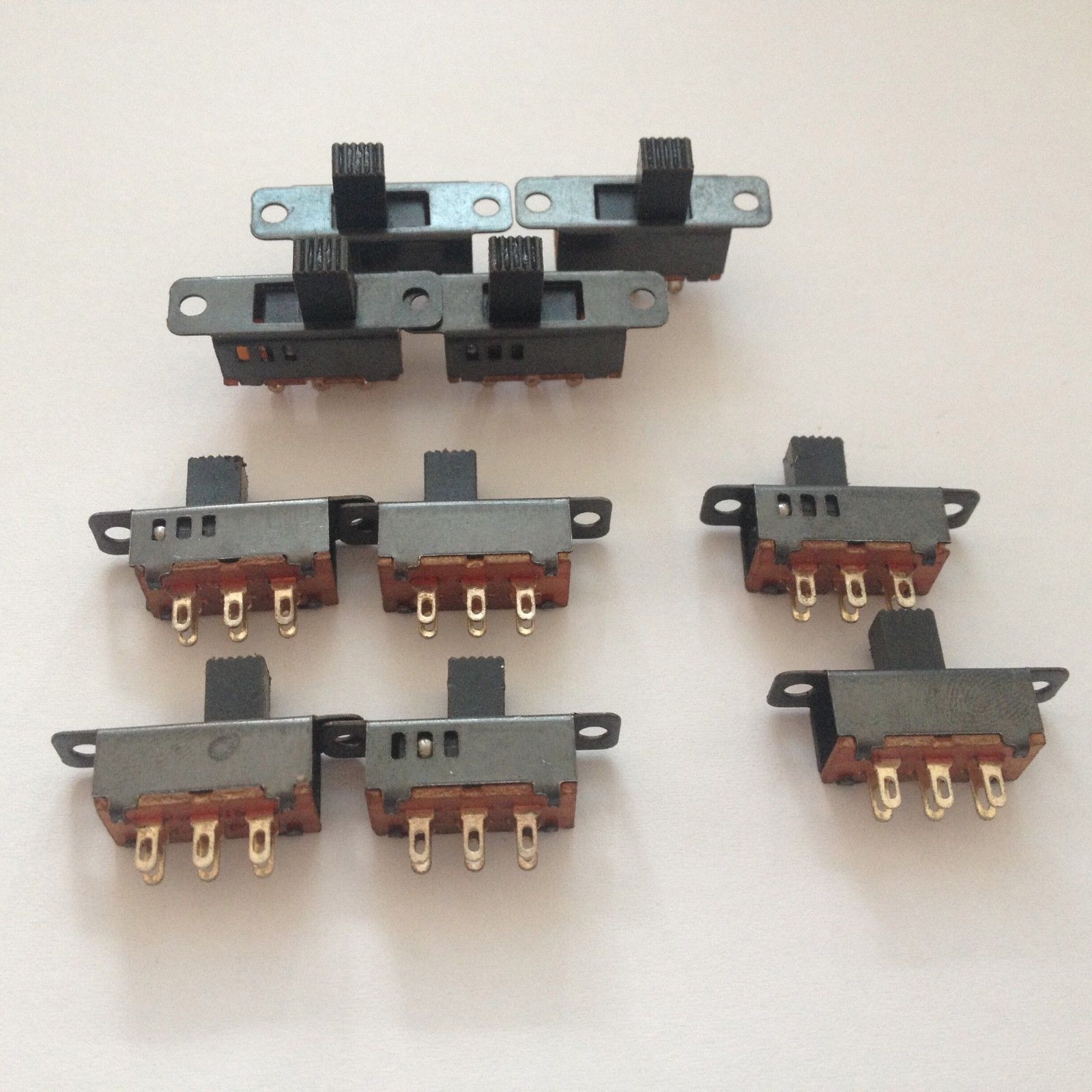

piedwagtail
Joined: Apr 15, 2006
Posts: 297
Location: shoreditch
PostPosted: Mon Aug 31, 2015 4:59 pm    Post subject: Reply with quote  Mark this post and the followings unread
I just bought these (see attached)10 for £1.92, which were far cheaper than toggles and I hope a little more heat resistant than the cheapest Chinese toggles can be when soldered. I figure solder mounted above the pcb, I can use the holes(maybe expanded) to hold the programmed and run leds (or run/program and end of loop leds).They are center off.
have a reset/off/on/tie version
please explain.
 Filesize:  294.73 KB
 Viewed:  559 Time(s)
