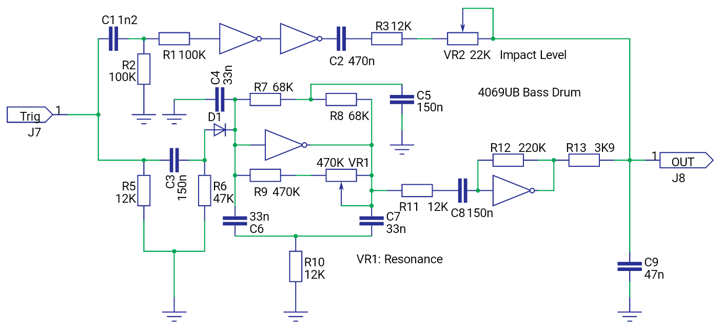

PostPosted: Tue Feb 16, 2016 9:18 am    Post subject: Elektor Drum Reply with quote  Mark this post and the followings unread
I've been experimenting with that Elektor Drum circuit that YuSynth posted on: Wed Aug 27, 2008 11:57 pm
Have made some improvements.
1. Have increased the resonance of the twin T circuit which subsequently overdrives the amplification stage that follows. The resonance pot effectively determines the level of overdrive in the next stage.
2. Have created a second path for the impact part of the sound, the level of which can be adjusted by a pot

PostPosted: Tue Feb 16, 2016 1:45 pm    Post subject:
Subject description: Further developments of the Elektor Drum
Have made further improvements to the Elektor bass drum. I'd hoped to build a VCA with one of the 4069 gates, tried using a vactrol to make a variable gain amplifier with the 4069, but attack time was just a bit too slow. In the end I conceded and used the trusty Roland VCA with npn transistor and an opamp.

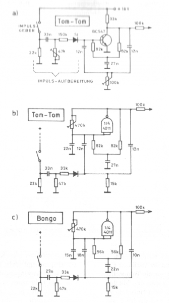

PostPosted: Thu Feb 18, 2016 11:29 am    Post subject: Reply with quote  Mark this post and the followings unread
from the archive
edit
better scan quality in the attached pdf

PostPosted: Fri Feb 19, 2016 3:07 am    Post subject: Reply with quote  Mark this post and the followings unread
@g.gabba thanks
4011 doesn't seem like the obvious choice. I wonder if there's any sonic difference when using a 4011 rather than an inverter like 4049 / 4069. Will probably try both and see if there is a difference.
What book did you get these from?

PostPosted: Mon Feb 22, 2016 3:02 am    Post subject: Reply with quote  Mark this post and the followings unread
hi gasboss775,
its was german book from the library about repairing elektronic instruments, think it was from "FRANZIS",
may the 4011 was more common (= cheaper) in the time the book was written ?
cheers
