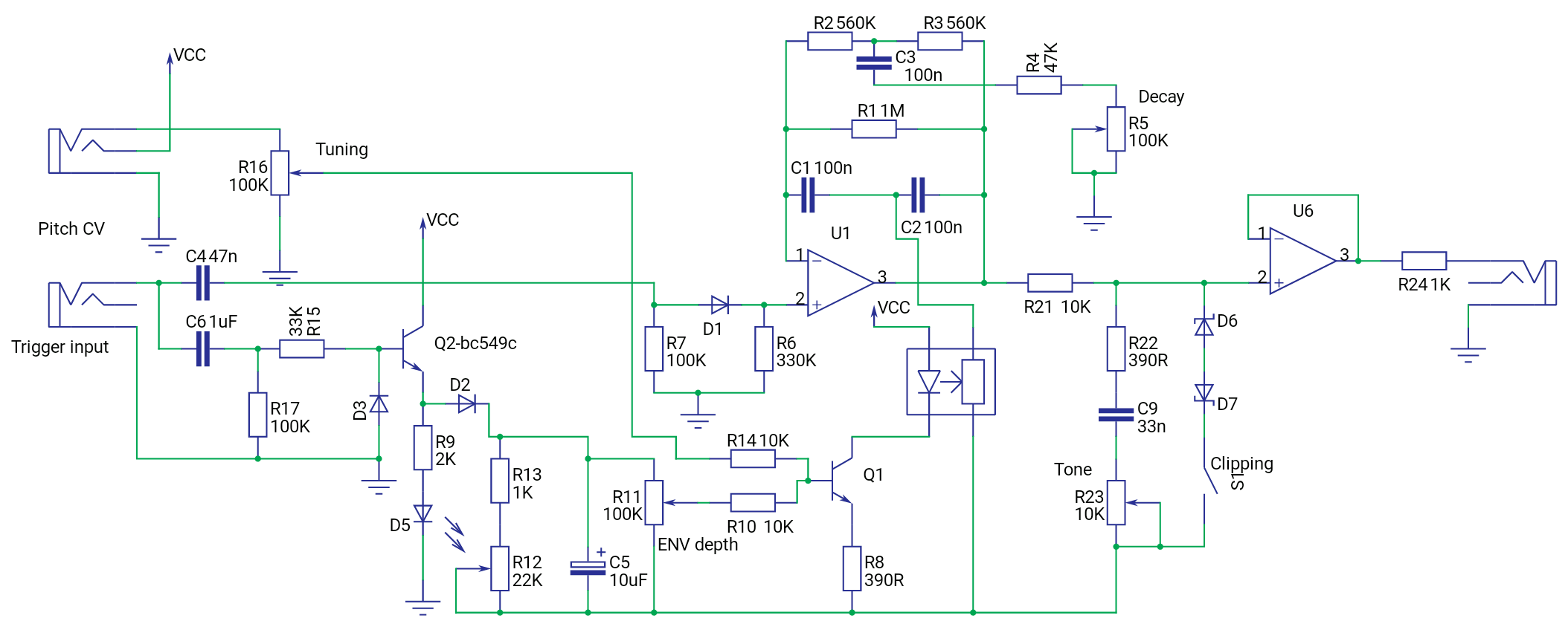

PostPosted: Thu Mar 03, 2016 12:13 pm    Post subject: Twin T Bass Drum Reply with quote  Mark this post and the followings unread
This is the latest version of a Twin T / Vactrol based Bass Drum that I have developed with Muff Wiggler user PWM.

PostPosted: Thu Mar 03, 2016 11:36 pm    Post subject: Reply with quote  Mark this post and the followings unread
No more CMOS? Very Happy
Must give that vactrol vca a try, I wonder about the response.
Edit: o wait, that vactrol influences the resonant frequency, interesting, sound samples?
Any who, great work!
