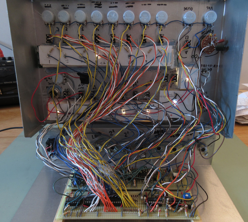

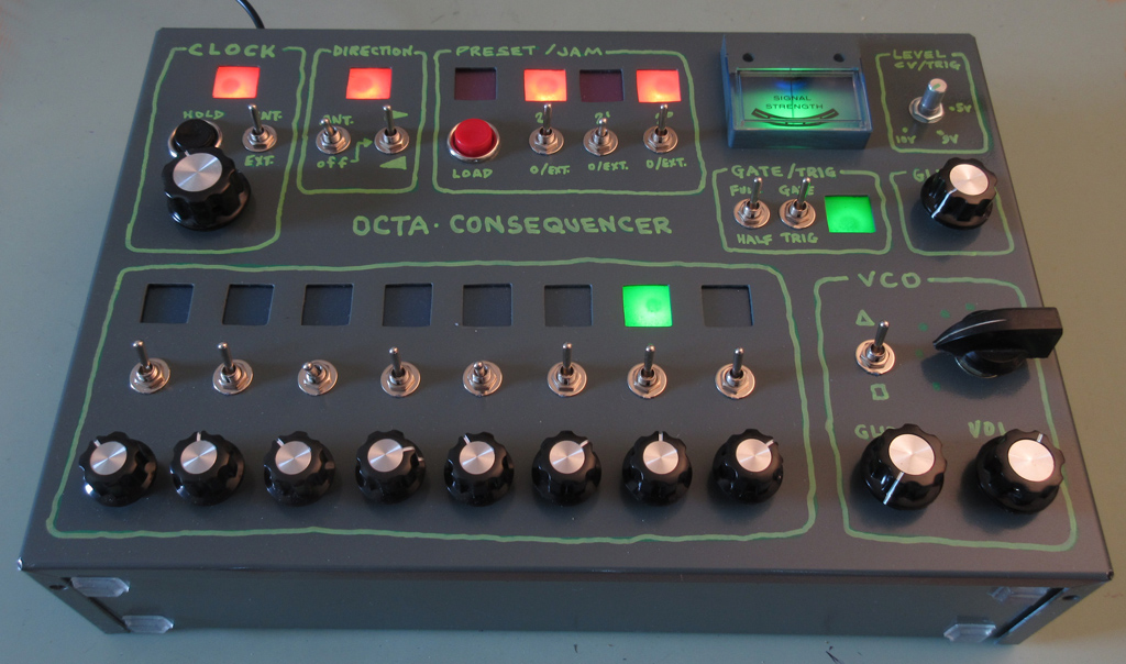

Finally had some time to document this project, pretty much finished a month ago...
The Octa Consequencer is an 8-step analog sequencer that outputs a control voltage (CV). It's got the usual step on/off and one can set the CV value for each step. The clock speed can be adjusted and there is a hold button. It has a built-in triangle/square VCO with a separate glide control and output. Other outputs are raw CV, CV with adjustable glide (portamento) and gate/trigger. The gate has 2 flavors, either ANDed with the clock thus appearing at every step or remaining on whenever a step is on. Trigger output is the same thing but a short pulse.
This was originally inspired by Dr. Offset's 16 step Up/Down sequencer (it made a great impression on me back in 2010 when I first started getting into electronics, but at the time I didn't see the use of a sequencer). The details of the schematic I filled in from other designs like like the Baby 10, MFOS, etc. Instead of the CD4029, I used the similar CD4516 CMOS presettable counter with a CD4051. Thus one can control the direction, as well as reset the counter to a specified binary value. The clock, direction, preset load and preset value can all be set by external gate signals for extra madness.
For the direction, an "antenna" mode can be selected. This basically makes the up/down pin on the counter chip floating, and it behaves erratically/randomly and responds sometimes to moving one's hands near the box. Fun!
The square windows for the LEDs were made by hand using a nibbler tool, and then behind, isolator/light concentrator boxes made out of cardboard, hot-glued to the enclosure, with some layers of parchment paper for diffusion, colored gels and translucent plastic.
The VU meter shows the CV level for fun, and is illuminated from inside.
I found this build pretty daunting... at some point I was not sure I wanted to finish it, because I just couldn't figure out how to organise the wiring and stuff. Finally I just went for it... it's a bit of a mess inside, but it all works.
Here is a demo video: https://youtu.be/_ZhCQe6FwxU
.:James:.
the mess inside the Octa Consequencer.
The Octa Consequencer.

that looks great!
love the square lights Very Happy
PostPosted: Sun Mar 27, 2016 3:54 pm    Post subject: Reply with quote  Mark this post and the followings unread
You have a real gift for design, RingMad. The outside and the functionality are more important than the guts of the wiring (at least until you have to troubleshoot it! Very Happy ).
Posts: 5884
PostPosted: Sun Mar 27, 2016 4:45 pm    Post subject: Reply with quote  Mark this post and the followings unread
oh I just noticed your meter is smiling Laughing

Re the Octa Consequencer...
Thanks folks!
elmegil : Yeah, it took me about a week to debug that mess of wires!
PHOBoS : The meter is smiling at YOU because I got the circuits that handle the external gate signals from one of your schematics Smile. (You know, so that even boxes that produce low-voltage gate signals can work with my box which is using 12V).

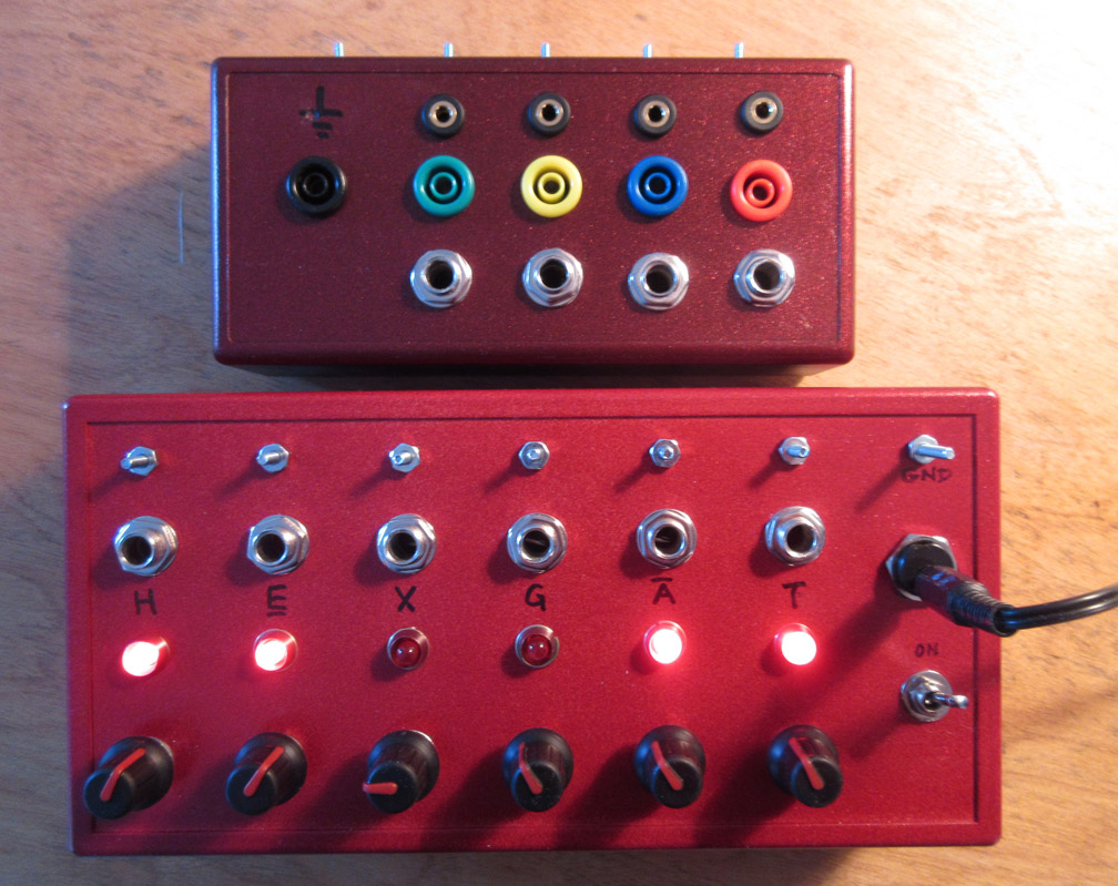

Solder never sleeps... Just quickly made a couple of utility boxes that don't make sound but are handy.
FACEMULT: allows MULTiple (4) separate signals to be interFACEd between 4 styles of connector: 1/4, 1/8, banana and bolts. Handy for interfacing with other synth systems.
HEXGĀT: produces 6 simple gate/clock signals with adjustable rates (from approx 0.2 - 18 Hz) and 1/4 jack outputs and bolts for use with alligator clips so as to communicate with breadboards. This is simply 6 square-wave oscillators made using a CD40106 chip. It was one of those oh-what-the-hell-i'll-put-it-in-a-box type things, but probably I should have thought about it a bit more and put switches on each gate.

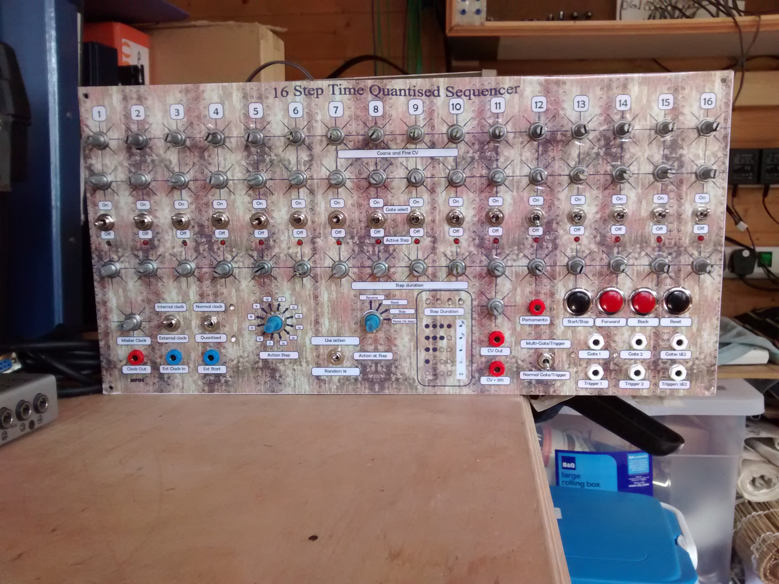

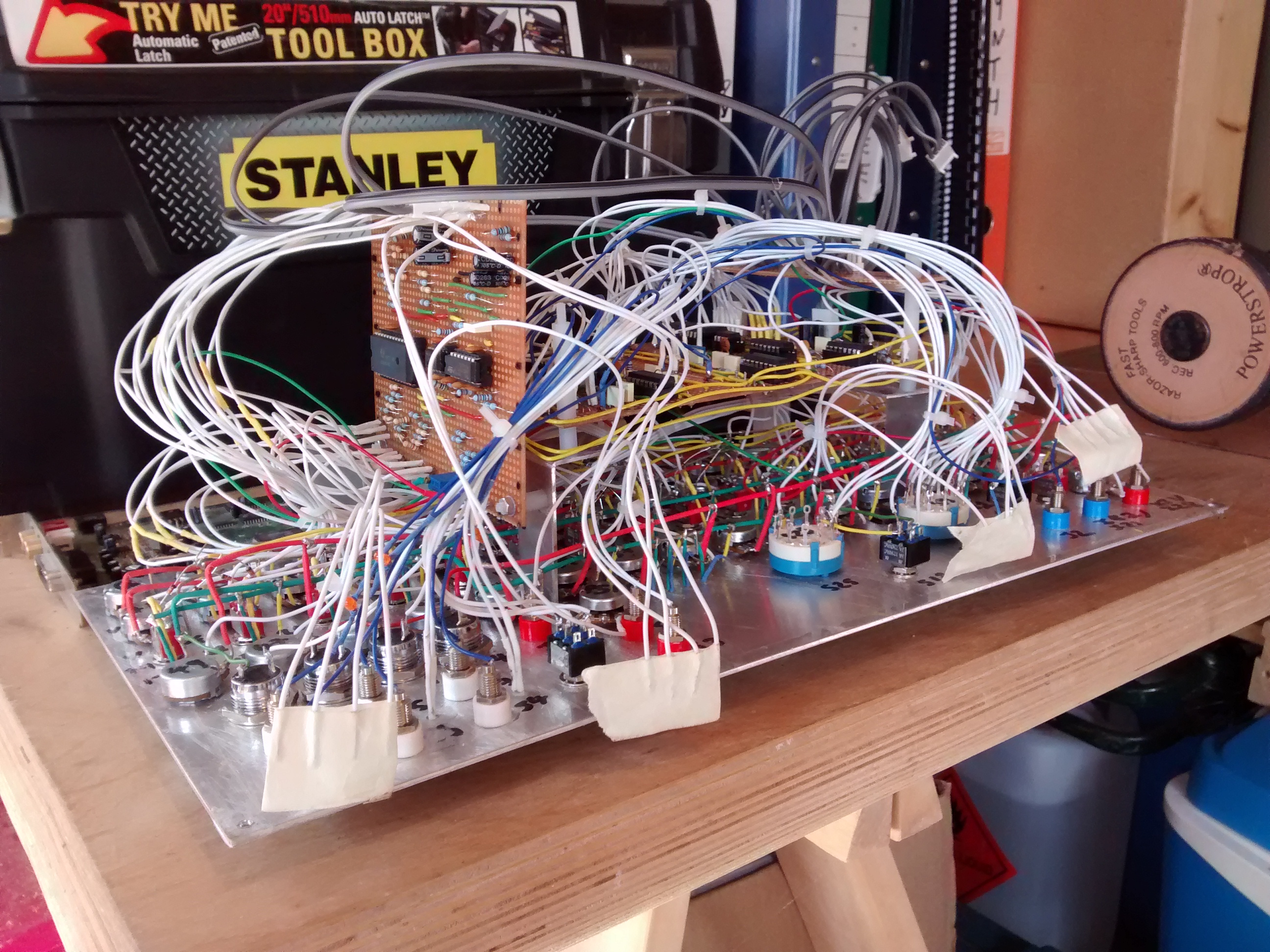

Two-thirds of the way through building Ray Wilson's 16-step quantized vari-clock sequencer. Analogue and Digital boards installed and working, just got to build the vari-clock board...
One weird quirk - in reverse mode, the clock runs about 30% faster than in normal mode. No idea why, and haven't bothered to debug as the clock on the digital board will be removed once I've built the third board.
Modded so there are two gate busses available, and also (since I had a spare half op-amp) an output of CV+a 5th.
Biggest panel I've made to date.

wow... looks very nice and impressive plus i've spotted stripboards... Very Happy
did you made all the blocks for this sequencer on stripboard? Well i'm asking as i for myself always use stripboards and if you managed it to get everything assembled i'm probably giving it a try too... i have a smaller case waiting to be filled and maybe all needed jacks, pot's and boards may fit into it... but usuallly i stay away from builds that wouldn't fit on one of the stripboards i have (100x150mmm or 100x200mm).

Thanks!. Yes, all my modules are stripboard (except for the Klee). I buy 119 x 455 mm lengths and cut to size (Rapid Electronics in the UK). This makes all my boards 46 rows deep, which fits nicely with my 200mm high panels. This sequencer is a rather massive build - three main boards plus a small distribution board for power and interboard connections (QA-QD). But as usual Ray's excellent descriptions make debugging easier.

119x455mm stripboard i have never seen before... well should finish in my actual clocking/timing build the second pulse divider from Ken Stone, one is already complete and mounted as is the master divider and 2 Gate sequencers, plus few logic elements and gate to trigger converters i spread over the spare places on those boards...
but it would be really great to have a sequencer with variable gate length... i think i must give this a try before starting something else...

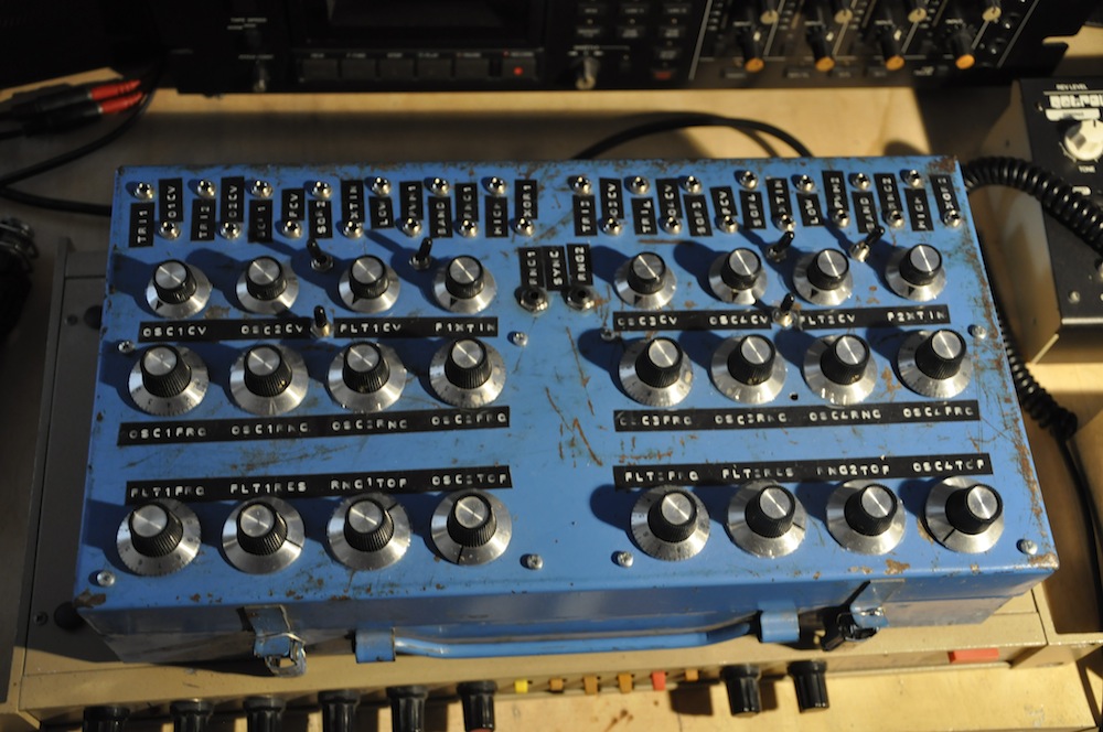

PostPosted: Sun Apr 10, 2016 9:28 am    Post subject: Reply with quote  Mark this post and the followings unread

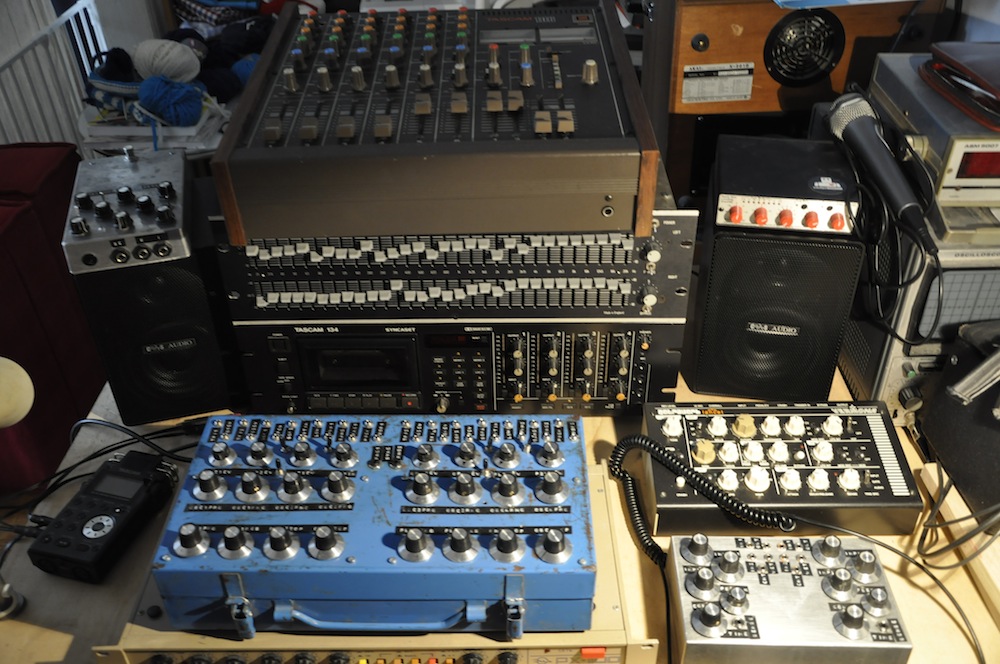

Nice sequencers, ringmad and prgdeltablues, highly masochistic looking, but also totally awesome!
I´m finally putting together a little lofi experimental studio, after having to sell all my stuff due to financial breakdown.
Just kept my Jazz bass and the stuff on the 1st picture.
Phoenix from the ashes Wink

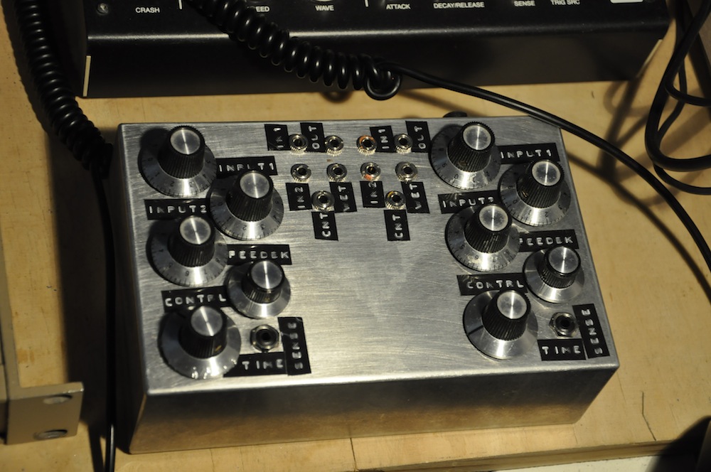

My small Hordijk system (double Wink ):
Twinjolin (Dual Benjolin)
Zuzweitgeist (Dual Zeitgeist)

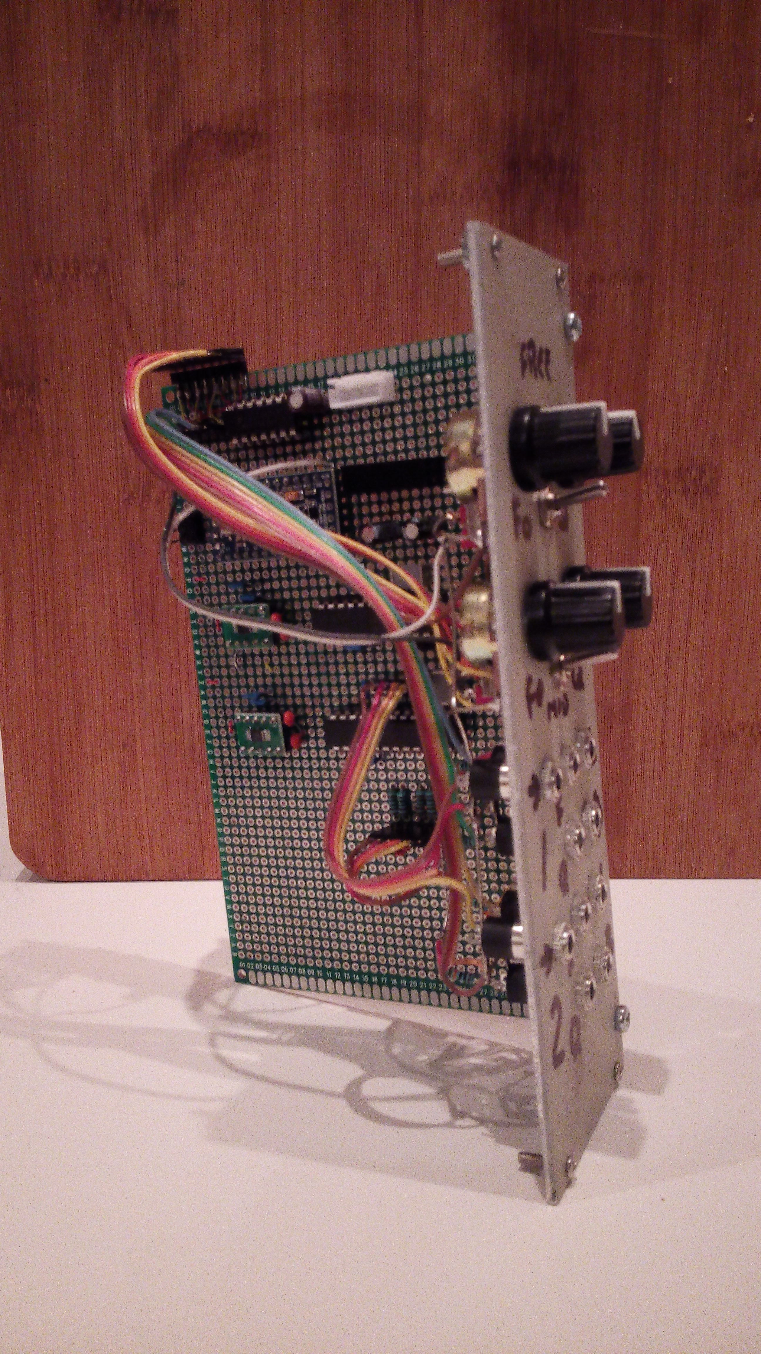

My first full analog module: a four channel basic mixer.

What's that component near the power connector, a DC-DC converter?
Posts: 1320
PostPosted: Mon Apr 18, 2016 2:21 am    Post subject: Reply with quote  Mark this post and the followings unread
Yes, I power my modular with 5volt, and this mixer is powered by 9volt pos and 9volt neg. derived from 5 volt.
