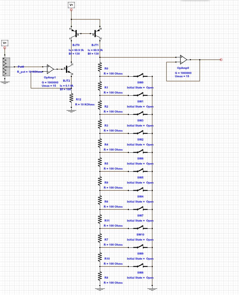

PostPosted: Thu Apr 14, 2016 4:10 am    Post subject: Reply with quote  Mark this post and the followings unread
The downside of this approach is that you will sound off-tune when you press more as one key.
Thinking about this, I produced the following diagram.
NOT TESTED! Just for considering...
 Filesize:  175.11 KB
 Viewed:  2221 Time(s)

Hi grumble. It is actually low note dominant. It does play the lowest key you are pressing in tune.
I got the (resistor chain in the feedback loop) portion of the schematic from the EFM keyboard converter schematic.
I can't get my mind wrapped around how it is low key dominant. If anyone can help with that I would greatly appreciate it.
I will give your schematic a try Grumble and post back with results. It looks promising. Thanks for posting it.

I like your schematic grumble. Am bread boarding it now. It appears it will be high note dominant as drawn.
Posts: 1320
PostPosted: Thu Apr 14, 2016 7:42 am    Post subject: Reply with quote  Mark this post and the followings unread
Sorry, made an ERROR forgot a connection (line in RED)

I tried it out grumble. I didn't get it working.
The constant current supply voltage showed up at the collector of the first PNP. (The one on the left) but not at the collector of the second PNP
I used 2n3906 PNPs
2n 3904 NPN
i tried a different constant current source I have made up for experimentation, got voltage tracking. I was looking at it bacwards earlier. Is low note dominant as shown in your schematic. Switching the resistor chain ends would also require switching to an inverting op amp configuration to make it high note dominant. Just switching wires would make low notes high, high notes low.
It needs a trimmer in the feedback loop of the output op amp to adjust the span to track correct.
Let me know if I'm wrong on any of this.
I hate bread boarding. So easy to miss something over a loose contact. But I'm pretty sure the span adjustment will be necessary.

Got it working.
Grumble (YOU ARE THE MAN!!!) works great. I'm still trying to figure out what's at work in the method you used to adjust the span. I was just seeing that as a voltage adjustment for a constant current supply.
Can you toss a comparator in for a gate signal in your schematic?????
I have already added one, but my chicken scratch hand drawn schematic won't be near as legible, and I'm sure your solution may be better than mine.
To masterofstuff . I don't see why a resistor ribbon type system wouldn't work on either of these.
On a 44 key keybed GRUMBLES schematic was easier to get tracking good, and is a little more linear using the exact same resistor chain key-bed

PostPosted: Thu Apr 14, 2016 10:01 am    Post subject: Reply with quote  Mark this post and the followings unread
Cfish wrote:
Got it working.
Great! You can use the same comparator as in your org. schematics.
I'm at home and don't have the program here (btw its a free program).
You got that right! And it even works better with an FET, because the base current is added to the total current in the current mirror (the upper two pnp's)

PostPosted: Thu Apr 14, 2016 11:41 am    Post subject: Reply with quote  Mark this post and the followings unread
Thanks grumble that is awesome
I had to pull away from this before I had the comparator for the gate working right.
I think I deeded to switch the trim and pitch voltage inputs, seeing my original schematic goes low On key release ( voltage below lowest key)and your circuit goes high on key release ( voltage above highest key). Is my thinking correct on that?

PostPosted: Thu Apr 14, 2016 1:21 pm    Post subject: Reply with quote  Mark this post and the followings unread
to be honest, i just wanted to post an idea and i havent even thought it thru...
but youre right, the voltage goes low after release of the keys, another proof of my lack of focus Shocked
i hardly do analog design anymore these days, most digital, i think its more predictable...
i have built several keyboards, but all with an Arduino clone as the heart of the thing.
in my synth(s) i dont use a v/oct type of control, but a serial line presenting the pressed key which i modulate digital and/or analog.

I wanted to post this Ken stone schematic here in case anyone wants to try it out.
I did it in a set of bass pedals. It worked ok but had a little key lag. I think that was a problem with the generation of IC I had. But I haven't done enough research to confirm that.
(Update) this circuit was talked about on another thread and prgdeltablues noted that the data sheet calls for x10 value difference between the capacitors on pins 5 and 6 not x22. And the minimum values are 100n and 10n.
The minimum values worked on a set of quick momentary switches I set up. But may not be enough debounce for other switches.
 Filesize:  1.2 MB
 Viewed:  916 Time(s)
