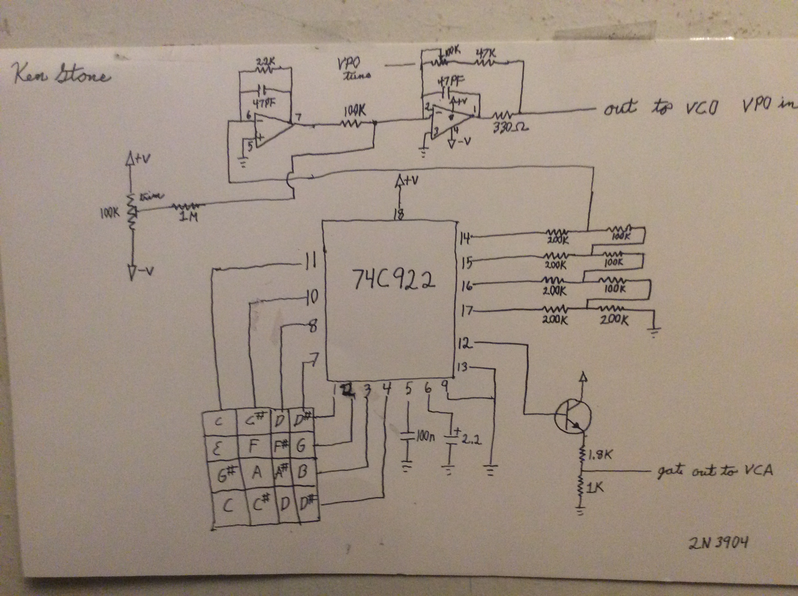

I have built one controller for a key bass using a Ken Stone schematic that uses a 74c922 key matrix IC. But the circuit is to slow.
I have built a circuit from an old EFM schematic, but can't seem to get the gate and trigger to work on it.

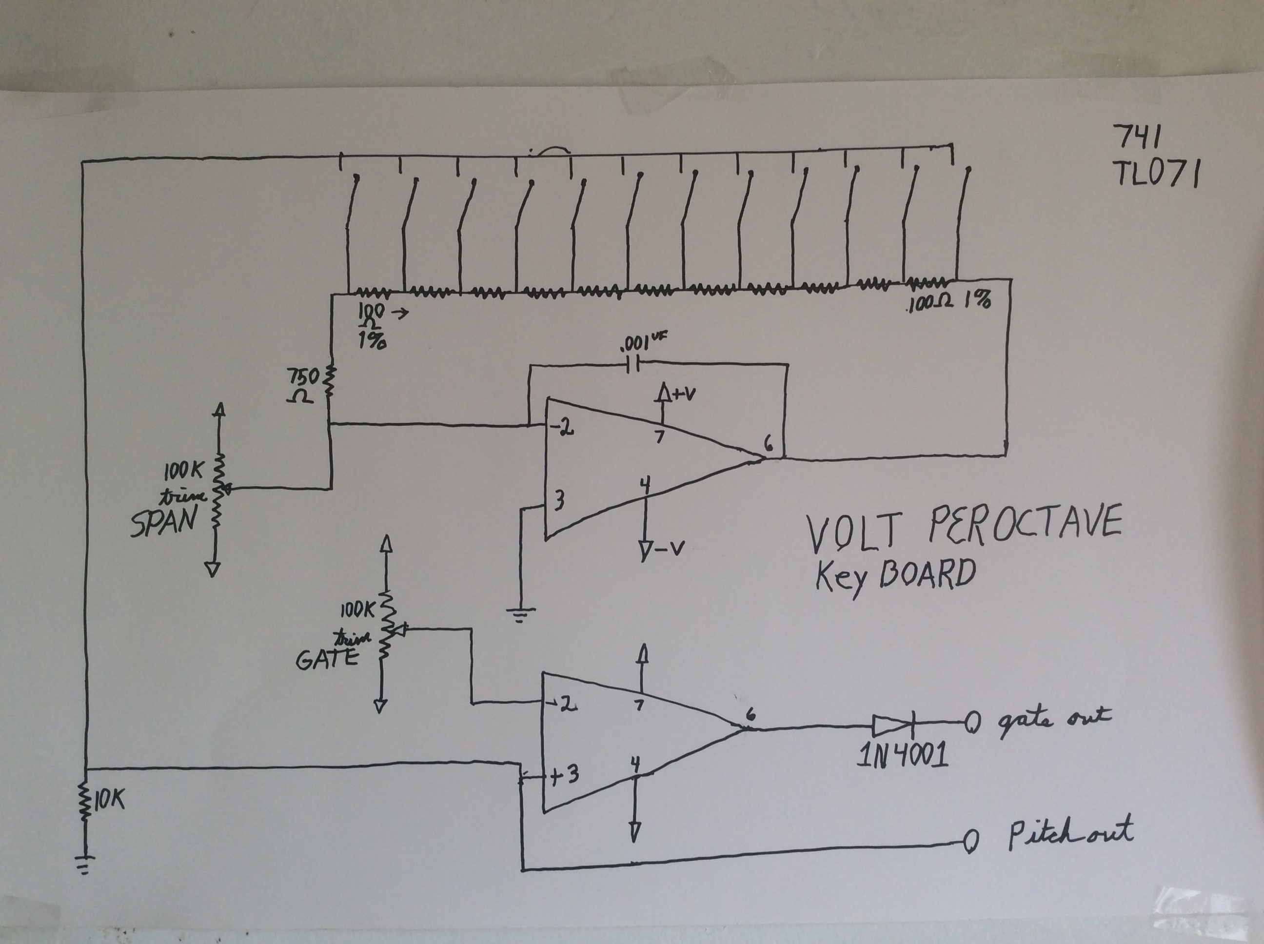

Just in case anyone else was looking for something similar. This is what I finally got working. I'm sure I didn't invent in, but I sure couldn't find an easy solution that worked when I built it.
This works on my bass pedals and a 2 octave keyboard project I did.
(Update) when I tried this with a TL072 it caused an issue. I believe the heat caused by the comparator/gate side of the dual opamp caused a temperature drift issue in the voltage control side of the IC. I couldn't keep the span in adjustment.
(Another update) I have used this circuit all winter long in a set of bass pedals and a 2 octave controller with no problems. Turns out the radiant heat in my house is very stable at 72 degrees. Spring is here and the house got up to 78. And the span drifted substantially.
I have ordered some opamps with better drift ratings to try. I will post back with results.
I have high hopes for the OP177 op-amp. At first glance it appears it may go right in the IC socket and has much better temperature drift ratings.
I spent a couple of hours fighting that new TL072 circuit before I finally realized I wasn't trying the other circuits when it was that warm in the house.
(Update) OP 177 opamp cleared up the temperature issues.
Great thing is you can build this with IC sockets, try it out with TL071's, or something you have, and buy the pricier OP177s if you need the accuracy.
I believe the OP177s were about 2$ each American at Digikey.

I have seen a guy use cut up, medium gauge guitar strings soldered together (push down to contact the buss bar) to make a test keyboard.
If your 100 ohm resistors aren't 1% the note spacing may not be correct. I used. 5% in one project but matched them with a good ohm meater
Good luck with it. It's a little tricky to get the gate trimmed just right. But it's fun when you get it going.

The downside of this approach is that you will sound off-tune when you press more as one key.

Hi grumble. It is actually low note dominant. It does play the lowest key you are pressing in tune.
I got the (resistor chain in the feedback loop) portion of the schematic from the EFM keyboard converter schematic.
I can't get my mind wrapped around how it is low key dominant. If anyone can help with that I would greatly appreciate it.
I will give your schematic a try Grumble and post back with results. It looks promising. Thanks for posting it.

I wanted to post this Ken stone schematic here in case anyone wants to try it out.
I did it in a set of bass pedals. It worked ok but had a little key lag. I think that was a problem with the generation of IC I had. But I haven't done enough research to confirm that.
(Update) this circuit was talked about on another thread and prgdeltablues noted that the data sheet calls for x10 value difference between the capacitors on pins 5 and 6 not x22. And the minimum values are 100n and 10n.
The minimum values worked on a set of quick momentary switches I set up. But may not be enough debounce for other switches.
 Filesize:  1.2 MB
 Viewed:  799 Time(s)
