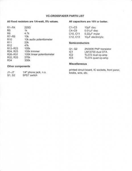

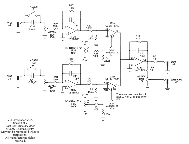

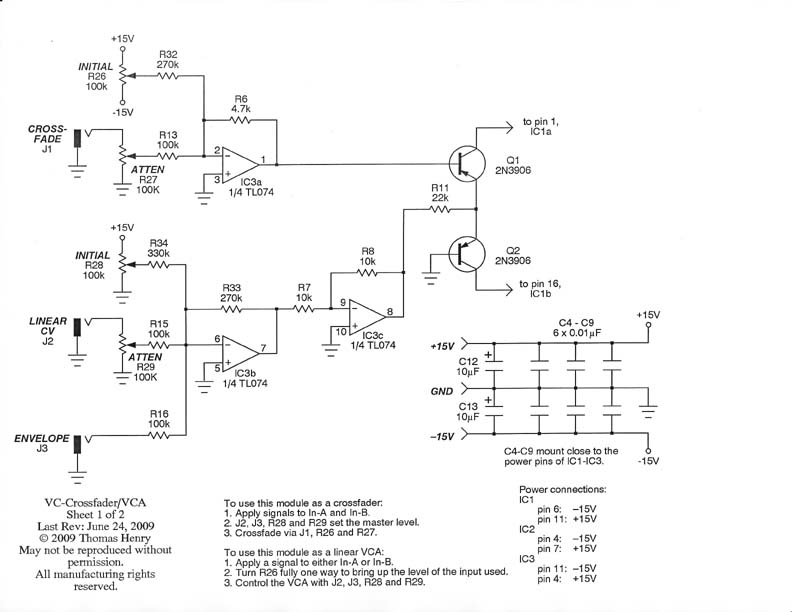

Hi Gang,
As promised, here is another circuit for you to play with. It can be used either as a voltage controlled crossfader or as an ordinary VCA. I hit upon this when finally realizing something that was in front of me all the time---the control currents though the voltage-to-current converter are symmetric yet opposite. It's an obvious idea once you see it and has probably been used before. But I was glad to stumble upon it.
Null out the DC thumps in the usual way. (Turn the audio inputs down, then apply a 0 to +5V square wave to the CV input.)
The usual legalese applies. Feel free to use this for personal applications but don't copy, or produce commercially. Anyone wanting to do a non-commercial PCB for EM users please contact me first.
Have fun!
Thomas Henry

Hi all,
I would like to use this great circuit as a voltage controlled mixer (crossfader option on sheet 1 above). Because the master level would always be set to maximum level, and envelope control would not be needed, the whole branch to the left of R11 (between Q1 and Q2) seems unnecessary for a crossfader-only use. Am I right?
What would I have to replace that branch with? Do I need the buffer (IC3c) or can I just supply +15V via some resistance to the point between Q1 and Q2? What would that resistance be?

No, I didn't. First, I've got plenty of other unfinished business to do, and second I dropped the voltage controlled mixer from the design.

I've found a minor mistake in the crossfader/vca schematic. On the schematic pin 13 of the TL074 is labelled as the non-inverting input and pin 12 as the inverting input whereas it should be the opposite. I was actually building a dual version of vca-1, wich is very similar, with lm13700 and using both schematics got me stumbling on this anomaly.

Thanks for pointing that out.
To be clear, everyone, the pinout in the schem is correct, so build away! Only the plus and minus signs in the op-amp representation of IC3d are reversed.

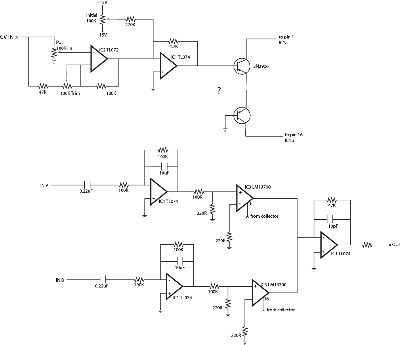

Hello everybody,
I want to build a small circuit wich allows me to feed back the normal output and the inverted one of a filter back to its input by a voltage controlled crossfader. So i want to have a knob which has no output in its middle position,
full ccw would be the inverted only (which also means no output at the output;-) ), full cw would be the normal output. And I also want cv control over the crossfading, where the knob acts as a starting point for the cv...
I want to leave as much as possible, but I don't know how to deal with that amp stuff thats going to in between the two transistors...
I already left the ac/dc switch, and the attenuators at the inputs, as well as the dc offset trimmers, as i will use it only for audio. And i added an attenuverter at the cv in...
don't know if that all makes sense and what to do with the input at the transistor, maybe i could only leave the initial gain pot as a trimmer, but to what value do i have to trimm that? or can i somehow set a voltage right at the transistors and get rid of the opamps there...
thanks so much for any advice
i used 20k there (from +12V).
