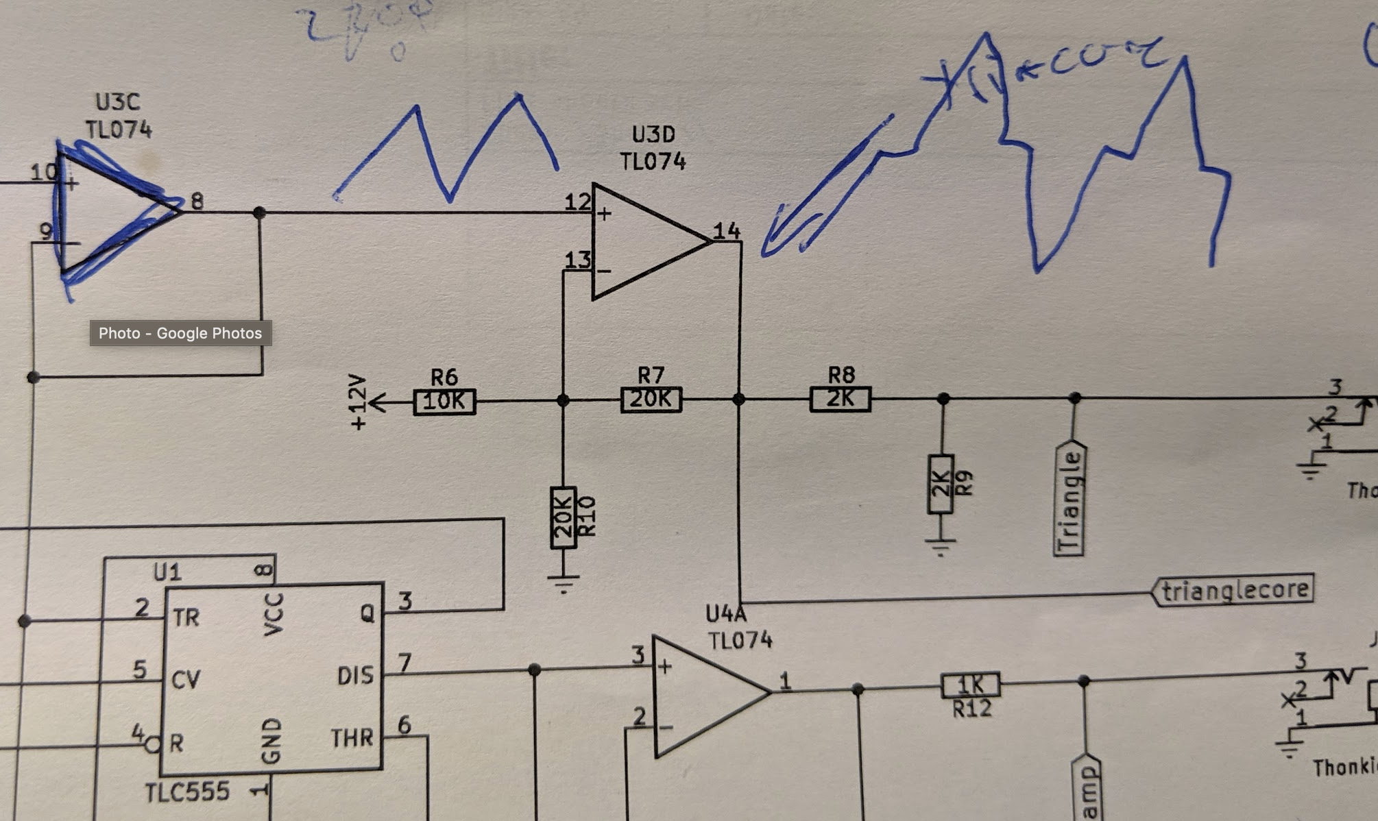

PostPosted: Mon Sep 09, 2019 5:59 am    Post subject: Cross-over distortion from 3 to kHz-something Reply with quote  Mark this post and the followings unread
Okay, so I revisited this design. I have quite a few posts in this thread were I saw this distortion that looks something like cross-over distortion. Well, since my last post I've changed out _everything_ and by everything I mean:
* redesigned entirely new pcb. smd this time so no basically no component from same batch as before.
* new PSU (already tried with two different last time around, but now a third Smile )
So I mean, every single component is new from before. And I see the exact same behaviour. From around 3kHz it's visible and at 5kHz it's very much so.
I think the problem stems from the triangle core and all other output stages are just affected as a consequence. It's most visible in the square wave at high frequencies since the slew basically turns it into something like a triangle.
I've tried adding a 1K load-resistor to ground on all opamp-outputs but couldn't find anything obvious.
I'm thinking of three possibilities:
* I've missed to change some critical value to make this work for 12V instead of 15V.
* The kind of 7555 I'm using is not fit for this design.
* This is all as designed, I'm just picky with my scope.

hedefalk, not sure if you're still looking into this. While reading through your posts I noticed that the link for the TL074s you are using was to a Chinese supplier. Nowadays any IC you order from China is a potential fake. I've been there. Have stopped ordering ICs from China altogether a while ago.
My instant guess when seeing the pulse slew was that these op amps could possibly be re-labeled LM324s.
It's curious that when you put in an LM324, the behavior did not change. The typical slew rate of an LM324 is 0.5V/us, 40-50 times slower than a TL074. When I try to do the math, with the output voltage of the pulse comparator having to go from -12V to +10V and back (for a LM324), at that slew rate you'd end up with a triangle at around 11kHz.
Edit 2:The slew of the pulse output is only affected by the output op amp and the components (resistors) around it. Not by the triangle core.
Edit: You mentioned going to all SMT with your latest iteration. Where did you order the SMT TL074s?
You could easily test the slew rate on a breadboard with something like a simple 555 based square oscillator of 10kHz or so, and buffering the output with one of your TL074. With real TL074 the output should still be close to a square.
As a side note, quad through hole op amps are on their way out, more so than duals. I've personally used fonik's PCBs for both of my VCO555s (which both work fine), and I've still been seriously considering doing my own PCB using only dual op amps, which would also enable using an LT1013 or OPA2277 for the expo converter (much lower offset voltage, more precise expo conversion).
Dan
Thanks for feedback! I really do think you're right and I kindof reached the same conclusion after starting another thread on the Eurorack DIY facebook group for my smd design:
https://www.facebook.com/groups/436675570022014/permalink/907079852981581/
Thing is that my last batch is a roll of 100 pieces on a roll, looking legit. It just seems so strange to me that they can make any money off of relabling if it would involve that kind of packaging?
https://www.aliexpress.com/item/32845424969.html?spm=a2g0s.9042311.0.0.27424c4dnyzcZX
It's a fine looking cut strip of 100 from a reel. Bought the same for tl072 too:
https://www.aliexpress.com/item/32842901258.html?spm=a2g0s.9042311.0.0.27424c4dnyzcZX.
But they really do seem to have LM324 specs for slew. Could it be factory rejects or just some other kind of supply chain weirdness all the way back at the factory? They are just creating LM324 but with TL074 casing back at the plant?
Anyway, I'm gonna order strips of 100 from digikey or mouser on my next order and compare.
