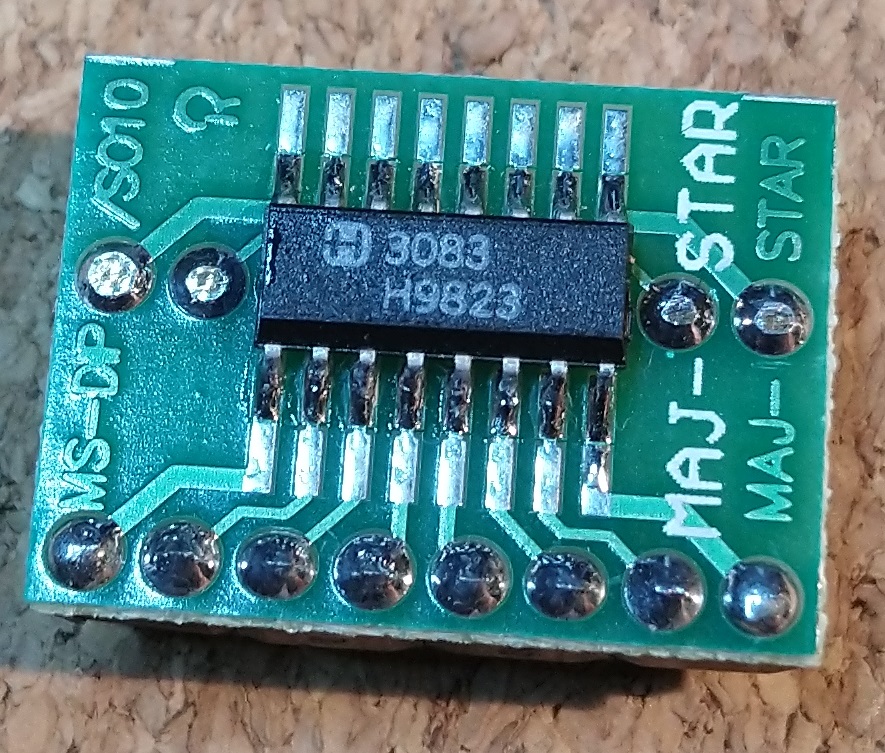

Subject description: How to make SOP14-16 to DIP adapers to fit into IC sockets - simple
1. Simple adapter.
This adapter is cheap and simple to make - only drawback is asymmetric look and footprint.
First solder pins. To get pins in line you may put them into IC socket before soldering. Remember about correct diameter of pins. Cut out soldered pins from the IC side. Wash pcb with isopropyl alcohol. Then solder IC. Wash pcb again.

PCB for simple adapter.
 Filesize:  495.86 KB
 Viewed:  274 Time(s)
Simple adapter completed - top.
 Filesize:  336.83 KB
 Viewed:  291 Time(s)
Simple adapter completed - bottom.
 Filesize:  259.06 KB
 Viewed:  286 Time(s)
