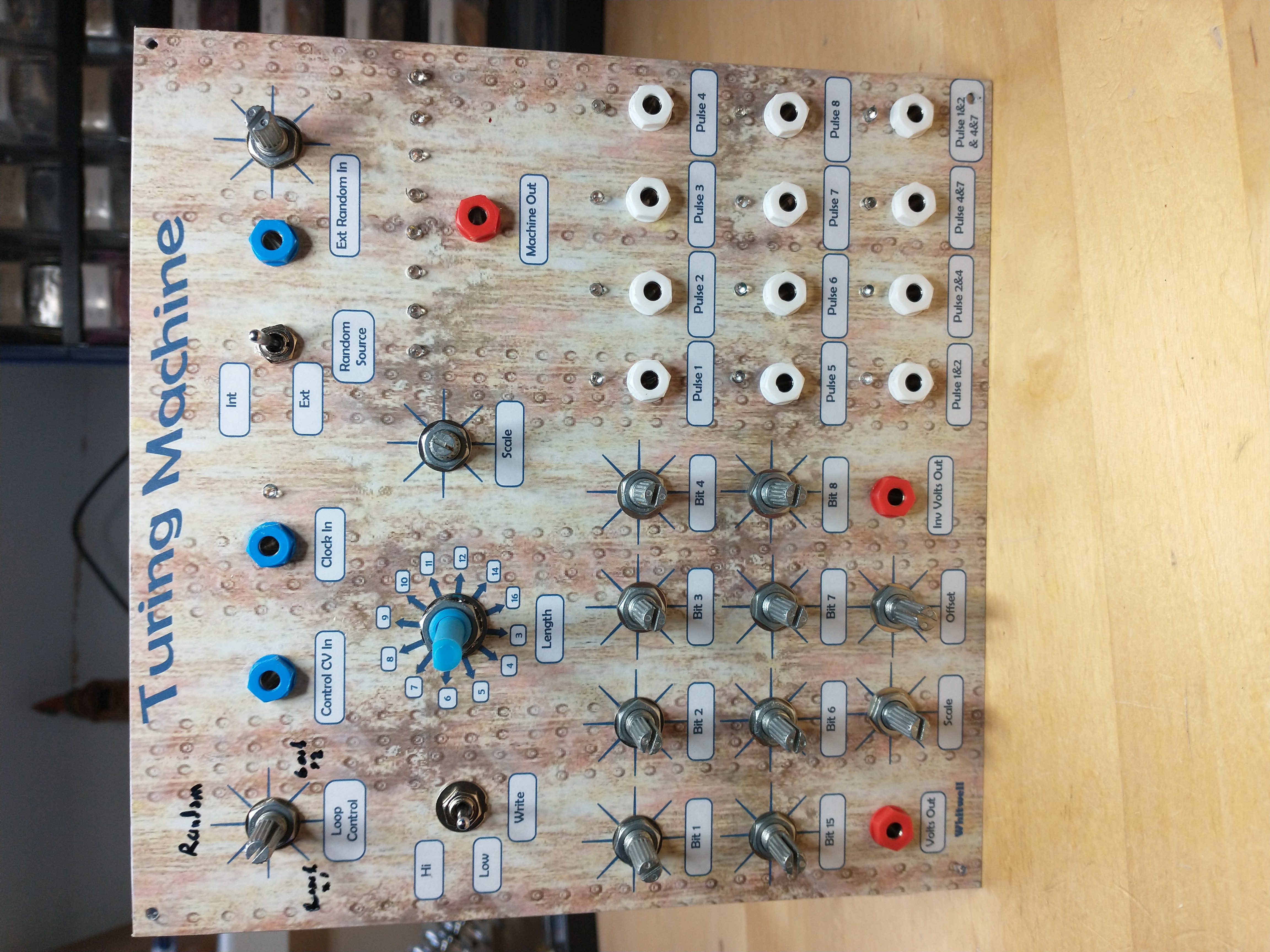

Turing Machine (MKII) with integrated Volts and Pulses expanders and a few mods.
Be interesting to compare this with the CGS Infinite Melody and the Klee.
(For some reason, the images have been rotated in posting...)

Nice panel & turing machine Psynth Smile
is that a rivet pattern on the panel art, looks great

Thanks, yes it's an image of the side of a shipwreck; wooden knobs when I get round to making them complete the look.

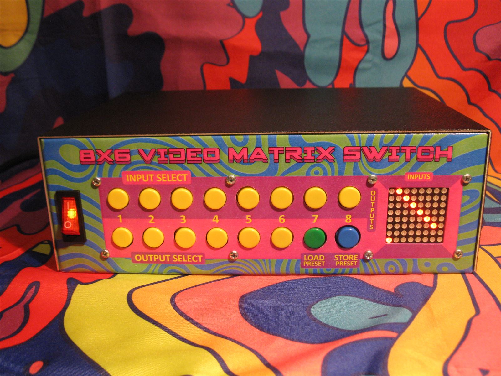

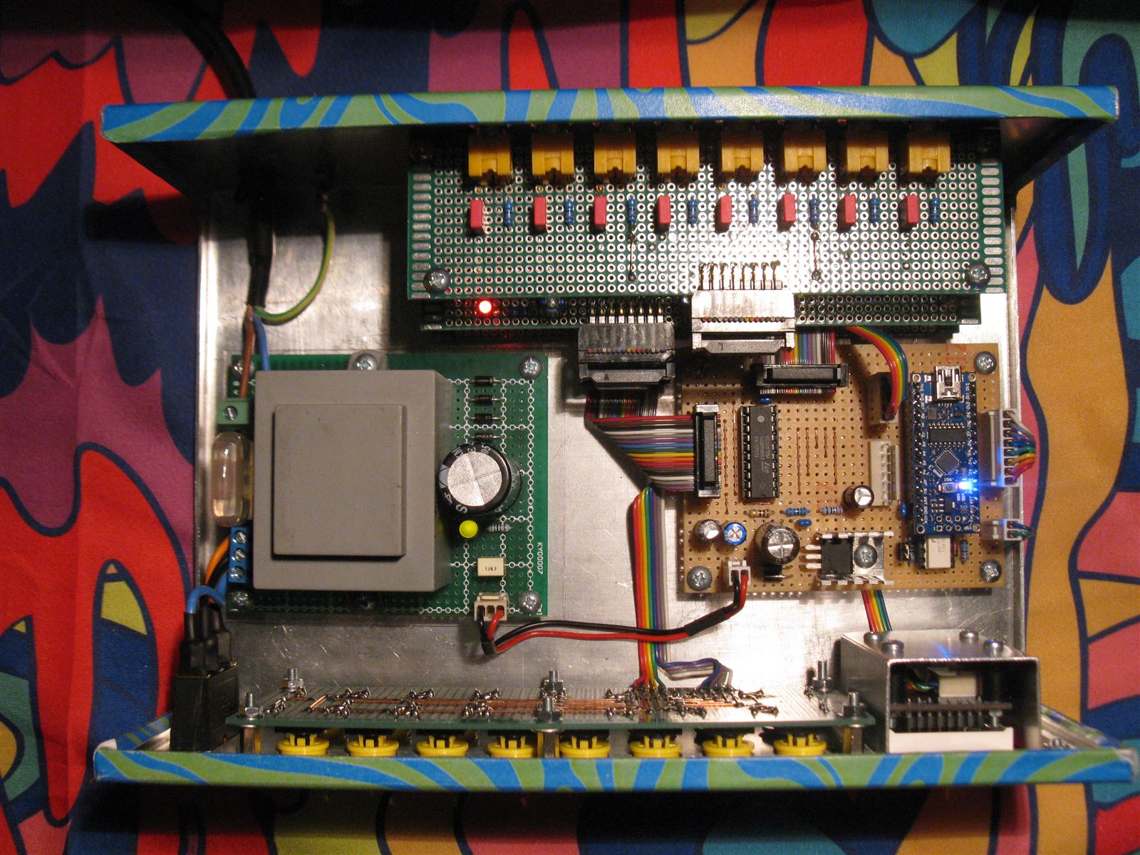

an 8x6 Video Matrix Switch build around a TEA6414A which I apparently desoldered from something some time ago.
I guess it is not completely finished though. The AC voltage turned out to be a bit higher than expected and with 2 active video
outputs the regulator is already getting too hot to touch. Luckely the enclosure is made of metal so I'll mount it to that and hope
that will be sufficient.
edit: I did that and have been using it without any problems.
more info here
