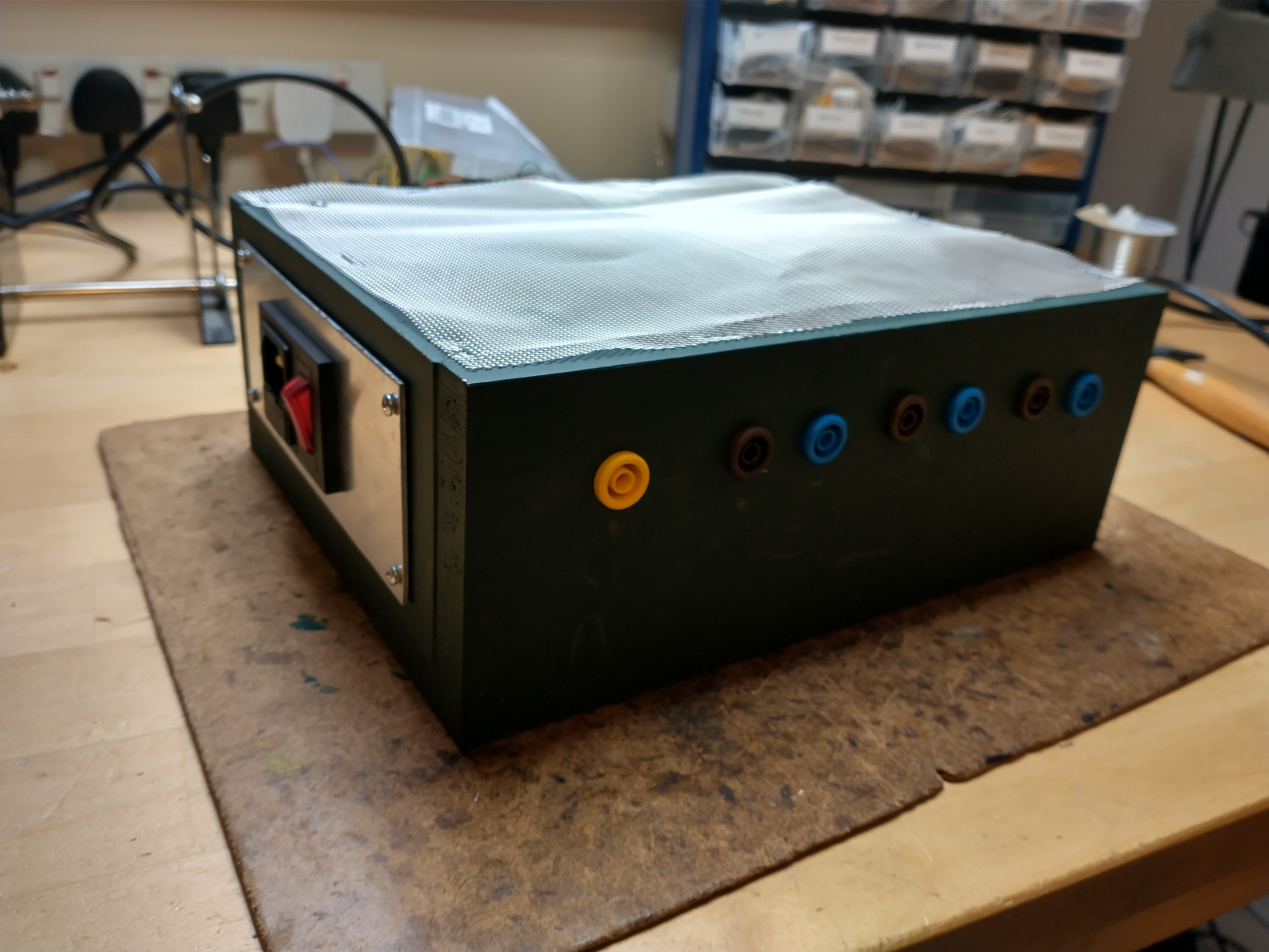

Finally built a transformer-based power supply, until now I've used Ray Wilson's wall-wart based system. Enough current capacity for three of my cabinets.

That looks pretty grunty! I'm picking the mesh is to provide airflow for the heatsinks?

Should be able to supply 1A on both +12V and -12V from each of the three regulator boards. Yes, the mesh is for airflow, and is of course safety earthed (before anyone asks).

Heh, that one is visable in the top image.
Nice box - at first wondered what the yellow output was for, but then realized that there is just one ground connector - probably.

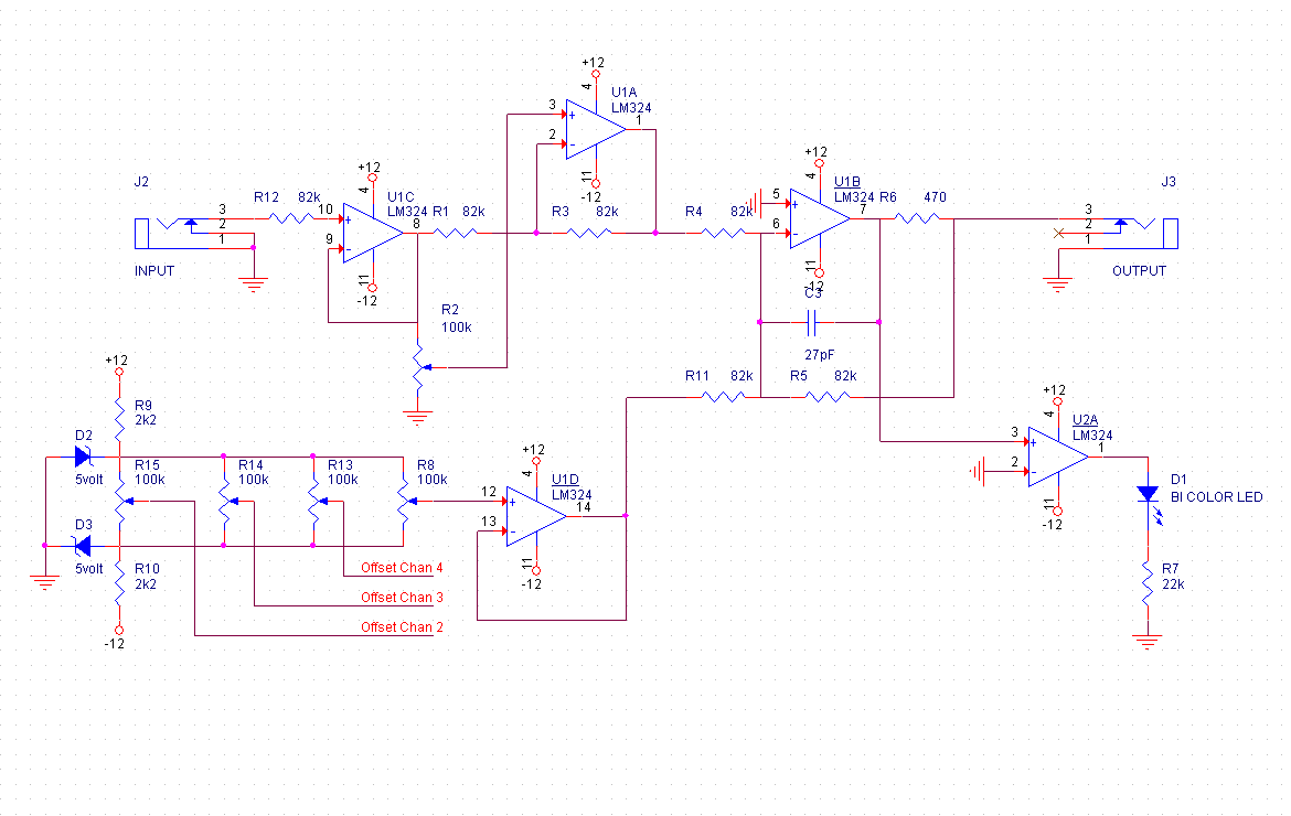

Euro Quad Attenuverter with offset and polarity indicator.

Interesting... I take it the opamp buffers for the LED and the offset are to make it as bulletproof as possible?

Thanks, but no, the opamp before the LED is a comparator and the purpose of the offset opamp is twofold: it is there to enable the use of the zener diodes.
By applying a buffer connected to the wiper of the offset pot, the impedance as seen by the zener diodes is 100k / 4 = 25k independent from the positions of the wipers. If I didn’t use buffers there, turning one wiper would influence all other offsets.
Secondly, by using a buffer the impedance as seen from the -input of U1B does not change by moving the wiper of the offset pot, so the amplification by U1B is constant and unaffected by the position of the offset wiper.
