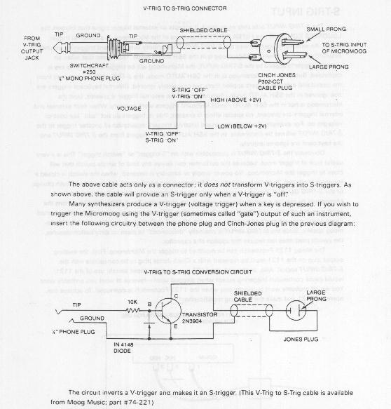

I don't know if your hip to this soundlab stuff, but I was trying to use
the trigger for external gate(to no avail). Probably because of s\trig
They had to be different didn't they.
"your stripes are killer bro"
deknow
Joined: Sep 15, 2004
Posts: 1307
G2 patch files: 15
PostPosted: Fri Jul 15, 2005 8:06 am    Post subject: Reply with quote  Mark this post and the followings unread
yes, if you need a voltage trigger, the x911 won't work without a converter of some kind. on the x911, the trigger shorts tip to sleeve. here is a copy/paste from a synth diy list (found using google). i think this was done by my friend mark. it may take some work to get it all straight. (it seems to distort a little in the pasting), the original can be found here (it's a little clearer).

This will produce a voltage

Made a screen dump of the schematic.
Jan.
schematic for s to v trigger conversion

PostPosted: Fri Jul 15, 2005 8:48 am    Post subject: Reply with quote  Mark this post and the followings unread
thanks jan, that makes it a little more helpful. here is a page from some moog documentation (i hope there isn't a serious copyright issue) with the opposite....vtrig to strig.
deknow
