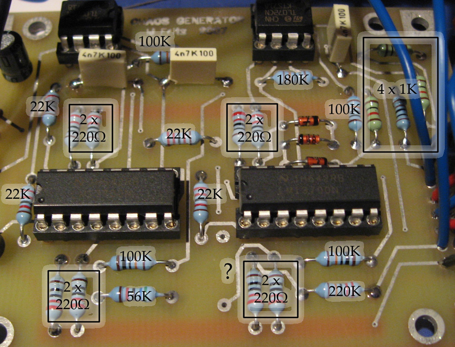

PostPosted: Sat Dec 08, 2007 10:41 am    Post subject: jerkster trouble Reply with quote  Mark this post and the followings unread
finally got round to building my jerkster. unfortunately it just seems to generate DC - the level varies depending on the pot positions but it doesn't move on its own.
while assembling it there was a space on the board for one component that doesn't seem to be on the schematic... might this be related? have i missed something here?
thanks!

PostPosted: Sat Dec 08, 2007 12:25 pm    Post subject: Re: jerkster trouble Reply with quote  Mark this post and the followings unread
Hi bear --
I'm glad you got the time to build this. It looks like you did a nice neat job. We should be able to get this running without too much trouble.
I checked your photo directly against a working board and it all looks OK. Just to check one thing -- please make sure C1 isn't shorting against the trace that goes under it.
The extra resistor -- R29 -- is not needed to get the circuit working. It's for making a small offset adjustment that sometimes is necessary (see #3 on the docs). It's shown on the schematic directly above U3A, and on the stuffing diagram it is notated as optional. I suppose there is a chance that you have a previous version of the docs that doesn't mention R29. If so, just let me know. But don't worry about it for now.
All I can suggest right now without further details is to go over the pot wiring very carefully. Note that I have used (1) for the CW terminals (2) for the sliders and (3) for the CCW terminal. Your PS voltages are probably OK if you are getting a trace. But be sure to remember to double check them.
Meanwhile, I'll fire this board back up and give you some pot settings to get started. You will not get oscillations for all combinations of settings.
I'll be back with you later.
Ian

PostPosted: Sun Dec 09, 2007 10:23 am    Post subject: Re: jerkster trouble Reply with quote  Mark this post and the followings unread
lol well spotted Ian; of course that's exactly what it was.
Cheers! Very Happy

PostPosted: Sun Dec 09, 2007 11:01 am    Post subject: Re: jerkster trouble Reply with quote  Mark this post and the followings unread
bearblock wrote:
Cheers! Very Happy
t
Wow, glad it was that easy. Thanks for posting such a clear photo. So it's wiggling away?
Ian
