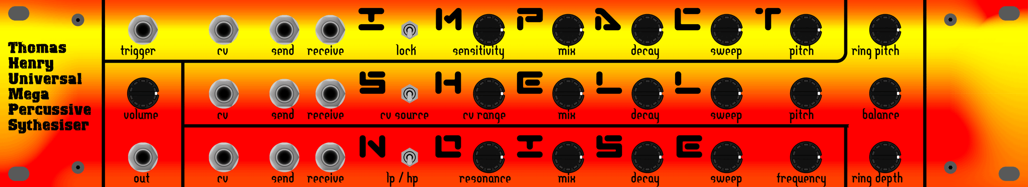

PostPosted: Thu Jan 31, 2008 5:06 am    Post subject: Reply with quote  Mark this post and the followings unread
Here's an idea of where my front panel is at so far.
You can see I've improved at drawing sockets! Very Happy (compared to the switches)
Still very rough, haven't decided on a font yet. Thinking about the overall layout, wondering about extra CV ins etc.
I'm pretty happy with the direction it's taking though.
PS, the colour won't stay like that. I was just mucking around with what can be done.

PostPosted: Tue Feb 05, 2008 4:37 am    Post subject: Reply with quote  Mark this post and the followings unread
A lot closer to finished now.
Playing around with fonts, man, it's always hard to decide on a font combination.
I tried changing the background back to white, but the yellow/orange is starting to grow on me! Laughing
Any suggestions, praise or questions welcome! Very Happy

Dan Lavin
Joined: Nov 09, 2006
Posts: 649
Audio files: 21
PostPosted: Tue Feb 05, 2008 6:10 am    Post subject: Reply with quote  Mark this post and the followings unread
Unc,
looks great! I dig the colour scheme, too! Just make sure you put the "N" in synthesiser before you commit to metal!

Thanks Antman! It's amazing how easily spelling takes a back seat when you're looking at the "big picture". Very Happy

PostPosted: Wed Feb 06, 2008 6:37 pm    Post subject: Reply with quote  Mark this post and the followings unread
Hey Unc,
That is a very cool panel. Cool Your soul has obviously been psychedelicized.

Thomas Henry
Joined: Mar 25, 2007
Posts: 298
Location: Southern Minnesota
PostPosted: Wed Feb 06, 2008 6:58 pm    Post subject: Reply with quote  Mark this post and the followings unread
This would be a fairly difficult project to ergonometrize, but I think you've done a great job of grouping things logically.
Since the trigger input belongs to all three subsections, as do the volume control and output jack, I wonder if they shouldn't be grouped together. There's no change in drilling, just a matter of extending the section delimiter line to group the input/volume/output together.
Just an idea...

PostPosted: Wed Feb 06, 2008 7:20 pm    Post subject: Reply with quote  Mark this post and the followings unread
Yeah, I thought about that, but I figured the trigger is the initiator of the circuit, as the impact is of the drum. Besides, the sensitivity and trigger lock are on the top row. And, I just put the trigger LED next to it, where that line would have been extended. Very Happy
Thanks heaps for the feedback though. I thought you two were lost in MIDIworld. Laughing
