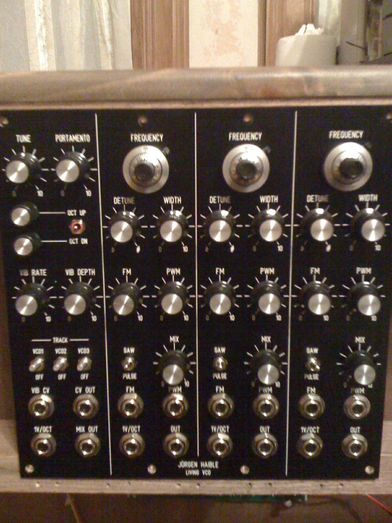

PostPosted: Sat Aug 22, 2009 8:30 am    Post subject: Reply with quote  Mark this post and the followings unread
I just finished my fully decked out Living VCOs module and it's all looking great! I just wanted to make sure, though, that I'm not getting any locking among the 3 VCO circuits, since I daisy chained the power supply. If I were, I wouldn't be able to slightly detune the VCOs, right? Either by ear or on the scope I wouldn't notice them beating or on the scope they would be either totally in sync or one of them would look like a hard-sync'd waveform, is that right? If so I think I'm good, since I'm not seeing that and I am able to slightly detune them and they stay out of tune, but I want to make sure.
I'll post some photos next week - my wife is out of town with the camera at the moment.

PostPosted: Sat Aug 22, 2009 9:16 am    Post subject: Reply with quote  Mark this post and the followings unread
It would be pretty much as you describe it.
JH.

Ok, my wife is back with the camera, but it's busted. So here's the best photo I could get with my phone.
EDIT: Was having problems inlining the image from the web so attaching to this post.
