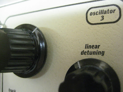

The Bad Producer wrote:
Whereabouts did you get the frequency knobs and the linear detune knobs from? They look great!
The Bad Producer
Joined: Mar 08, 2009
Posts: 282
Location: The Manhole
PostPosted: Sun Sep 05, 2010 12:36 pm    Post subject: Reply with quote  Mark this post and the followings unread
The linear detune knobs are Davies 1910CS :
http://www.alliedelec.com/search/productdetail.aspx?SKU=5431916
The frequency knobs are Davies 1610AA:
http://www.alliedelec.com/search/productdetail.aspx?SKU=5431610
Both available from Allied Electronics, they do lots of other nice knobs too!
