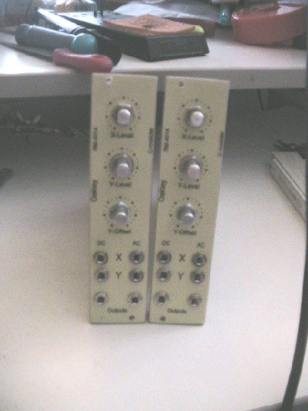

VCS with front..

Serge VCS with front..
Gorgeous!!

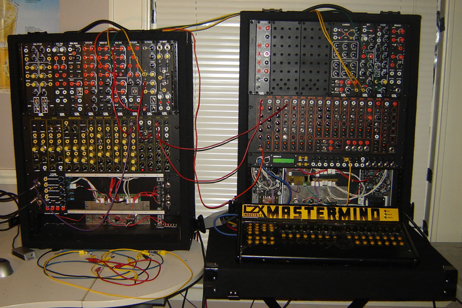

Been meaning to post a pic for a while, but these two cabinets are my progress since last August. The one on the right is a modular drum machine in progress. The sequencer is my MIDIbox SEQ3.

Looks great! Do you have any close up shots of the panels?

wow,yes can we see a close-up from the modules at top right in the right cabinet,those design seems very pro
could use it as inspiration Wink

wow, Lars...thats too sexy for my pants. nice work.
Ditto on the close-up.

Thanks so much for the feedback! I will take some more detailed pictures of the individual modules soon -- and I'm very happy to share any of the silkscreen artwork if anyone wants it. I am pretty happy with this mixed format/spacing -- my only gripe is that the black knobs/jacks have a tendency to blend in with the black panels in low-light. Having the rack-cabinet flexibility has been very nice.
Here's some more info...
Both cabinets were custom built using hardware store materials plus case cabinet hardware/carpet from http://www.reliablehardware.com. They have lids which latch on, and also double as table-tops for keyboard stands (you can see one of them being used this way in the pic.) They are 14U tall and about 7.5" deep (+3" with lid.) The lids are deep enough to not interfere with patch cables, which is very nice -- I can patch it up before a gig. They probably cost me $100 USD to build and I'm happy to share information with anyone attempting something similar.
All the modules are completely DIY except the Blacet Quad Mix/VCA in the bottom left.
Colored jacks are inputs, black jacks are outputs, white jacks are logic/trigger/gate ins/outs.
MOTM Modules in left cabinet, left-to-right:
Dual XR-VCO
Ian Fritz Dual S&H
Dual Noise w/CGS Digital Noise & MFOS Noise Cornucopia
ARP4075 LPFA
Bubblesound SeM20 VSF retrofit
Dual Mixer (CGS boards)
Serge VCS
Digisound 80-13 External Input
MOTM Modules in right cabinet, left-to-right:
PT2399 VC Delay (not working very well -- going to get replaced)
2x Drilled panels for Thomas Henry MPS!!!
Thomas Henry Clangora
Thomas Henry UD-1
CGS Cynare
Drum Mixer (custom module, going to be rebuilt since I added new midi-to-trigger distribution)

WOW, amazing setup there, glad to see the drum synth is going well Very Happy

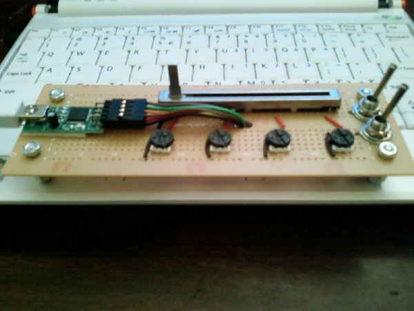

I've posted this photo elsewhere, but I guess it won't hurt to post it here also. One day I wanted a controller for my ChucK programs, but I'm poor as dirt and can't afford to buy one. I did, however have a U-HID nano board from www.ultimarc.com as a result of working with them on a project. So I searched through my parts drawers and found a slider some thumbwheel pots and two switches, just enough to max out the I/O on the little U-HID nano board. Plus I found one of those old Radio Shack protoboard thingies and some standoffs. Long story short, I built the thing shown below.
Tonight in about six hours it will make it's debut as the microphone and demonic vocoder controller for The ChucK Show on electro-music.com radio. It's nothing compared to the masterpieces that you folks are creating for your synths, but I like it, and it's cool that I had all the parts on hand so it cost me nothing.

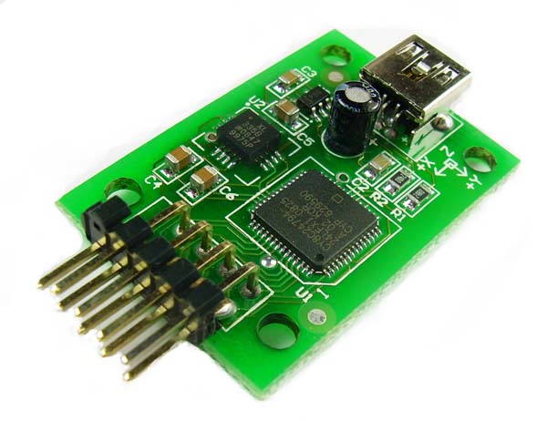

OK, along the same lines as the controller that I just posted is the board shown below, the U-HID G, also from www.ultimarc.com. It's kind of a cinderella story, I wanted a three-axis accelerometer on a USB interface so I figured out how to make one and on a whim I sent an email to Andy at ultimarc asking if he would like to add it to his product line. To my astonishment he said "Yes"!
So I helped him get started and wrote a bunch of ChucK software for it's use with guitars as a motion-based effects controller. It took forever to get the accelerometer chips because Analog Devices was selling all they could make for use in the Wii mote controller. Eventually, however, we got the chips and now I have one of the prototypes. It works great! I like to call it the "Accelerometer on a Stick", haha.
It was a fun project and I'm happy about it mostly, though due to the economy, I think, sales are slow. Sigh. Oh well it's a cool product and I had tons of fun working on it. DIY mania ensues!

TekniK, both your stainless steel module and the Serge modules are AWESOME! Great job! Cool

This looks great -I am studying a MEMs unit next semester, am hoping it will inspire a few designs for synth use
Thanks John,don't sure if i gonna keep the stainless steel module like that or let manufacture a finished example of it.
the serge one are the finished product

TekniK, where did you get your dual concentric pots for the VCS modules?
