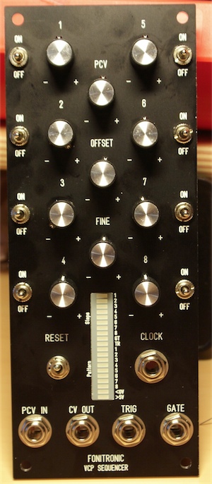

magman wrote:
Here's my first attempt at a panel for this PCB in MOTM format (or almost).
It's a little busy, but I think it would work.
I like it. I think I prefer this with the small knobs.

Here's my MOTM Version (which i am currently working on the PCB side).
MOTM VCPS

diablojoy
Posts: 809
Location: melbourne australia
PostPosted: Mon Aug 23, 2010 6:08 am    Post subject: Reply with quote  Mark this post and the followings unread
got my first VCPS running not quite finished completely but along with everything else it is getting there slowly
by the way fonik orsm seq this is so much more than expected
a short noodle to follow, well maybe not that short Laughing
