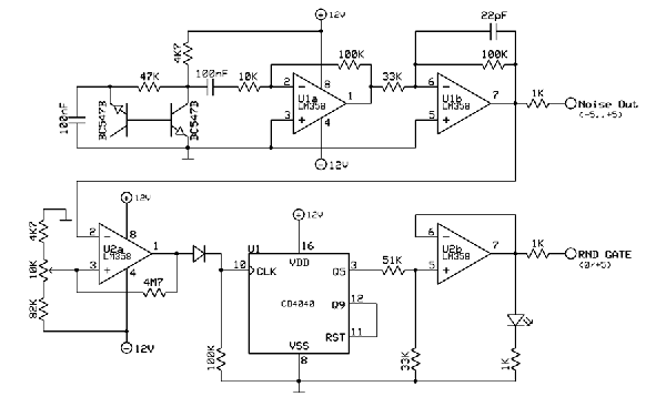

another thing I added is a noise source. The actually noise generator with the 2 transistors is something I found online (I think it's posted
somewhere on this forum aswell) and I added 2 opamps to boost the signal to -5V..+5V.
I've also started on the frontpanel design to get an idea about how much space I have and what I can put in. I had a free space for one jack
and a knob which I probably won't use for anything else, so I decided to transform the noise into a RND gate signal. A comparator with
adjustable treshold level turns the noise into a RND squarewave. This is divided with a CD4040 to get a useful range which is followed by
a voltage divider and buffer to turn it into a 0/5V gate signal.
Since I added the RND gate part later I used two dual opamps, but you could use a single quad opamp of course,. (LM324)*
* I did a quick test with an TL072 but the output level was higher, so some resistors would have to be adjusted when using that one.
Noise & RND gate

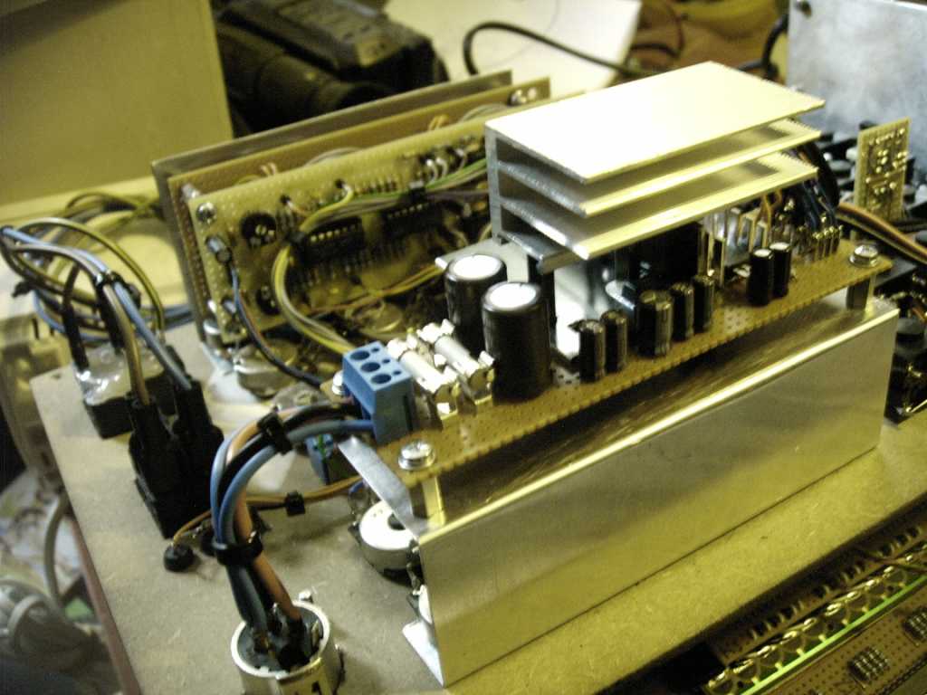

PostPosted: Tue Jul 02, 2013 6:46 am    Post subject: progress Reply with quote  Mark this post and the followings unread
I finally got the pots so was able to wire the whole panel up. And it all worked instantly Laughing Well almost, I had the finetune pot hooked up
backwards Embarassed and it looks like you can't combine the rhythms afterall.
But I only did a very quick test, maybe it has to do with switching at the right time. Anyway I think it looks nice this way and I won't change it to pushbuttons.
I added connectors to the keyboard PCB which is connected with 2 ribbon cables to the frontpanel. The chips are shiftregisters which are going to be
used to have a PIC control the keyboard. Which is the next part I have to do. I know it's going to have midi in and midi out, but I could do all kinds
of neat things (like arpeggios/seguences which can be generated random in any key). I'm thinking of making it in a seperate case connected with
one of those curly cords (I think I have an old computer keyboard with one somewhere). I'll make it so it can slide in underneath the case for storage.
The PSU is also used to power my other synths, so I went with a 80VA toroid.
* there's something wrong with my camera (or I used the wrong setting) so the colors are a bit off.

PSU (raw DC)
 Filesize:  53.64 KB

Something else, the +5V and especially the +12V regulator get too warm. I guess adding those extra shiftregisters (6 for input, 5 for output) and
PIC to the +5v requires a bit more power then I expected, and since the 12V regulator supplies the current for the 5V regulator it's heating up
quite a bit. While I was testing it even came to a point where I couldn't turn up the VCO speed very far or it started acting weird (scared me
for a second). I guess the voltage had dropped too far but it worked fine again after I switched it off and waited for a few minutes before

PostPosted: Sun Jul 07, 2013 11:27 am    Post subject: cool it man Reply with quote  Mark this post and the followings unread
I added some better cooling to the +12V and +5V regulators, works like a charm. The 5V regulator barely get's warm, and the 12V one get's a bit
warm, but it's a nice and mellow warmth Wink. So here are some pics of that, and a photo of the current test setup. Cool
bigger, better heatsink
 Filesize:  71.02 KB
 Viewed:  688 Time(s)
cool regulators
 Filesize:  76.83 KB
 Viewed:  668 Time(s)
current test setup, with keyboard and PIC.
 Filesize:  85.06 KB
 Viewed:  692 Time(s)

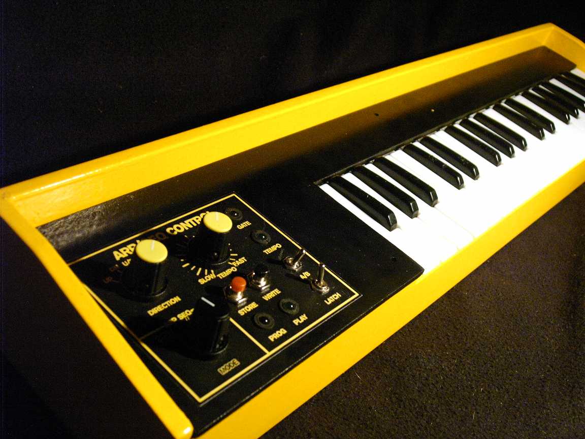

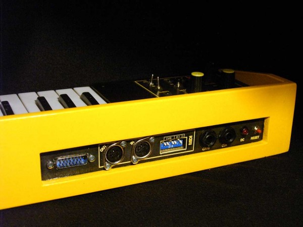

I put some paint on the keyboard Cool
EK2100 keyboard
 Filesize:  80.7 KB
 Viewed:  654 Time(s)
EK2100 keyboard
 Filesize:  91.31 KB
 Viewed:  618 Time(s)
EK2100 keyboard (backside connectors)
 Filesize:  63.08 KB
 Viewed:  621 Time(s)
