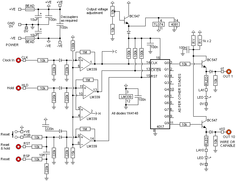

Ken Stone's got a couple of ideas round the reset which might interest you to implement.
A reset and hold feature and a power on reset.
Robert
from www.cgs.synth.net
 Filesize:  13.89 KB
 Viewed:  1071 Time(s)

PostPosted: Tue Aug 25, 2015 2:24 pm    Post subject: Reply with quote  Mark this post and the followings unread
I got some switches to put this one together but when looking at the schematic I noticed I made a mistake.
The way the diodes are connected would cause all the LED's that are connected to a step that is switched 'on'
to light up at the same time. Rolling Eyes The correct way is to connect the diodes only to the switches and not the LED's.
After I made that change I put the circuit together but I ran into 2 more problems. The first one was some odd
reset behaviour where it would sometimes skip the first step or bounce between a couple of steps before continuing.
This is a problem I have noticed before with the CD4017 and changing the pulldown resistor on the reset pin from
100K to 10K solved it. I also reduced the pulldown resistor on the CLKINH pin to 10K to see if that would get rid of the
the second probem, which it didn't.
This second problem was that Loop mode worked fine but x1 not all the time. Sometimes it would hold on
the selected step as it should but other times it would reset, which is kind of odd since in x1 mode the reset
pin isn't connected to any of the outputs. So it had probably something to do with the reset input. I tested of
this input was actually working and this is when I noticed some more odd behaviour. If I attached it to the
output from a divider (just something to test with) it would only run when the output was high. And when I
disconnected the wire from the divider it still wouldn't run untill I removed the patch cable completely.
So the reset input was too sensitive with the cable acting as an antenna. (it didn't work with the cable
attached when the output of the divider was low because I have diodes on the outputs so it was essentially
floating)
This made me think that it could also be causing the problem with the x1 mode not working correctly. So I
desoldered one end of the diode connected to the reset pin to have the reset input circuitry disconnected
and x1 mode worked fine now Very Happy I changed the capacitor in the reset circuit form 100pF to 1nF to see if
that would make any difference, it didn't. So next I reduced the pulldown resistor on the base of the transistor.
according to my calculations 2K4 would be about the minimum for it to work on a 5V output with a diode
and 1K resistor. I choose 4K7 to be sure and because it's a value that's already used in the circuit. And now
the circuit is working perfect. Razz I also replaced to pulldown resistor on the CLK for consistency, which brings
the number of different resistor values down to 2 (you could even use 2 10K resistors in parallel instead of 4K7
to bring it down to 1 value) The total resistance on the inputs is a bit lower than usual now.
In the schematic I also swapped the NAND gates around a bit, this is only done so it corresponds with
how I wired it up to make troubleshooting a bit easier.

Debug! Like this single resistor value idea; the 10K10step; but it's a rigor that would take space..
When I looked at this last, I was thinking about DPDT center-off switches and using the other pole to switch on programming leds and come to think of it an end of loop led(in the previous step column/position), whilst also having the run leds.
(will post NANDulator update soon!)

elektrouwe wrote:
because Lunetta style means misuse of in- & outputs:
- chips run hot or even die when connecting outputs or shorting them to GND or VDD
- unbuffered gates in "analog mode": gain drops with higher VDD ( bad for twin_T bass drums and other filter and amp stuff)
- chips run hot when holding (touch-) inputs near VDD/2 or leave them open
for me the only reason to use more than 5V VDD is the drive capabilty of the outputs and Ron of 4066,405x analog switches. 6.5V is my favourite, because I still can use 74HCxx
So if I understand you correctly what you are saying is that if I understand maximum current and power dissipation limits and don't gratuitously abuse unbuffered inverters by trying to use them as op-amps I can enjoy all the advantages the extra voltage headroom allows and still be free to power a real op-amp mixer and a small audio amp as well.
Well, why didn't you say so right off!

Coming back to this: I've been mulling over using 4pdt slide switches to do this and have a reset/off/on/tie version for wonderful gate possibilities in a little package
piedwagtail

PostPosted: Wed Sep 02, 2015 4:45 am    Post subject: Reply with quote  Mark this post and the followings unread
I'm going to have to explain it verbally as I can't sketch a schematic at the moment, but it should be possible to integrate the short/long switch in the original into a 4pdt (has to be a double throw). So a step can either be on(short) or on(long) – which would act like a tied gate
Can't remember my exact working, but I remember simulating it and it being solid. It maybe needed another chip though as the short/long part has to be made separate for each step. I remember playing around with some diode logic, but I can't remember if anything came of it.
