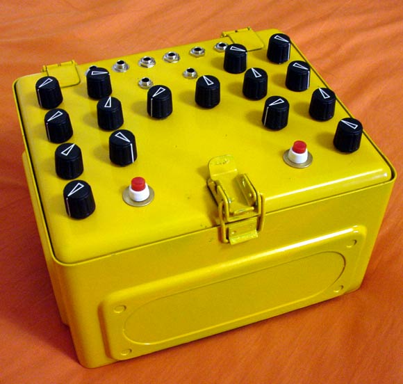

finally i got it in a decent case...
so here are some pic´s of my Dual DS7 clones - -
just need to ad labels to knobs
sound samples are soon here also
daniel

PostPosted: Thu Jun 16, 2005 11:23 am    Post subject: Reply with quote  Mark this post and the followings unread
Daniel, looks and sounds great. Congratulations. I'm sure you'll have many hours of fun playing with these toys.
If you want a good program for recording stuff on your PC that is free, be sure to check out Audacity. Please keep us posted with more mp3s and pictures. Smile

Uncle Krunkus wrote:
I'm thinking I might have a go at one of these DS7s myself!!
on stripboard maybe ? that would be so cool. I'm a fan of your boards.
talking about girlfriends - after i build the DS7 my girl wanted to build the noise source for it - and she did a great job. now she wants to build the DS7 Smile ... soon we need two soldering stations ...
here is a blurry pic of Ray's Multi Noise and Random Gate/Trigger Generator
www.koelse.org
