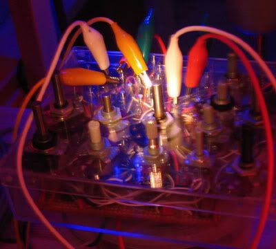

PostPosted: Wed Oct 19, 2005 1:21 am    Post subject: dronebox 01 has been buidl on WSG Reply with quote  Mark this post and the followings unread
here is a dronebox 01 that has been build by dach.
dach wrote:
It's a couple of different circuits I've come across. There are some 555 oscillators, musicfromouterspace weird synth, which uses schmitt inverter oscillators, and the filter, and some op amps for the lfo triangle waves. Im feeling rather pleased Smile
The patching part is inspired by the works of Peter Blasser. He's my hero.
take a look at dronebox pics & mp3s
daniel

PostPosted: Tue Oct 25, 2005 6:50 am    Post subject: Reply with quote  Mark this post and the followings unread
have you built a WSG?
have you also built a WP20?
cool!!! now it's time to put the two things together...
install this simple mod on your WP20 and connect your WSG...
it adds layers of cool sounds...
and when your sound lab will be ready to go, install an audio input on it and connect the WP20+WSG...
would you guys call it a "cascade synth"?! Shocked Very Happy
ladislao
P.S.: I forgot to say that I got this mod from the mighty Alan McKerchar!!! Thank you Alan!!! Very Happy

what a shame :( the mp3's appear not to be working.
lovely looking thing though :)
