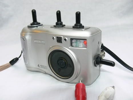

WSG´s keep comming - i was doing my normal afternoon surf on net and i saw this lovely WSG from donebysimom.be

PostPosted: Tue May 09, 2006 8:50 am    Post subject: Reply with quote  Mark this post and the followings unread
Cool Cool 4.1 Megapixel WSG Twisted Evil

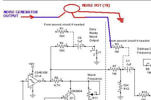

Do you know if it is possible to add a noise generator to wacky,zany,weird project?how could it be add?

balance wrote:
Hi Very Happy
yes
connect noise output to -
point 1 of R1
or if you build the filter:
point 1 of R3
but you may want to ad a potentiometer - to adjust the amount of noise

Could I add to soundmaker a simple white noise generator like this?
why I should connect noise output to R3?Yes I've built the oDNESS cUT oFF fREQ, but I didn't use a second circuit (I read that I've to use R3 from second circuit if needed)..so I think I should connect noise output to point 1 of R7.is it ok? Rolling Eyes
bye
that noise circuit of yours is kind of "second circuit" so i think you should try it first thru R3 (1M) and if the signal is too weak or too loud adjust the resistor value or maybe ad a potentiometer and "noise on/off"-switch or push button ...
please you correct me if I mistake:could I make this connections?
Should I repeat the soundmaker circuit using the 3 inverters that are left over if I use R3?
You pardon me if I am not expert of electronics Embarassed
I'm here to understand study
and build! Wink
that noise wiring is OK. try first whit 100K pot and if the signal is too weak try substituting R3 whit 500K resistor...and so on until you get what you want.
you don't need to repeat the circuit - but if you like you can - and then you need to ad R3b (another 1M resistor)

PostPosted: Sun May 21, 2006 11:31 pm    Post subject: Reply with quote  Mark this post and the followings unread
wow!
The noise wiring it's ok! I thought to have made one mistake.... Surprised
tnx dnny for your suggestions.....Today I'll try to ad noise gen.
