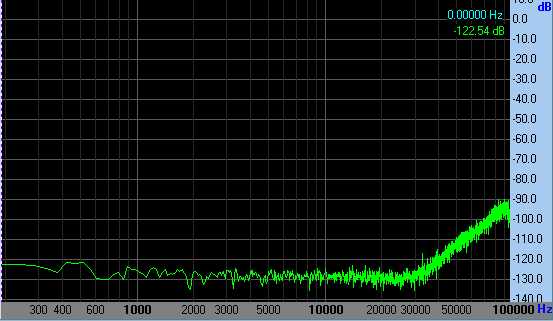

All tests were done using an E-MU 1820m at 96 kHz, except the two 'no signal' tests, which were done at 192 kHz.
In every case the patches used were functionally identical and the levels going into the analyzer were matched pretty closely.
In their respective screenshots, the 24 kHz 'spike' changed amplitude within approximately the same range on both the NM Classic and the NM G2.
I don't know what to make of these. The thing that troubles me the most is the HF noise at the G2s outputs (even when muted).
I'm glad to have the NM Classic back, though. A qualitatively different sound and feel that I missed -- that much was apparent within the first few hours. The G2s interface enhancements (editor and hardware) have kinda spoiled me, though!

The control modules, including the envelopes, are recalculated at a 24kHz sample rate. Perhaps that accounts for those last spikes.

that's what i'm thinking, too. but if these control signals are not audible, per se, why do they manifest in this way? that's the part i don't quite 'get'
They often *are* audible; if you multiply a audio signal with a controll one then the controll one gets into the endresult as much as the audio one (as do the sidebands resulting from the modulation which may well be over the nequist). The only sollution is anti-aliassing all amps, mod inputs and frankly all signal processors in addition, of cource, to all oscs; this a well known part of dsp theory, it´s just hard and cpu intensive.

I don't think that effort is necessary. Clavia's already thrown money at the problem, by using a control sample rate that's so high that it's inaudible. My 45-year-old ears can't hear 24kHz, and my equipment can't record it, so it's not an issue for me.

Kassen, when I look at cebec's plots, I can't help but think that you're making a mountain out of a molehill.
When I listen to the G2 I can't help but wonder how anybody could possibly climb it.
There is something wrong. I don't claim to know what it is but there is something profoundly wrong about the G2 sound; something is off in the high-end that reacts like ice-picks with my ear and that throws off my sense of spacialisation. Specs and test results are one thing, but how this reacts with my hearing is quite another. I get headaches and desorientation from the G2 and it's contemporaries, I can instantly tell recordings must be new because the current generation of hardware digital synths all share a yet unknown phenomenon that throws off the high-end that I'm willing to bet will be the clue to future generations that a certain recording was made in this era, much like the enthousiasm for certain reverbs in the 80's, except that there is no context where it sounds good.
I'm not making up the concept of audio-rate envelopes either; the C-sound scene has been using them for a long time now.

...something is off in the high-end that reacts like ice-picks with my ear and that throws off my sense of spacialisation...
i admit i had a somewhat similar experience in my use of the G2 particularly with headphone monitoring.
right now, i'm not as concerned with recording inaudible high frequency noise or instantaneous, masked, alias-noise as i am about subjective sound quality and some of the things kassen's mentioned.
again, i've been really pleased with the sound quality of both instruments and use the G2 almost exclusively these days, but the 'symptoms' kassen mentions and the 'data' we've seen, and the fact that i now have a classic at my disposal -- i feel i'll sort things out soon enough for myself.
