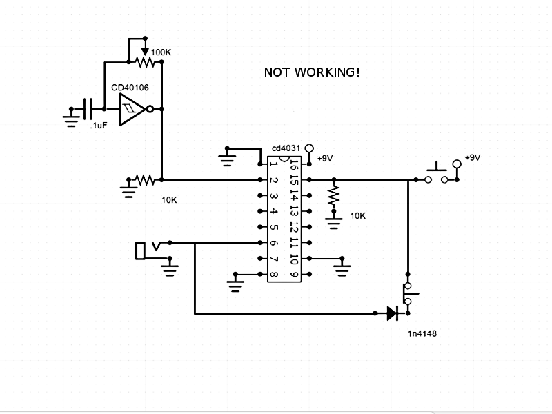

PostPosted: Wed Oct 12, 2011 5:28 pm    Post subject: Reply with quote  Mark this post and the followings unread
Soooo this is exactly what I have done:
Why is this not working? Ahh it's driving me insane Twisted Evil

Looking at your schem, nothing looks wrong about it to me. Did you ever work it out? What were you gating with it? You know it doesn't produce sound on it's own right? You need to gate/trigger something with it.
Also, .1uF is a pretty small cap for a clock oscillator. Isn't that up in the audio rates?

hi!
i built the 4031 tap looper based on Top Top's schemo, but mine play back just once.
i used cd4031BE and the clock source is 40106.
any idea?
hmmm...
i don't know what was the problem but now it's working:)

PostPosted: Sat Sep 22, 2012 3:54 pm    Post subject: Reply with quote  Mark this post and the followings unread
PickNick wrote:
hi!
any idea?
hmmm...
If it is only repeating once, that means the output is not being looped into the input properly.
One thing to make sure is that your "clear" switch is a normally connected type of switch (if it is normally open, it won't allow the output to return back to the input).
A.M.P. ESOTERIC ELECTRONICS

PostPosted: Fri Sep 28, 2012 7:48 am    Post subject: Reply with quote  Mark this post and the followings unread
thanks Top Top!
now it's working.
there was some cold solder joint.
