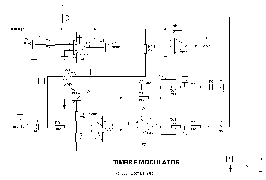

    Timbre Modulator Based on Electronotes #72 design by Bernie Hutchins. Schematic shared by Scott Bernardi on his site : http://www.bernacomp.com/elec/og2/og2_timbremod.html
    Features
    Clipping level independently adjustable on positive or negative halves of input waveform Input drive to diode clipper is determined by modulation CV Unmodified signal can be summed with clipped signal
