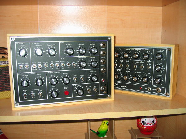

Here is the Soundlab I just finished. I built a case just like the WSG shown next to it in the first photo (sorry about the flash).

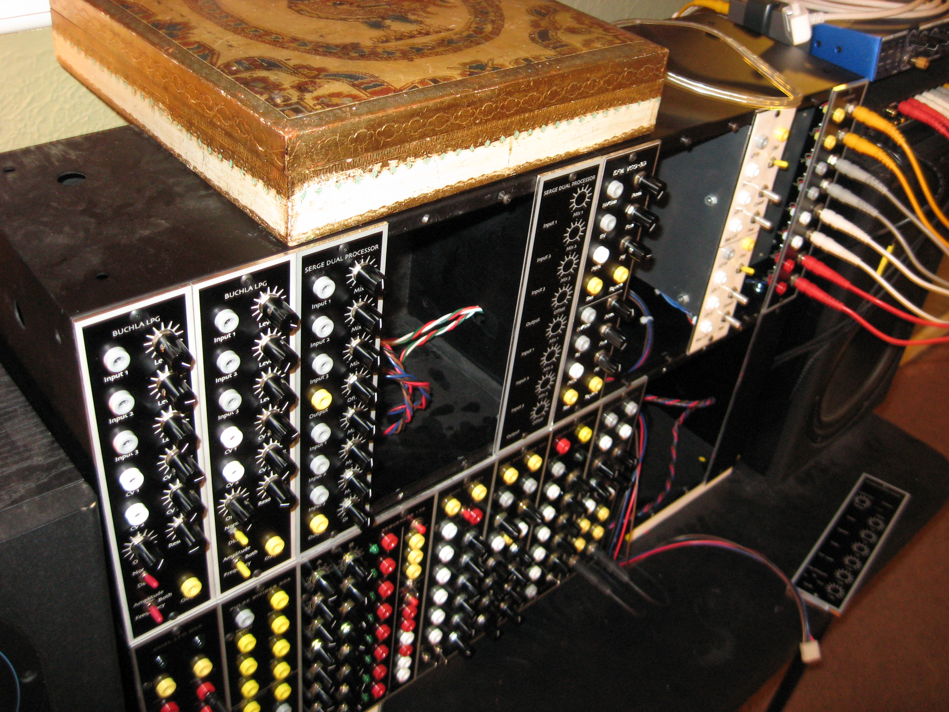

More DIY Modcan 2009

Sorry for the dumb question but how do you DIY Modcan? Just because I'd love to be able to but was under the impression they only sold built modules. Did you simply replace the panels?

He built DIY modules in Modcan style Smile

U mean, u ask for PCB layouts of modcan modules?

I asked I'd he'd sell a PCB and provide a BOM.
Also realized he was probably building in the format rather than exact Modcan modules. I've mainly looked at the Modcan B modules which are basically in MOTM format and forgot about the A series probably being its own thing.

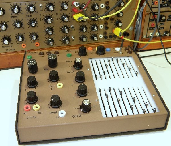

About all of my building this year has been putting prototype boards for the new modules behind panels. The first photo is a 3u rack panel with a Teezer, two Threelers and a 4-input VCA.
The second is a small project box with a Teezer and a DoubleDeka. When prototype testing I usually have long leads to all the pots/jacks, and for the little box I just stuffed them all in. Quite messy inside, but I checked to make sure the two oscillators don't self sync, and they seem fine. So the extensive PS decoupling used on both boards has paid off well.
Behind the box you can see my "Sprott Box" chaos generator (built a couple of years ago) including dedicated gate and trigger generators, plus a Sin VCO for external drive and modulation.

Those look great, Ian.
What is your method for labeling?

Thanks, Bruce. The labels are water slide decals (Bel). Quite difficult to work with, and they always show through a bit. The decals are followed by coating with acrylic then sanding with a block, over and over until the surface is flat. For the litttle box I sprayed the final acrylic from a distance to get a matte finish.

I'd like to come over and play with that Sprott panel!
Are those clock-faced knobs multi-turns?

Yeah, they're Bourns knobpots. 10 turns and very linear. Like instrumentation grade. They stopped making them a few years ago, in favor of the ones with "digital" readouts. I managed to collect a bunch from a salvage yard and my dad found some too where he worked. Before they stopped selling them they were going for ~$90, so I'm very lucky to have a bunch.

Do you have any samples of the Teezer/Double Dekka box, on its own?
I imagine that it would make some lovely sounds!

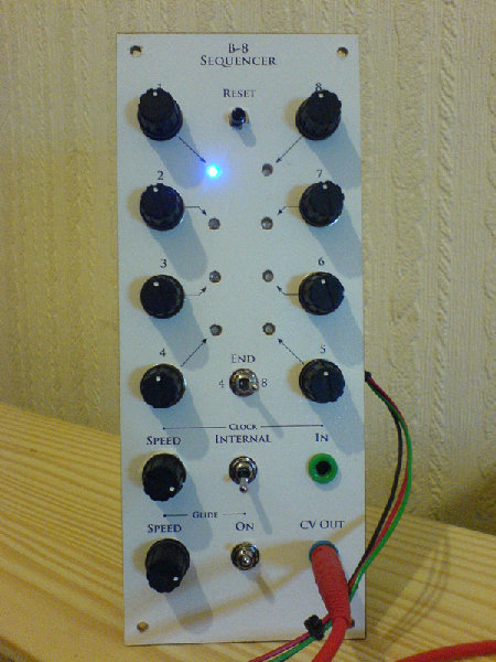

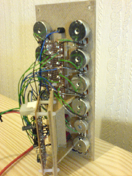

By sharp contrast, my messy new modules... especially to the rear Wink

cool sequencer panel
messy? no way
i like those little structures you have built to support the pcbs

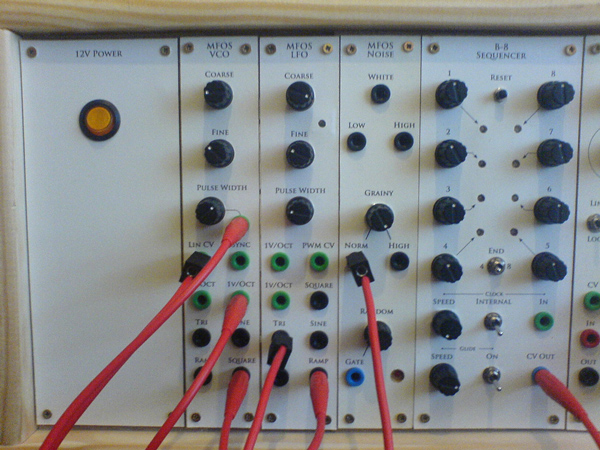

It's taken about a year of toiling over a soldering iron, but I have finally finished my first row of modules! In lieu of decent photographs I have uploaded a video from my iPhone - the picture quality isn't great but the audio is pretty decent quality.
The modules from left to right are:
ARP Odyssey MKIII dual VCO
YuSynth ADSR (although it's not being used in this patch)
YuSynth Minimoog LPF
Buchla 208 Random Voltage Generator
MFOS Buffered Multiple
CGS Utility LFO - this is in a temporary panel made from perspex.
Thomas Henry VCA
A massive thanks to everyone who's helped me get this far with it!
I'll post some good quality photos up when I have access to a decent camera.
