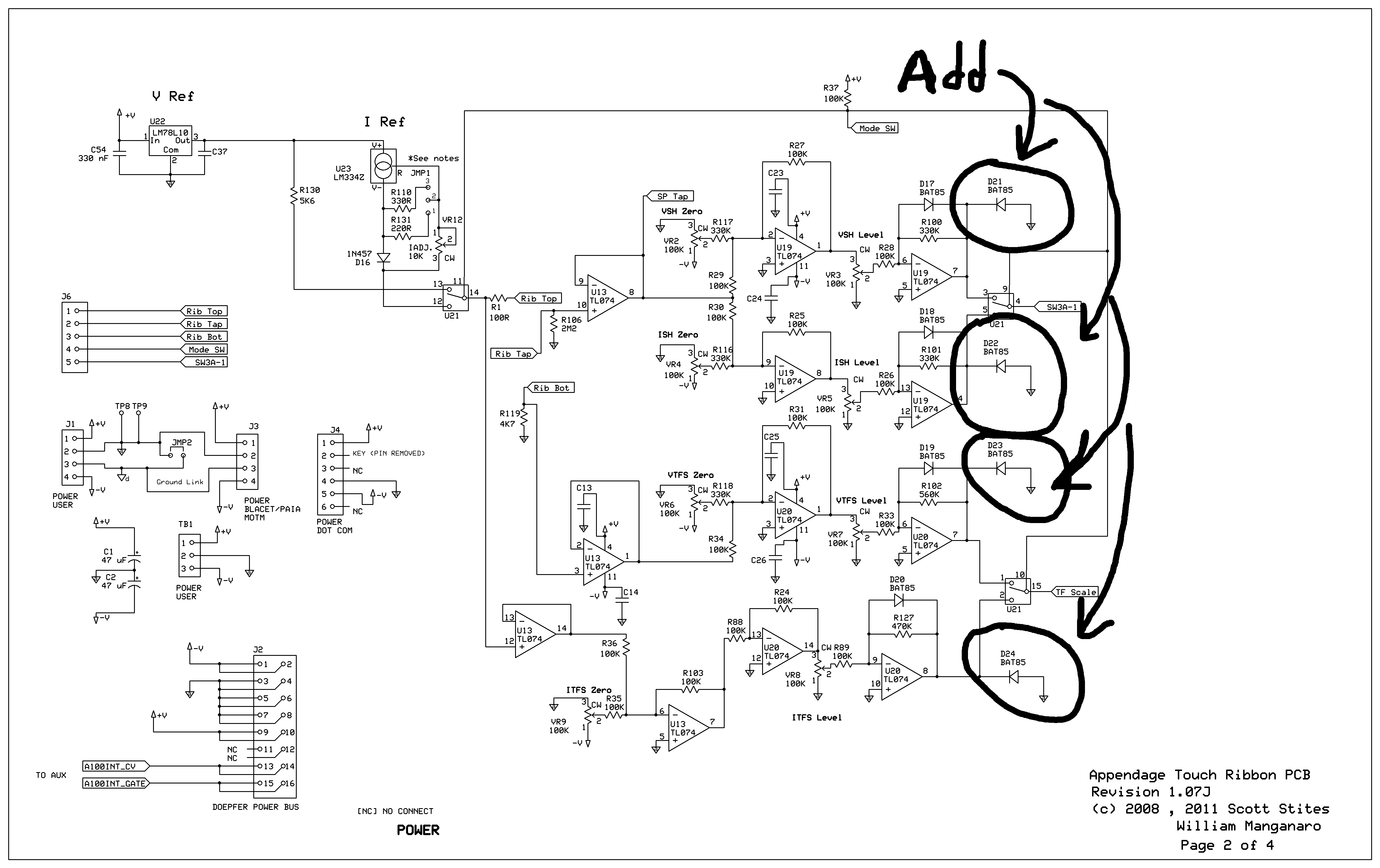

NOTE TO ALL PRESENT OWNERS OF APPENDAGE RIBBON CONTROLLERS WITH A REV H PC BOARD.
It has been brought to my attention and confirmed by Scott Stites that a potential condition exists that could cause failure of U21, CD4053 Analog Switch. Some dual power supplies where the -15V may come up some time before the +15 will cause a harmful negative voltage to appear at U21 analog inputs. To prevent this, four protection diodes can been added. The schematic attached shows the connections.
The diodes can be easily added to the solder side of the PC board under U19 and U20 operational amplifiers.
All new REV J PCB's will already have this change.

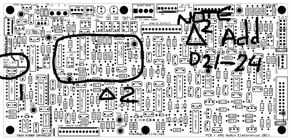

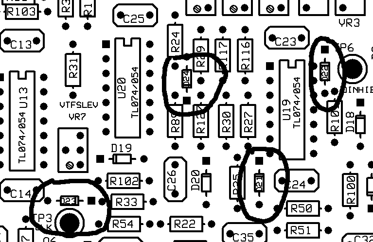

PLACEMENT OF 4 NEW DIODES ON REV "J" PC BOARDS SHOWN BELOW.
Click on image to enlarge.
Thanks
Bill
