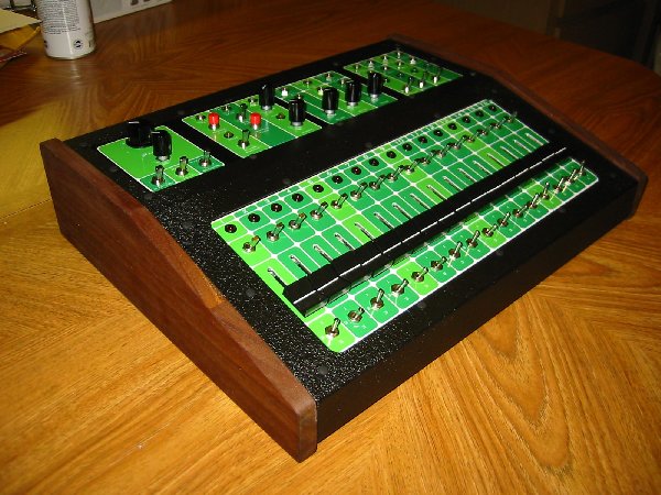

Here's a photo of where things are at with my desktop Klee console:
nothing is wired as of yet.
p.
don't look too close, eh

OMG OMG OMG Shocked Shocked Shocked
totally awesome

That does look gorgeous! Excellent work.

It's like the Arp sequencer's mutant cousin.

Friggin' awesome!

I'll post more as progress is made. Hopefully a video at some point. I'll probably also put a build diary on the blog as time permits.

Photon ........ I REALLY think that is beautiful. Fine work and if we were face to face with you, I would be shaking your hand dude !!!!! Very Happy
DIY is alive and well guys !!!!! This stuff really makes my day !
