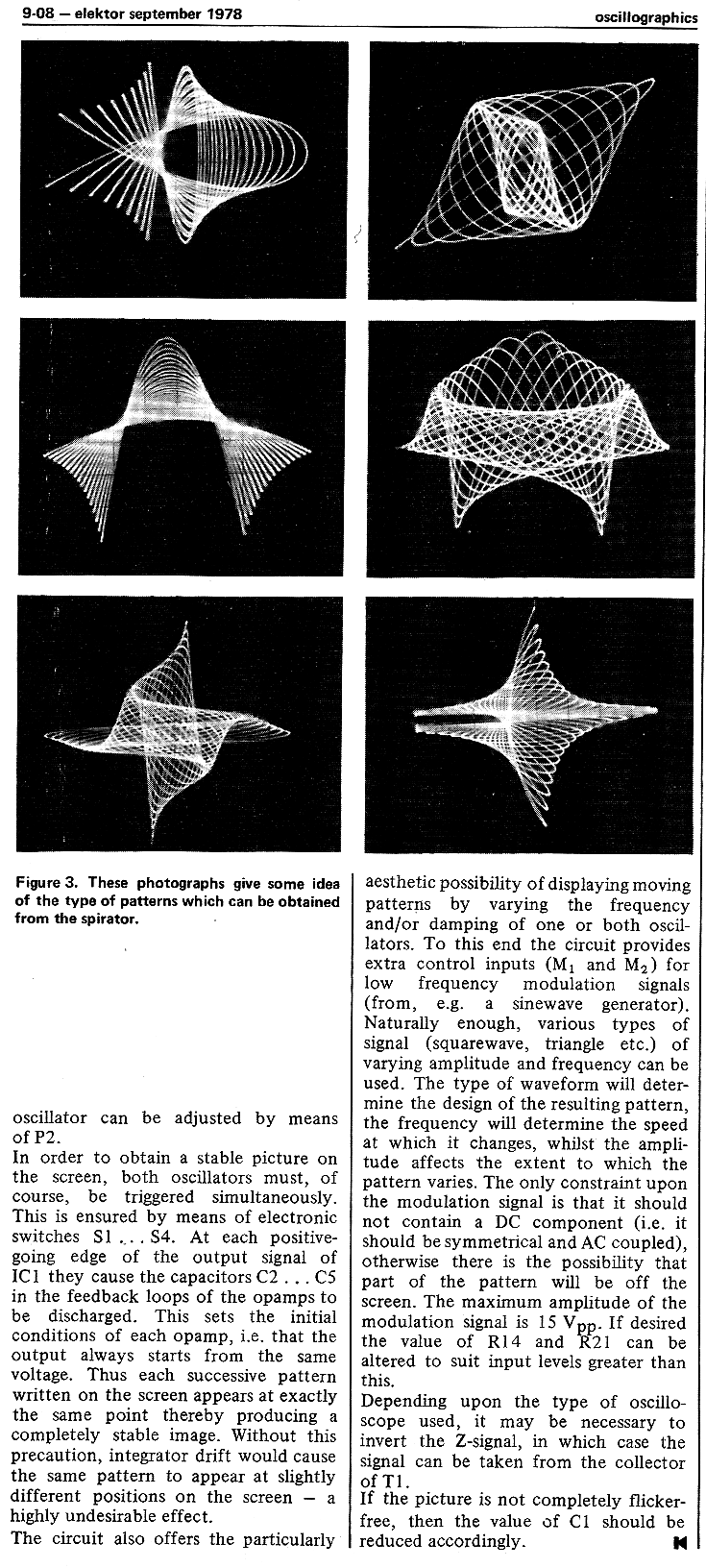

bugbrand wrote:
Oh damn the images are amazing.
& you can hear the sounds too - all sorts of harmonics.
Plus modulation.
I'm sure there's a lot of tweaks possible to mess with it.
Cool
I'm sorry for the extra parts- I must not have scanned that bit (It's just an on-board PSU, but you can always omit part of it. I think Oscillographics needs a +5v rail?), but anyway Tom, this is great! Thanks very, very much for posting this Very Happy
bugbrand
Joined: Nov 27, 2005
Posts: 846
Location: Bristol, UK
PostPosted: Tue Jan 30, 2007 2:39 am    Post subject: Reply with quote  Mark this post and the followings unread
I've put +/-5v regulators in now (kludge) and taken out all those extra bits and its working good! (still not used the Z though).
Nice to feed the X channel output into the Y mod input and vice versa for feedback goodness oh yes.
I could watch these all day but really have a lot of other work to do...

Reposted as requested.

and the last bit reposted.
I can add that the design works well, and that I subsituted a 79L05 for the 741-plus-transistor negative regulator. I think Elektor only used this because 79L05's weren't made then, or were at least very rare.
