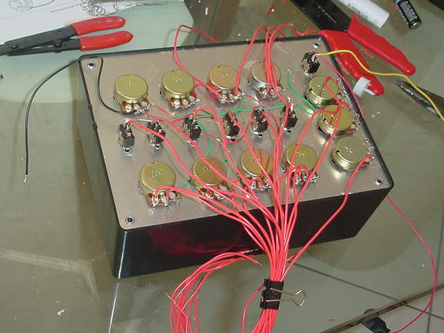

PostPosted: Thu Oct 11, 2007 1:34 pm    Post subject: Reply with quote  Mark this post and the followings unread
Howdy my friends!
Since we've been sort of silent lately here is a pic of the rewired Front Panel. I cut all cables 1 foot long and attached them to the panel.
This way I can troubleshoot the whole thing easier.
I chose the same Front Panel design suggested by Ray.
Next step: remove the two 1M resistors and attach one leg of each to their corresponding position (the one closest to the I.C.) UNDERNEATH the circuit board, then connect the circuit board to the Front Panel.
Coming to think about it, I'll attach those 2 resistors to the Experiment Kludge Area, and add a couple of switches in order to be able to select Voice A or Voice 2 or both... There you are! We have witnessed the birth of another simple MOD... TRONATO'S MOD!
Due credit must be given to BLUE HELL who suggested how to isolate the 2 Voices. His suggestion made me think about the Mod.
What do you think?
Hmmmm... now I have to figure out where will those 2 switches fit elegantly... GOT IT! There's enough space under the Voice B pots.
Now to the infamous Radio Shack to see if at least they have switches similar to the ones used so far...
Note the aluminum plate on which everything has been mounted.
TRO
PS: The ruined Amp post was a joke! (LOL).

RF
Joined: Mar 23, 2007
Posts: 1502
Audio files: 28
PostPosted: Fri Oct 12, 2007 4:41 am    Post subject: Reply with quote  Mark this post and the followings unread
Hey Tronato
Glad to hear the amp is OK. Hope the wsg project is coming along.

Hello again!
This is absolute madness...
I bent pins 2 - 4 - 6 of the CD40106 in order to isolate Voice A from the circuit and indeed this isolated it since the controls didn't affect the sound but the noise was still there...
So I put the pins back in their original position and proceeded to do the same for Voice B, that is pins 8 - 10 - 12 and the damn noise was still there!!!!!
Could it be the transistors? They are the only active components that I haven't substituted...
And who can explain what R5 and R22 are for? I disconnected them thinking I could isolate the Voices that way but everything works as if they were connected. Whether they are in the circuit or not everything works the same...
My girlfriend insists that I should throw the whole thing away!
Darn!
TRO
Posts: 24604
Audio files: 310
PostPosted: Sat Oct 13, 2007 3:59 pm    Post subject: Reply with quote  Mark this post and the followings unread
R5 and R22 mix the voices A and B into the filter. But, when S1 is closed sound can come in through R2 from voice A and likewise for voice B with S4 and R21. So when the resistors are out and the switches are in the correct position the thing should be silent.
When it's not silent either the switches S1 and/or S4 are set wrong or the filter oscillates. Try, with R5 and R22 "removed" all four possible combinations of S1 and S4, one out of four should be silent unless the switches are incorrectly wirded up or the filter oscillates.
When the filter oscillates presumably how it oscillates would be influenced R3, R31 and R32 - when that's not the case ... hmm, wouldn't know then.
