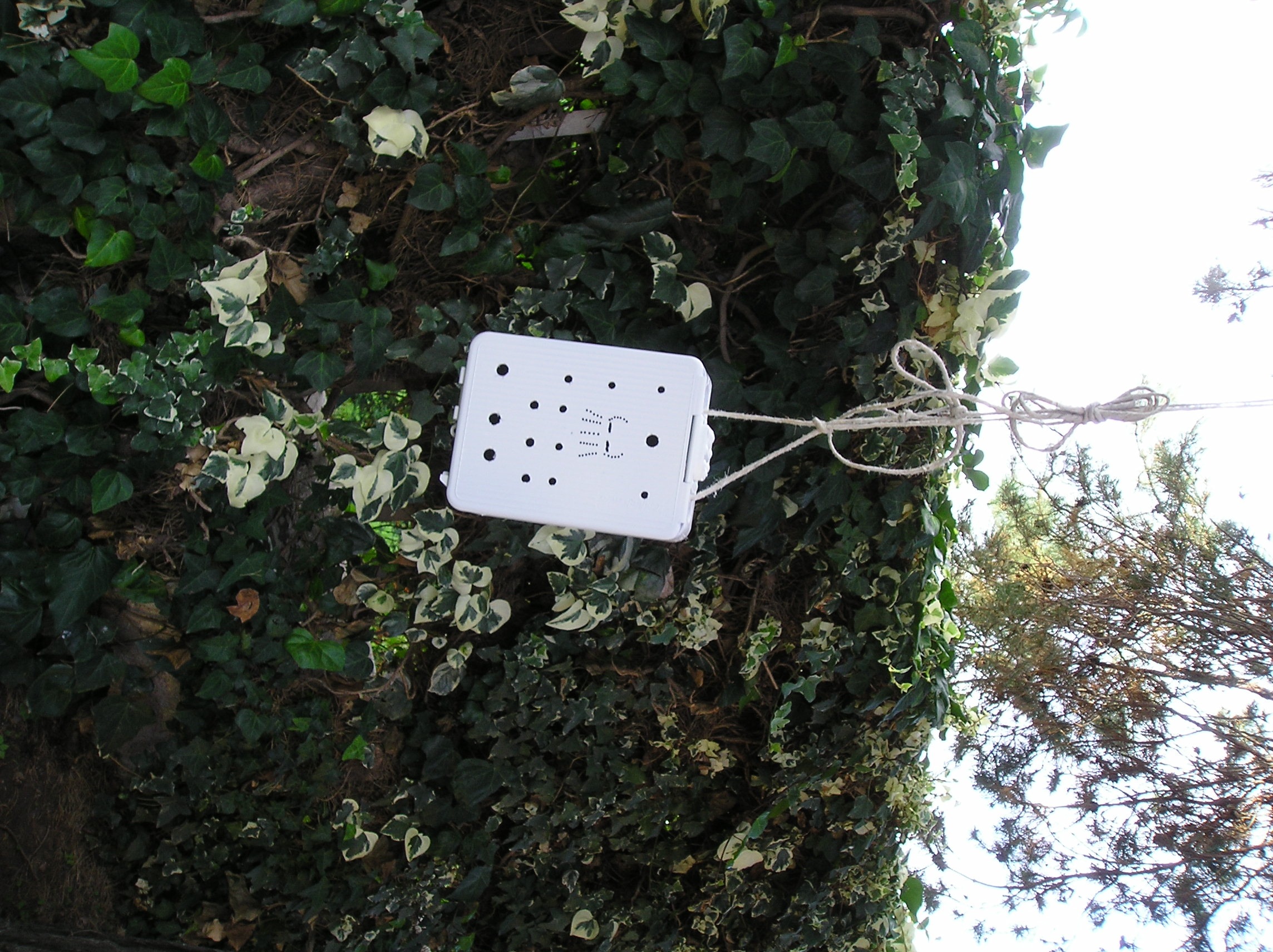

PostPosted: Sat Sep 27, 2008 9:19 am    Post subject: Resonator build n.1 Reply with quote  Mark this post and the followings unread
We've built 2 resonators,
an incredibly good sounding and well thought project... thanks fonik!
we implemented all the mods suggested by fonik and got deep into modding the LFO which now has a multi turn switch to select for different rate ranges (switching through capacitors)
we liked the LFO so much we got an LFO out too to drive other stuff!
here's a picture of the 1st module case being dried in the sun and more importantly a little movie of the module in action
it's from my mobile phone so i hope you can read 3gp format
soon, for your delight, pictures of Resonator n.2
Wink
aero
