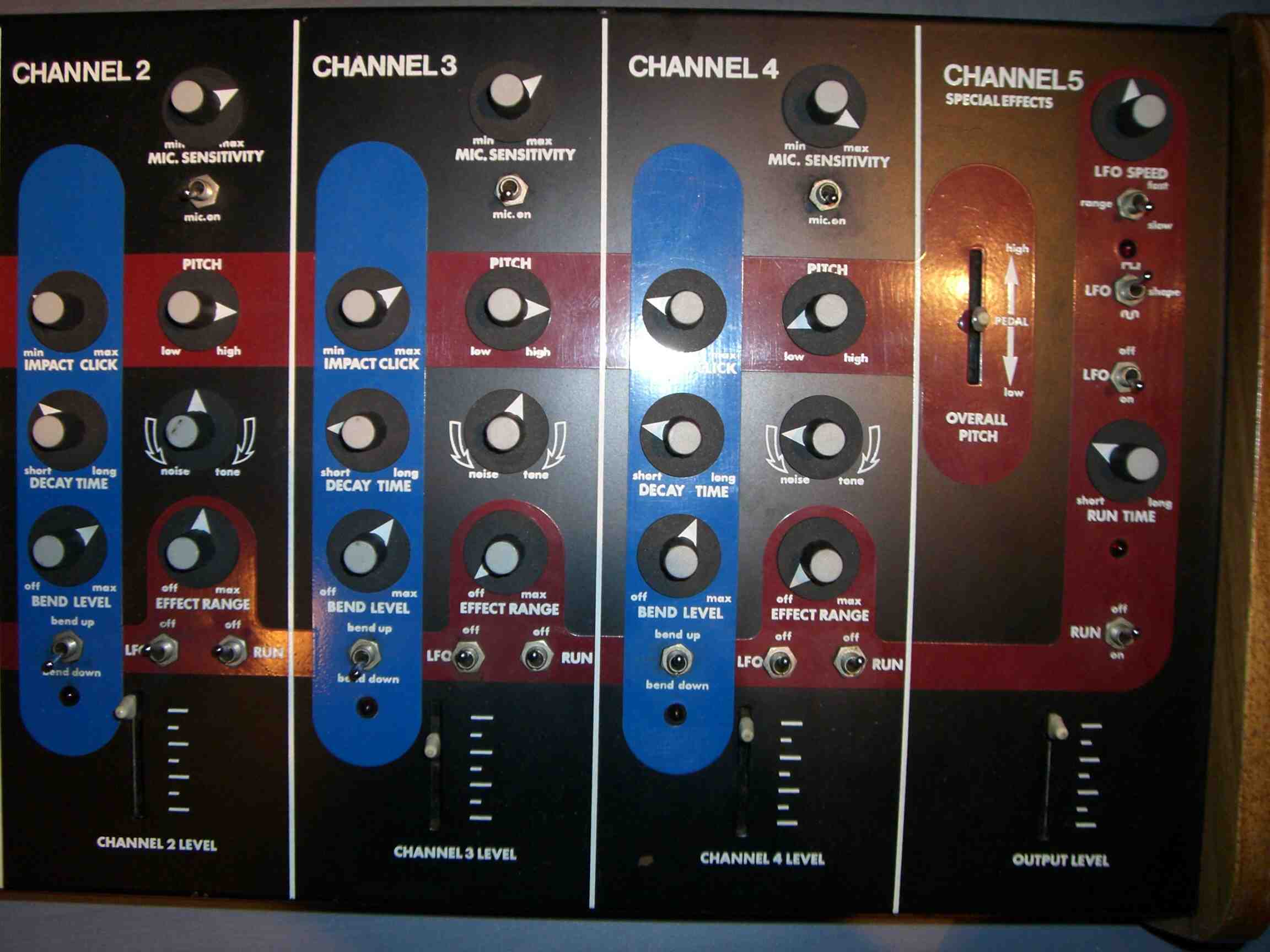

Arghhhhhh, I'm trying to figure out what the essential controls are too.
Randal said:
1) LFO rate
2) Mic. level (input sensitivity)
3) Click level
4) Pitch
5) Decay
6) Bend
7) Noise /Tone mix
Cool Bend level
9) Run time (Arp. length-TIME)
10) Effects level (modulation input atten. for LFO and Arp.)
11) Channel level
But, I clearly only see 7 pots per voice, plus the fader. What was he smoking?
Can anyone explain what controls and options are available on the PCB?

On the original SDS3, Channel Pots From top to bottom, left to right:
1) Mic. Sensitivity
2) Impact Click
3) Pitch
4) Decay Time
5) Noise/tone Mix
6) Bend Level
7) Effect Range
8 ) Channel Level (slider)
Then there are four more pots in the effects section:
9) LFO Speed
10) Run Time (Arpeggiator)
Having individual LFO's and Arp's greatly! increases the available variety.
11, 12) Overall pitch and overall level (unnecessary with individual modules, but still useful for a group of SDS3 modules IMO)
Bubblechamber's board is different from mine; I don't know what his board supports. But these 12 pots are the original SDS3 controls.
No smoking involved. Here's a close look at an SDS3.
Kind regards, Randal

Awesome! Thanks. I've been trying for a long time to find a decent pic of that thing.
