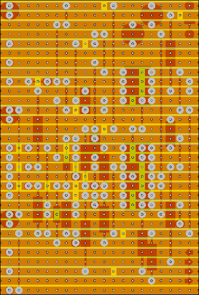

PostPosted: Sat Nov 15, 2008 2:55 am    Post subject: Reply with quote  Mark this post and the followings unread
I've designed a stripboard layout of the EZ-Chaos circuit and, with Ian's permission, present it here for anybody to use if interested.
I used 6 op-amps and incorporated a basic indicator for each output. The LEDs are bi-colour, and hopefully will help with adjusting the controls for a decent swing and good placement.
I've laid it out so the pots can be mounted directly on the board (16mm) but you could easily run wires if not. The LEDs should also easily mount through 3 holes drilled between the pots.
I'm in the process of building it up to test, but at this stage it is UNTESTED.
I'll update this status as soon as I can get to my workbench. Rolling Eyes
I'm planning on putting 2 of these on a 1U rack. Or possibly three, normalled to a jerkster on a 3U rack.
Enjoy! Very Happy

frijitz
Joined: May 04, 2007
Posts: 1734
Location: NM USA
Audio files: 54
PostPosted: Sat Nov 15, 2008 3:10 pm    Post subject: Reply with quote  Mark this post and the followings unread
Looks great!
Ian

Hey unkle did you ever get around to testing the stripboard layout? I have jus preped a board for population and will be getting to it sometime soon. Also where did you get your dual gang 1m pot?
Thanks

PostPosted: Fri Dec 04, 2009 8:37 am    Post subject: Reply with quote  Mark this post and the followings unread
Actually you can use just about any old dual pot 10k or over. 1M was just what I had on hand.
Smile
Ian
