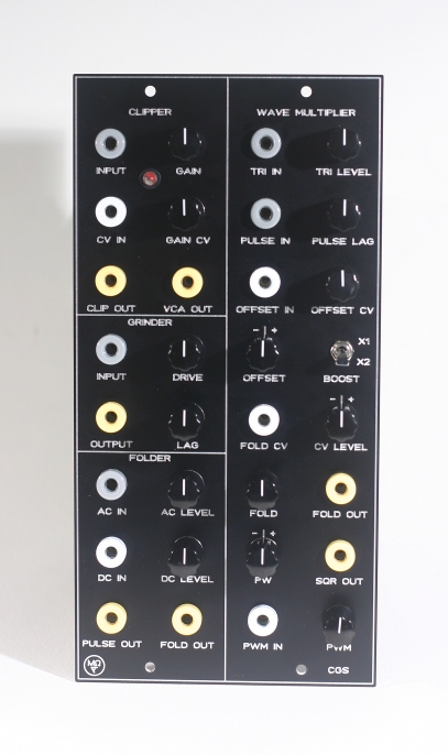

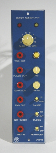

Two different Wave Multipliers with a bit extra and a Burst Generator:
Unfortunately, all these modules left my possession as soon as they were finished. It was hard to say goodbye Smile

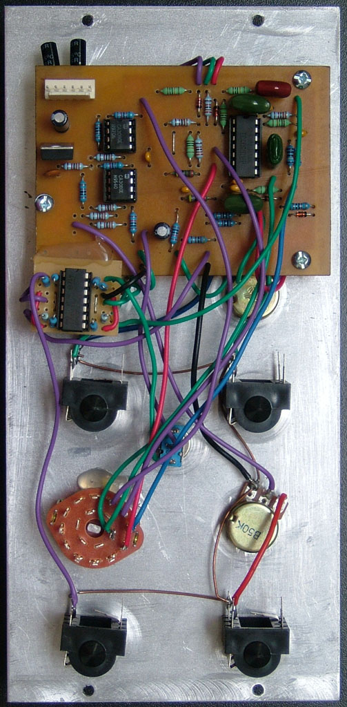

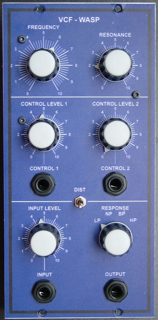

I finished my WASP VCF a few weeks ago. I added 2 extra gain stages at the output
as the level was a little weak compared with other modules. One stage amplifies X2
the Distortion out, and the other amplifies the main output X2, so when the
Distortion is engaged I get a X4 gain.
You can see the little board glued to the main PCB.

The Time machine and the Wave Multipliers have modified circuits.
The TM CV VCA is modified so that the envelope follower, LFO, and External Input are pre VCA instead of post VCA. Originally, only the LFO goes thru the VCA.
The Wave mults have a boost switch that pushes the module into some intense overdrive. Plus a bunch of component value tweaks.
I'll try and get up a couple posts documenting the mods and I'll put them in their relevant sub forums.

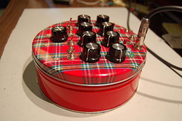

Also, I built a little synth for emraldadrift as a gift a few weeks back (probably my favorite build of the year!).

Emraldadrift's holiday synth built by Adamon
