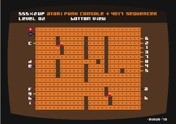

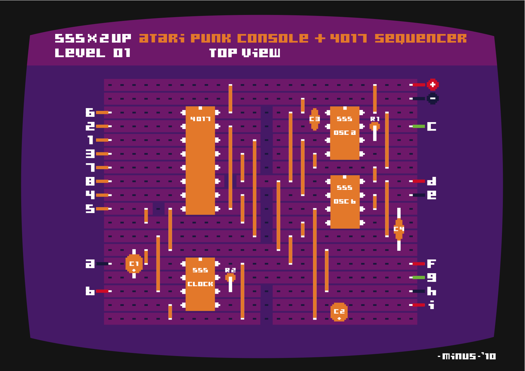

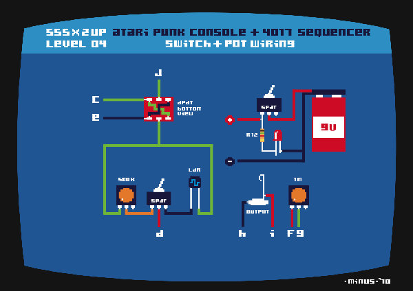

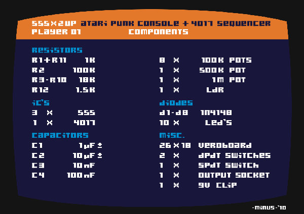

PostPosted: Sat Jan 16, 2010 11:20 am    Post subject: Reply with quote  Mark this post and the followings unread
Finally.... Got the vero/stripboard diagrams done. Maybe if I played around with it more, it could fit into a smaller footprint... but I have built and tested this, and it works fine... far as I can tell. I changed the LED resistors from 80K to 18K as the bulbs weren't burning too brightly. Also I have added an on/off LED and switch. Admittedly I don't have the LDR connected to my build yet, but I think the diagram is correct...
 Filesize:  648.77 KB
 Viewed:  2809 Time(s)

PostPosted: Sat Jan 16, 2010 11:28 am    Post subject: Reply with quote  Mark this post and the followings unread
For some strange reason, the images are in reverse order... Embarassed
I've never posted images before... I previewed them... but they seemed to appear in reverse order... so I reloaded them in reverse hoping they would come out the right way... but no!
Don't worry about me.... just a bit confused... Confused

PostPosted: Sun Jan 17, 2010 1:45 am    Post subject: Reply with quote  Mark this post and the followings unread
Hey Minus those are some very cool layouts !
By reverse order I take it you mean the levels and not the images themselves ?
Did you do your build on stripboard btw ?

PostPosted: Sun Jan 17, 2010 8:22 am    Post subject: Reply with quote  Mark this post and the followings unread
Yeah, built it on stripboard.... NO PROBLEMS with the diagram. What I meant was that I wanted the top image to come last, and vice versa. Just being a bit picky! Might be using this method of oldskool atari art for future stripboards seeing I have a lot of the components drawn up in Illustrator now.

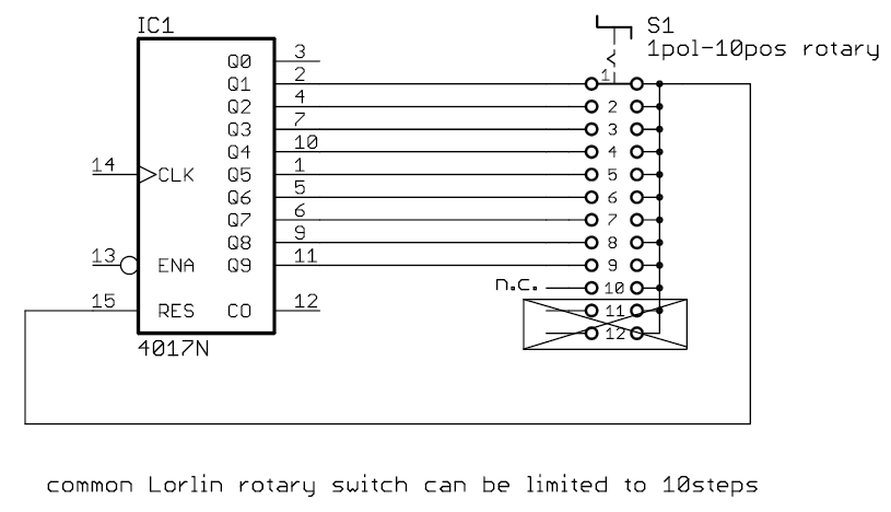

Also Minus, did you figure out how to wire a rotary switch up to select the number of steps. I've got a 4p3T I'd like to try but I'm having a hard time understanding the science.
PostPosted: Tue Jan 19, 2010 2:10 am    Post subject: Reply with quote  Mark this post and the followings unread
say you want to use all the 10 steps of the 4017, then you'll need a 1pole-10position switch. the common lorlin rotary switches are available as 1pole-12pos, but can be limited to any step count you need.
below you'll find a schematic of the wiring:
COM is connected to the reset input of the 4017
1st step of the IC (Q0) is not connected to the switch. why? if connected to position 1 of the switch and then routed to the reset it would work as STOP on step 1 (INHERIT).
the following steps of the IC are connected one by one to the positions of the rotary.
the 10th position of the switch is left open. why? when the counter IC reached step 10 (Q9) it will need no reset but start from the beginning on it's own.
if you wanted to use only 8 steps then just limit the switch to 8 position and still conenct Q8 to position 8 of the switch.
hope that helps.
