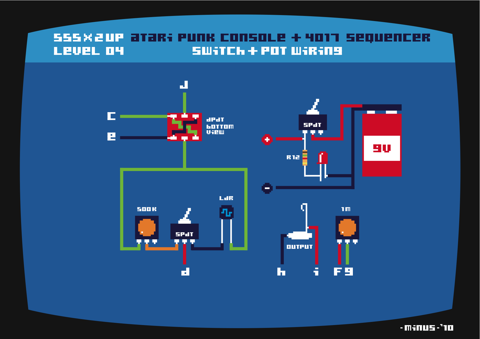

PostPosted: Sat Jan 16, 2010 11:20 am    Post subject: Reply with quote  Mark this post and the followings unread
Finally.... Got the vero/stripboard diagrams done. Maybe if I played around with it more, it could fit into a smaller footprint... but I have built and tested this, and it works fine... far as I can tell. I changed the LED resistors from 80K to 18K as the bulbs weren't burning too brightly. Also I have added an on/off LED and switch. Admittedly I don't have the LDR connected to my build yet, but I think the diagram is correct...

PostPosted: Sat Jan 16, 2010 11:28 am    Post subject: Reply with quote  Mark this post and the followings unread
For some strange reason, the images are in reverse order... Embarassed
I've never posted images before... I previewed them... but they seemed to appear in reverse order... so I reloaded them in reverse hoping they would come out the right way... but no!

PostPosted: Sun Jan 17, 2010 1:45 am    Post subject: Reply with quote  Mark this post and the followings unread
Hey Minus those are some very cool layouts !
By reverse order I take it you mean the levels and not the images themselves ?
Did you do your build on stripboard btw ?

PostPosted: Sun Jan 17, 2010 8:22 am    Post subject: Reply with quote  Mark this post and the followings unread
Yeah, built it on stripboard.... NO PROBLEMS with the diagram. What I meant was that I wanted the top image to come last, and vice versa. Just being a bit picky! Might be using this method of oldskool atari art for future stripboards seeing I have a lot of the components drawn up in Illustrator now.
