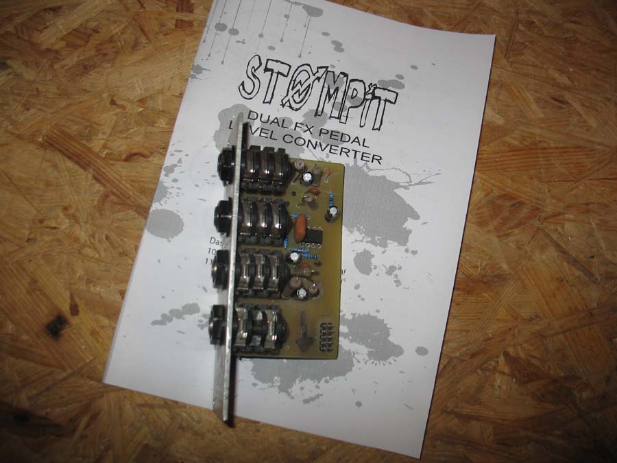

PostPosted: Sun Feb 07, 2010 5:07 pm    Post subject: Reply with quote  Mark this post and the followings unread
who would've thought that i actually would get something finished eventually maybe?
emerging from my pile of almost-ready-but-missing-one-component soon-to-be-not-just-electronic-junk-anymore-stuff i give you STOMPIT!
this is a dual ken stone stomp box adapter that a friend asked me to make for his doepfer system. lots of recycled components (check those HUGE resistors!) and my own pcb layout. frontpanel turned out not as good as i hoped - the darker spots are supposed to look like dripping spraypaint but do a poor job at it.
apart from that the thing works great. because i am such a good friend i even wrote him a manual Laughing

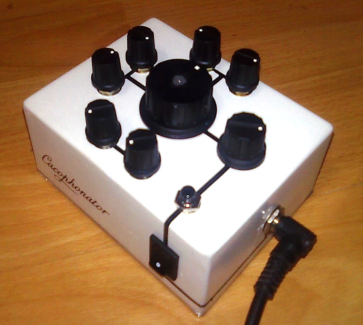

PostPosted: Thu Feb 11, 2010 10:55 am    Post subject: Reply with quote  Mark this post and the followings unread

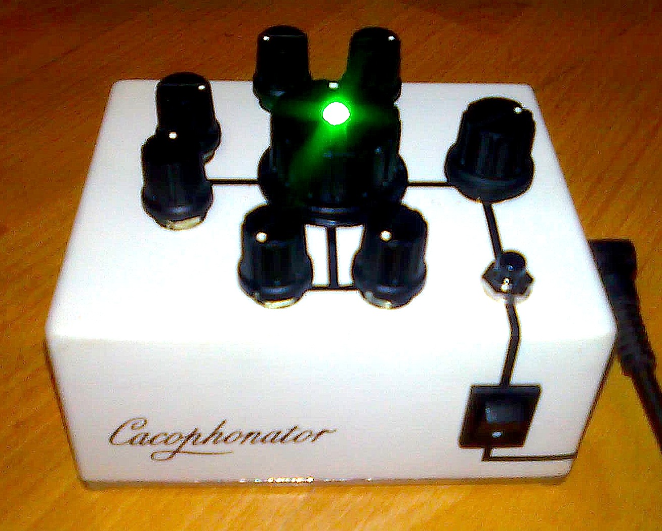

Completed moments ago, my first device for 2010: an Art Harrison 'Cocophonator'.
http://theremin.us/Circuit_Library/cacophonator.html
Built on stripboard with a RGB colour change LED mounted in the central pot.
Now to wake up the neighbourhood at 4.50AM! Twisted Evil
Apologies for the dodgy photos taken using a phone... I'll edit and post better ones when I get my hands on a camera.

PostPosted: Thu Feb 11, 2010 11:00 am    Post subject: Reply with quote  Mark this post and the followings unread
I really like the "LED knob" is that something you can get like that off the shelf, or did you modify the knob to accommodate the LED?
Cool build!

PostPosted: Thu Feb 11, 2010 11:38 am    Post subject: Reply with quote  Mark this post and the followings unread
No, I modified an existing knob. Cut a bit off the top off a spline shaft metric pot to accommodate the LED. Fed the plastic insulation off some wire onto the legs of the LED to insulate them, then slotted the LED legs into the slot cut into the pot shaft. Had to pry the slot open a bit to get the legs in! I drilled a hole in the top of the knob for the LED to poke through. Had to file the collar of the LED a bit to make it fit.
Under the pot knob, I drilled a hole into the box to feed the wires in. Would have been a lot easier had I mounted the LED off centre... like a pointer or something. Still, it wasn't impossible. The LED automatically changes from red to green to blue to purple to pink etc...

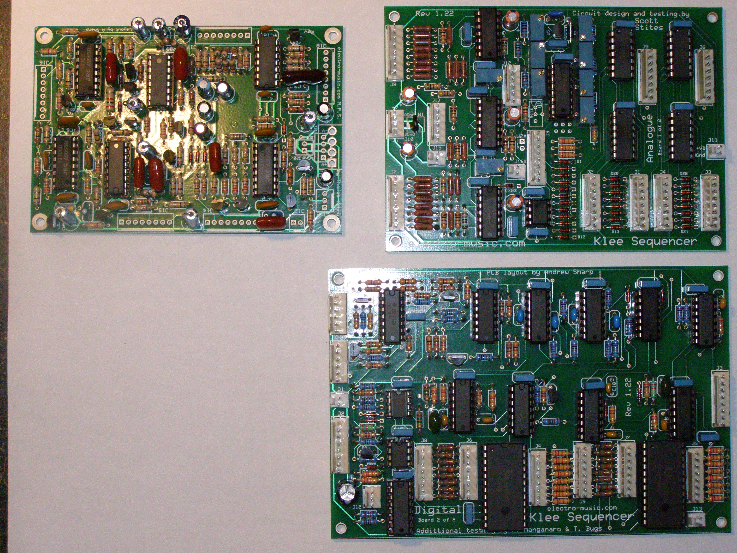

Just finished populating the Klee Sequencer boards and an MPS board.
I'm still working on the panel designs. Also begining to populate two MFOS Voltage Quantizers. Nothing to show for them except a bag of parts, though.

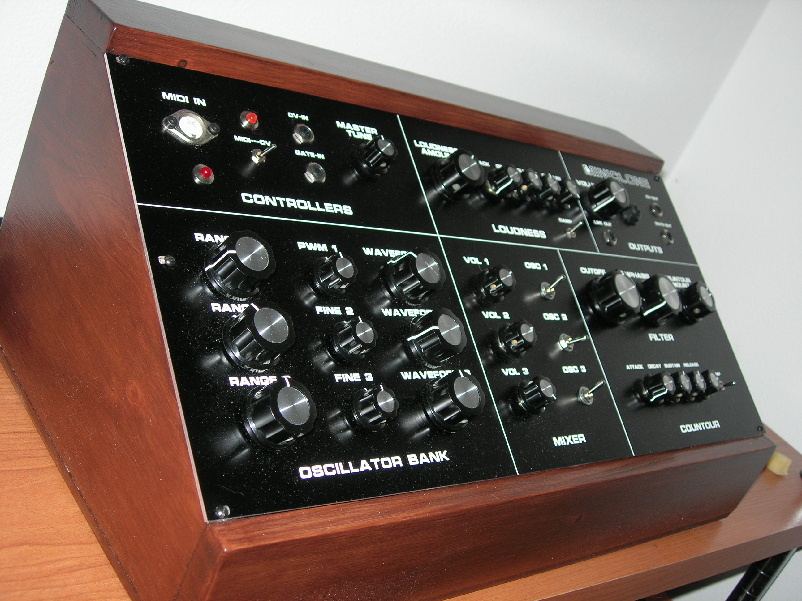

this is my productions
-korg ms10 desktop clone
-minimoog clone --- bassline version
-juno106 vcf and vca clone
 Filesize:  940.82 KB
 Viewed:  451 Time(s)

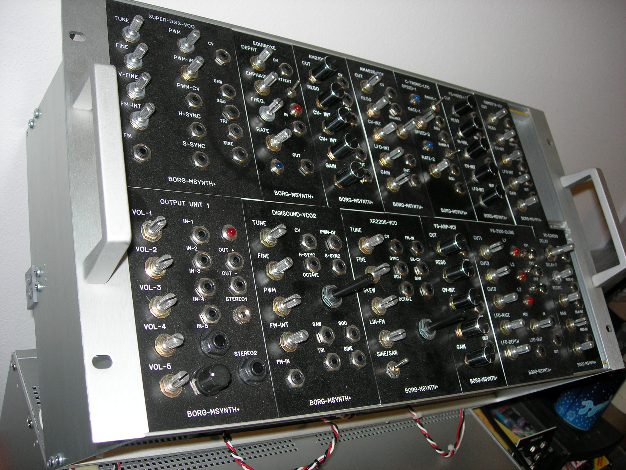

other pics of my minimoog clone and modular and my borg led eyes synth cat
 Filesize:  754.21 KB
 Viewed:  364 Time(s)
 Filesize:  925.75 KB
 Viewed:  360 Time(s)
 Filesize:  840.76 KB
 Viewed:  371 Time(s)
 Filesize:  847.78 KB
 Viewed:  341 Time(s)

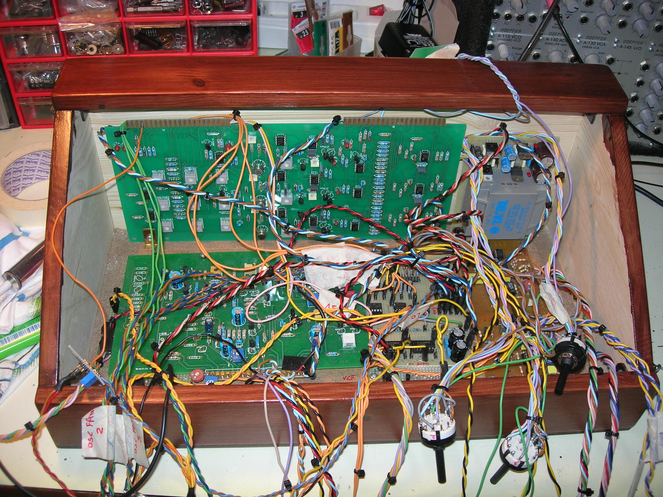

PostPosted: Mon Feb 22, 2010 4:04 am    Post subject: Reply with quote  Mark this post and the followings unread
yes, finally something to add to this thread.
3 lovely DS8 drum synth clones using the Marc Barielle PCBs
Edit: Spelling mistakes.

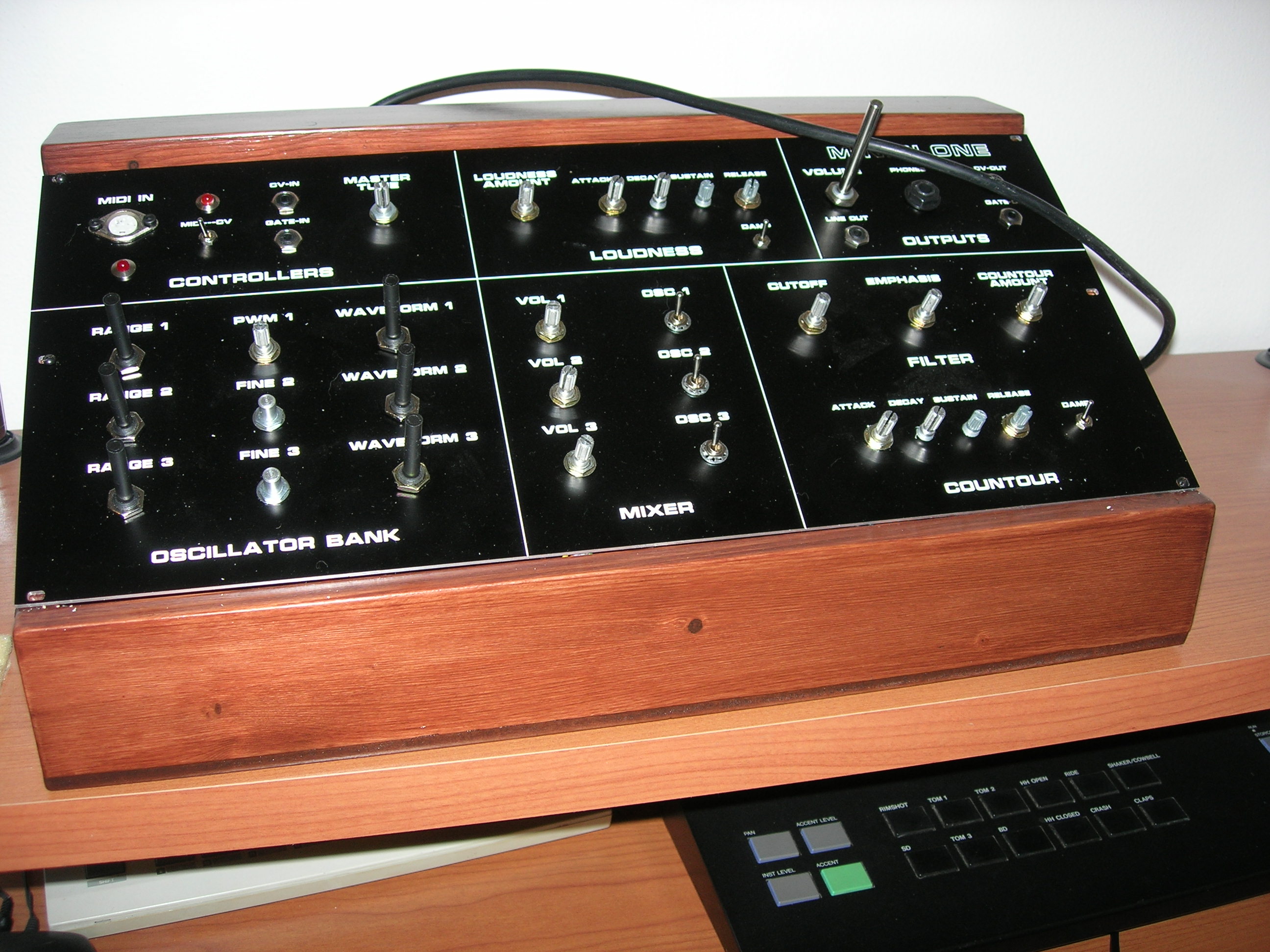

robotfunk
Joined: Jun 22, 2009
Posts: 20
PostPosted: Mon Feb 22, 2010 5:26 pm    Post subject: Reply with quote  Mark this post and the followings unread
that colour looks familiar Smile
I'm working on a Midibox Sequencer V4, and planning to do a proper case for it but since I had the bare guts working needed something to keep it into place unlike this:
so I made a temporary box like this Smile

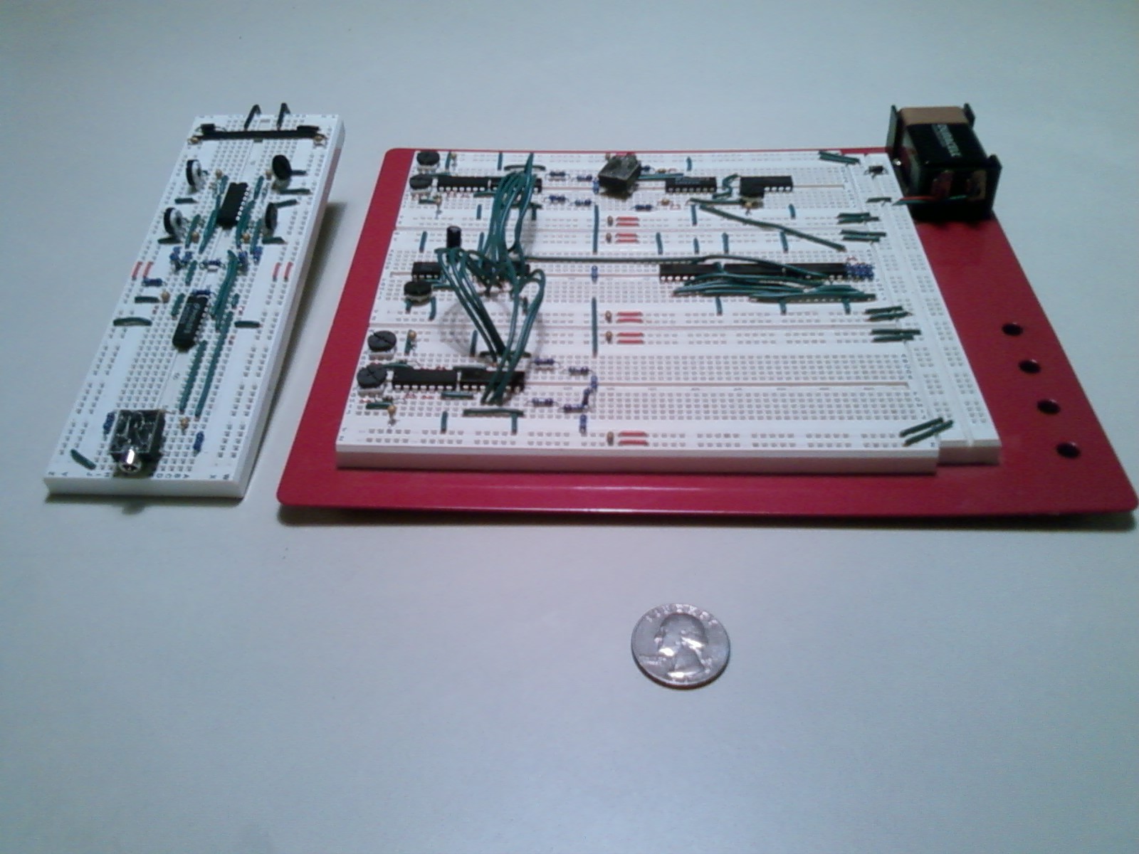

PostPosted: Mon Feb 22, 2010 6:52 pm    Post subject: Reply with quote  Mark this post and the followings unread
Do breadboards count? These are two projects for some electro-music radio shows that I've designed and constructed. On the left is the Quad Osc Lunetta, four square wave oscillators fed into an R2R ladder and buffered out to an 1/8" jack. On the right is a pair of Boolean Sequencer Lunetta circuits of different designs. Be sure to catch the Inventor's Inventions Shows if you have an interest in Lunetta circuits.
Les
The first two Lunetta Beginner's Projects
